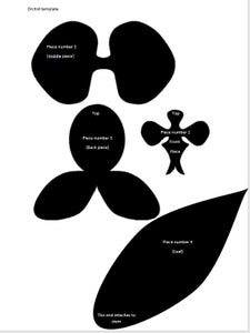

Step 1: Transfer Your Pattern
  1. Print out the template provided to the desired size and cut the pieces out - I cut mine out of thick plastic (Acetate) as I use the template a lot.
  2. Select your scrap metal and trace around the shape with a chalk pen (easy to rub off if you make a mistake)
  3. I marked a "T" for Top on my pieces also so I knew what way they were meant to go after I cut them out.
  4. I will do another instructable regarding attaching leaves which is also on your template.

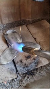

Step 5: (Optional) - Colouring Your Petals
  1. Again using the MAP torch I have heated Petal number 3 (back petal) to apply colour to the steel.
  2. Place the petal to be heat coloured onto concrete, some bricks or steel bench. ( we have a small forge that we use, what ever you put it on it needs to be non flammable and able to resist intense scorching heat.
  3. You need to be careful heating as the colour change happens quickly and as soon as it starts to turn a colour remove the heat then reheat to achieve desired colour. The colour changes go though a beautiful gold, purple to blue.
  4. Once you have achieved the colour you want, remove with a pair of pliers as this steel will be scorching hot, or leave to cool down before handling. (Please be aware that the steel will retain the heat for some time)
  5. The heat coloured steel is very easily scratched as the colour is just surface colour so be careful when handling for the next steps. You will notice that I predrilled the hole into this petal before I heat coloured so as not to scratch the surface.
