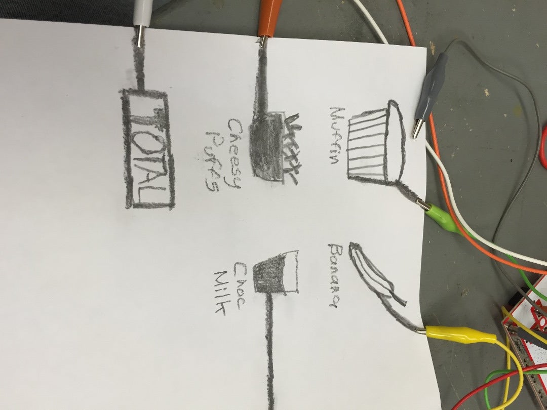

Step 4: Create Your Menu Drawing
Using your #2 or other graphite pencil, draw four different food items and a TOTAL sign on the 8 1/2 x 11 sheet of paper. Make sure that the drawing has lines placed close enough so that you will touch multiple pencil line when you touch the drawing. When you are done with your food items, draw a thick, heavy line from the food item to the edge of the paper. This will act as the connection back to the Makey Makey board.
Step 5: Connect the Menu to the Makey Makey and Test
Select five different color wires from the Makey Makey kit. Connect one end of wires to each of the four menu items and the "Total" button. Connect the other end of the food item wires to one of the arrow ports (up, down left or right) on the Makey Makey board. Connect the "total" key to the "space" connector on the Makey Makey board.
To test your touch menu, Hold the "earth" connection in one hand and touch the menu items with a finger on the other hand. You should see the appropriate green LED light up on the Makey Makey board. If you are not completing the circuit with your finger, try moistening your fingertip slightly to improve conductivity. l
