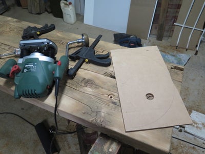

Step 5: Attaching the Base to the Seat.
I placed the base onto the seat, upside down to alighn where the legs will locate. I measured in from the edges to make sure it was perfect (perfect enough). One the legs were marked with tape, I calculated where I wanted the coach bolts to enter the legs.

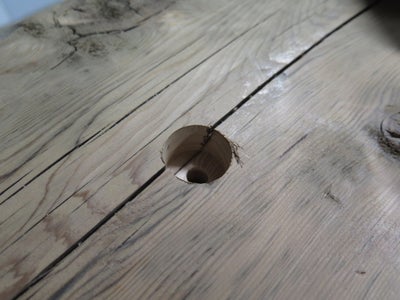

My plan was to drill a small hole from the bottom, through the entire plank, then countersink from the top surface down slighlty. This didnt go to plan as the Auger cant alight nicely in the existing hole. I had a plan with the router, and router template. The hole in the router template was drilled with a hole-saw and made a suitably sized hole. This worked out well and the holes were clean and crisp.
Once the holes looked good, and the bolt was able to sit sufficiently beneath the surface of the wood as well as extend sufficiently below the surface, the holes in the legs were marked. These were pre-drilled with a 5mm drillbit, to allow the bolt to bite into the wood, but not split the legs.
