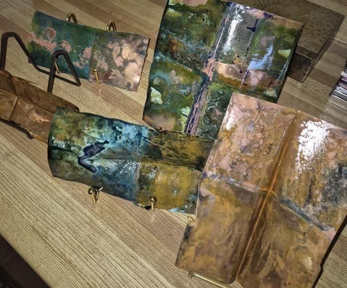

Step 2: Some Sheet Art With Two or Three Dyes Plus Caps and Metal Copper Steel Plate Dye Attempt.
When Methanol in my case is mixed with iron chloride and 5-SSA and pH 1, and Ph 14 the ph of 7 gives different combos of neat art too.
Here some data on Hats too. Pics on cap dyes too are Here.
I tried Normal color Indirect Plating but you need aluminum and dye plus sulfuric acid. A specific dye is also required but this dye would turn brown and would not work well even with electrolysis.
https://en.wikipedia.org/wiki/Anodizing#Dyeing
Take a cotton cap and add green tea extract. Then add Naphthol Red conc diluted by 1/4 with 5 drops Methylene blue. This alters the color slightly. Use other methods of dyes to get different colors. Oddly formaldehyde when remaining Iron chloride was added to Hexamine (Some) that cross-linked some cotton. It was well ventilated too.
