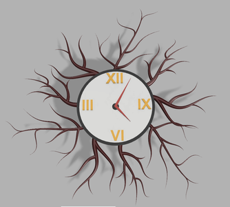

A while ago I started to play with Fusion 360 and ZBrush and organic shapes like LED flowers, voronoi patterns and kaiju (aka monsters). Few weeks ago I come up with idea of making wall clock with roots, that looks natural, organic.
In this Instructable I will how you step by step how to quickly create organic shapes in Fusion 360 and how to attach them to the clock.

Step 7: Your Organic Root Clock
Your clock is finished :D Above you can see two different versions of the clock, one with roots printed in grey plastic and the other with painted and re-shaped roots.
