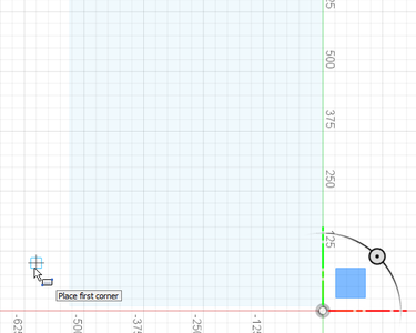

  1. Create a new Sketch in Fusion 360
  2. Add a rectangle with the inner size of the cabinet and add 2cm in width
  3. That means 44cm x 54cm in my case

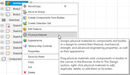

  1. Therefore right-click on the mesh/body/component and select "Physical material"
  2. Select the best fitting material and drag and drop it onto everything

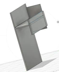

Since the vacuum cleaner takes up almost the entire floor of the cabinet, the space under the storage system has to be used intelligently.
My Idea was to put the second nozzle upright in the corner, which left just enough room to add a little drawer on top.
In the back must be just enough space for all the brooms.
The smaller vacuum can be wall mounted to the back of the cabinet.

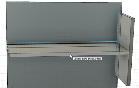

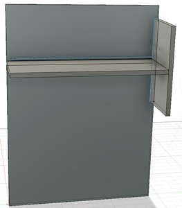

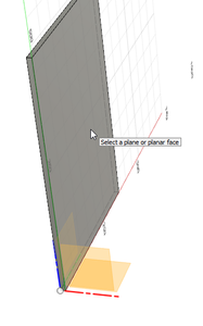

Step 6: Daw the Installation

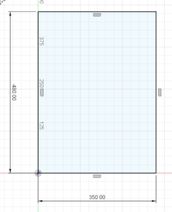

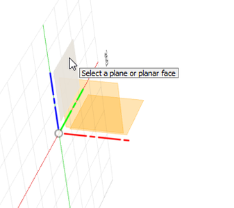

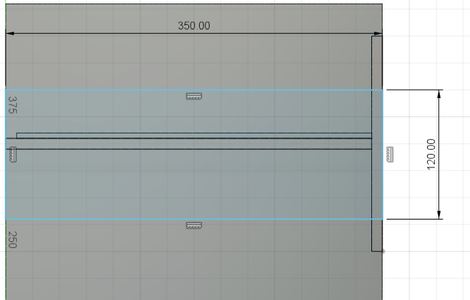

  1. begin with a new sketch, but this time on the Z/Y Plane
  2. Draw a rectangle in the size 48cm x 35cm
  3. Use Extrude to make it 3D with 10mm thickness

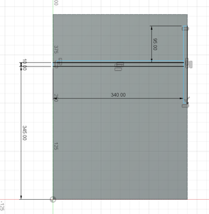

  4. Add another sketch onto the newly created body
  5. I added the lines for the drawer-pocket and for the crossboards
  6. First I extruded the drawer pocket 5mm into the Board

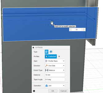

  7. Then the crossboards were extruded to 12cm.
  8. if you want the component to consist of individual parts, you have to change the Operation to "New Body" or "New Component"!
  9. Add another sketch onto the crossboards
  10. Draw the wall mounted plate with the drawer pocket
  11. Extrude plate, but make sure to select everything
  12. Extrude the drawer pocket from the other side
  13. Finish :-)

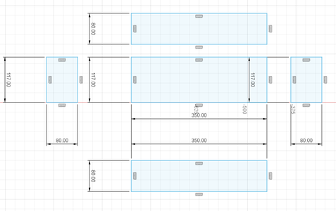

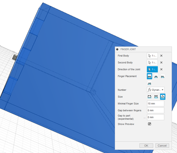

Step 7: Create the Drawer
To create the drawer I used the great Add On "FingerJoints" you can find here. It also features a great tutorial regarding the Usage.
To start, you got it, create a new sketch :-)

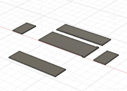

  1. In the new sketch, you have to create all sides at once
  2. add little "ears" to the bottom part to let the drawer glide in the pockets
  3. Extrude everything to 6mm (depending on the Material you have)

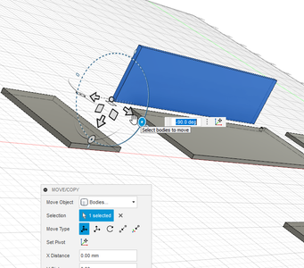

  4. Turn the parts as necessary

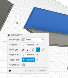

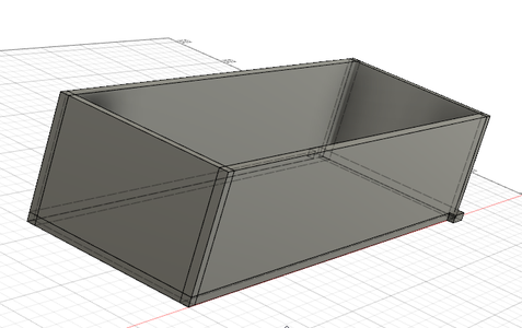

  5. Assemble the Box with move, "Point to Point"
  6. make sure that all the files overlap
  7. Now we can add the Finger Joints
  8. Start "Finger Joint" and select two parts to join
  9. Continue for all parts until you are finished
  10. Now you can insert the drawer
