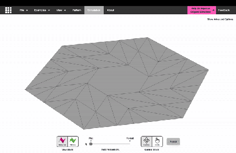

Bloom patterns are a new family of origami that can be symmetrically folded flat. This post is about one such pattern, the “Yoshimura 6.2 bloom pattern” that is easily foldable.
Bloom patterns can one day be used as flat-foldable punch bowls as well as disk-shaped deployable satellite arrays. Visit cmr.byu.edu to see how origami is applied to engineering.

The bloom pattern folds flat in one step, or all the folds must be made simultaneously. See this video:
