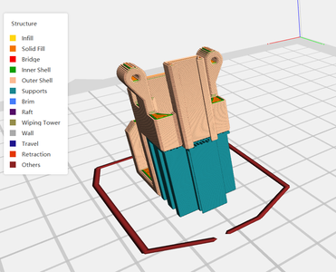

Print all parts. I used ELEGOO PLA+ filament. Please note that you need to print two copies of link.stl. The holder.stl only requires support. The sliced view of the holder.stl is as shown in the attached figure. Other 3d printing settings are as follows:
  1. Nozzle: 0.4 mm
  2. Layer height: 0.2 mm
  3. Shell count: 2
  4. Infill density: 15 %
10/18/2025: Updated holder model
