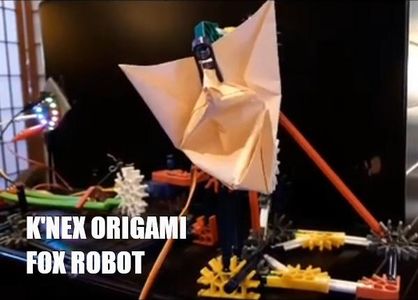

Introduction: Origami Fox Robot (a RTPlayground2 Project)
Using Reach and Teach's RTPlayground2 Inventor's Kit and a bit of K'nex, this is an easy project to put together. You can build the RTPlayground2 Inventor's Kit using the Computer Controlled Tinkering w/o Writing Code instructable or you can purchase an already assembled RTPlayground2 Inventor's Kit from Reach and Teach. The RTPlayground2 Inventor's Kit provides the pre-programmed Circuit Playground Express and K'nex servo assembly that you will need for this instructable.
In addition, you will need a 5-7/8" square piece of origami paper (any color), a potentiometer (adjustable resistor), and some miscellaneous wire and alligator clips. If you have a 288+ Tronex Science Center electronics kit or a Snap Circuits kit, you can use the potentiometer that is part of those kits.

Once you have folded the origami fox, tape two blue K'nex rods into the back of the puppet as shown. Use a K'nex clip to secure the upper blue K'nex rod to the top of the origami fox puppet.

Step 8: Install the Servo Assembly
The servo assembly is attached to the two supporting blue rods in the base.
Step 9: Install the Origami Fox Assembly
The two blue rods in the origami fox are installed as shown.
Step 10: Select Program 3 in the RTPlayground2
Select RTPlayground2 Pgm 3 and connect the servo as described in Steps 4 and 5 of the Computer Controlled Tinkering instructable. Pgm 3 reads a voltage on pad A1 of the Circuit Playground Express and accordingly moves a servo which is attached to pad A2. If you want to write your own code on an Arduino processor of your choice or a Raspberry Pi, you will want to control your servo to move between 0 and 90 degrees.
If you have a 288+ Tronex Science Center, you can now just connect up the on board potentiomenter/adjustable resistor (connecting Tronex pin 16 to ground, pin 17 to pad A1 , and pin 18 to 3.3V on the Circuit Playground Express). Otherwise, you can use pretty much any potentiometer you have with pad A1 connected to the middle potentiometer connector and the other connectors connected to Ground and 3.3V on the Circuit Playground Express
Step 11: Congratulations! Time to Play With Your Invention.
Moving the knob of the potentiometer/adjustable resistor should cause the origami fox's mouth to move. Moving the knob back and forth slowly should allow you to very finely control the fox's mouth position. Can you get it to say "Hello, World" and other phrases?
