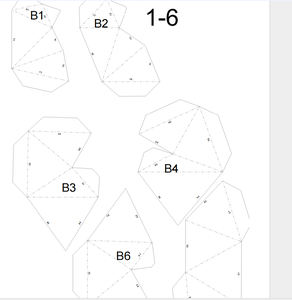

Step 1: Printing
First you have to print the 37 parts which are contains in 9 pages of A4 sizes paper in the attached file.
The picture attached in this step is one of the pages in the 9 pages of the PDF file attached in this step
Step 2: Assemble the Pieces
Second you have to cut the paper along the solid lines then fold the dashed line, use glue to connect the sides together to make a tetrahedron
*Notes*
  1. Remember that The Numbers with the Letter B in front is the number of the pieces (examples:B1 = the pieces with number 1 in the picture.)
  2. The sides with The number with the Letter B in front are the sides that will be glued to the floor (always).
  3. If you don't know which sides does the pieces connect then check from the picture or find the sides that has the same length as the pieces before the one that you are holding.
  4. Every pieces are Tetrahedron
