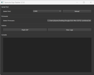

Flashing the ESP32 isnt quite as simple. The OGX-Mini firmware has a function to place itself into UART bridge mode, which in theory then allows you to flash the ESP32 via the Pico itself, which is an awesome feature however I could not get this working, I spent quite a bit of time with a breadboard setup and a working PCB but could not get it to flash, hence I had to include the ESP-BOOT button and ESP-PROG header to allow flashing the ESP32 via an external programmer.
To flash the ESP32, you will need to use the external programmer, set it to 3v via the jumper, connect GND to GND, TXD to TX and RXD to RX (dont worry technically they are crossed as they should be, just labelled to match!) between the programmer and the Dongle. Connect the programmer to your PC (ensuring all drivers are installed and its reporting a COM port), now hold the ESP-BOOT button then connect the MicroUSB to a power source/PC (only needs to provide power) then let go of the ESP-BOOT button, the ESP32 is now ready to be flashed. You can use the official method of Flash_Download_Tool, or my personal favourite: ESP Flasher (HERE) which can be used to flash the combined .bin file (not the individual files)
