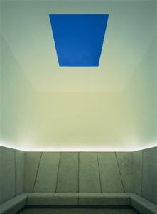

For the scene I created a building inspired by the Deer Shelter at the Yorkshire Sculpture Park in the UK. It’s a very abstract room with lots of concrete and has a large skylight in the roof – similar to the one in Nvidia’s animation.
1st image - this shows the scene without textures.
2nd image - this shows the deer shelter in the Yorkshire Sculpture Park. image from: https://www.artfund.org/supporting-museums/art-weve-helped-buy/artwork/9841/the-deer-shelter
