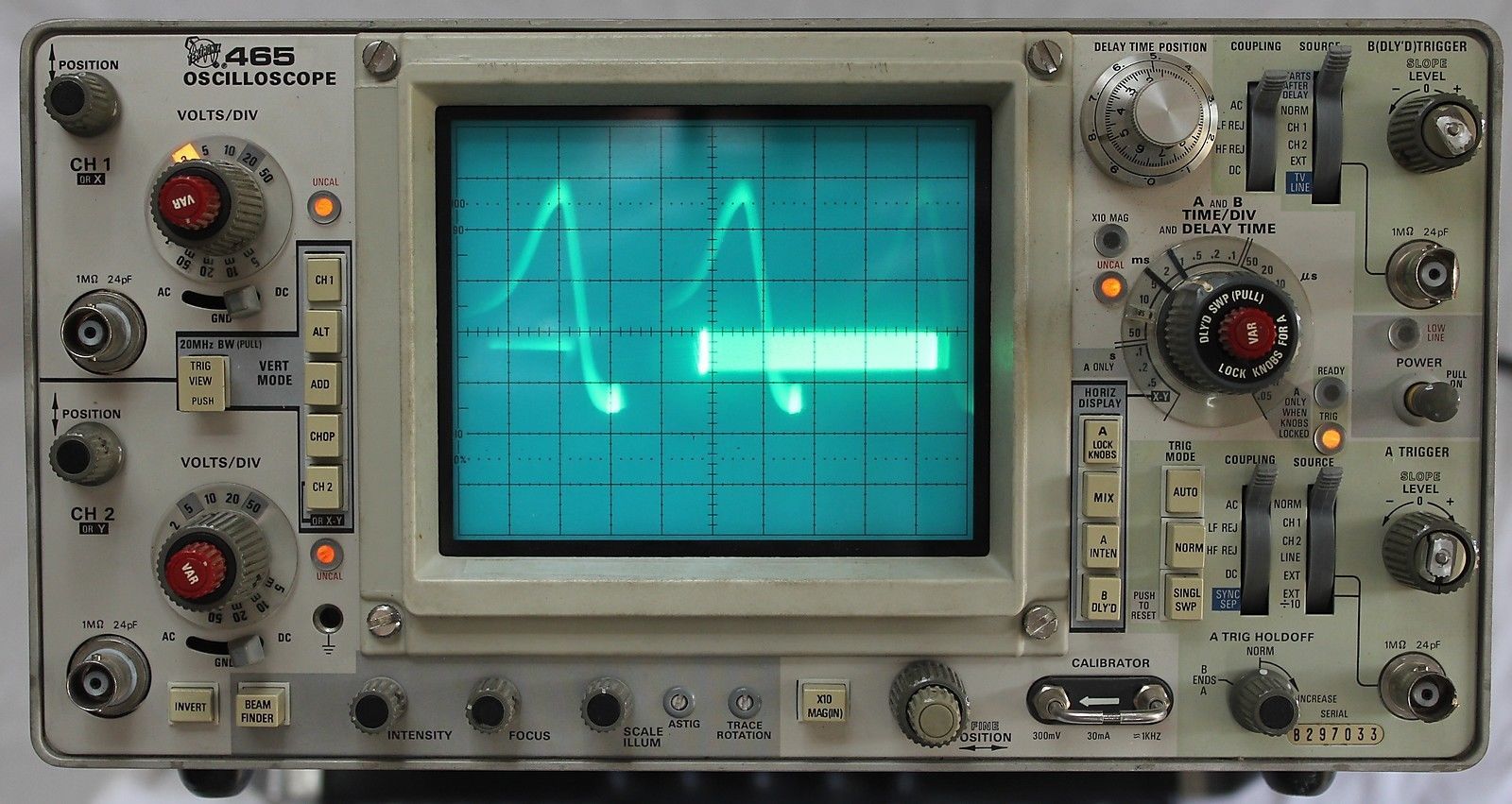

Step 1: Controls Overview
All oscilloscopes have some basic controls in common, be sure you can identify these controls on your oscilloscope:
- at least one input where an oscilloscope probe (also called a coaxial cable) can be attached (be sure you have one of these cables)
- screen with a grid overlay- this grid is useful when you want to make measurements using the scope
- volts/div- this control lets you change how many volts are represented by each vertical increment of grid overlay on the screen. Basically, it allows you to zoom in and out along the y axis.
- time/div- this control lets you change how much time is represented by each horizontal increment of the grid overlay on the screen. It allows you to zoom in and out along the x axis.
- vertical position/offset- lets you move up and down in the y direction
- horizontal position/offset- move left and right
- trigger level- this is a tool that allows you to stabilize your waveform on the screen, I'll get into the details later on in this tutorial

Step 2: Setup
Turn on your oscilloscope. If nothing is plugged into the oscilloscope you should to see a flat line, this means that the voltage of the input is not changing over time. If you see a line that is not flat, try disconnecting the probe from the oscilloscope. If the screen is blank try the following (remember all oscilloscopes are a little different, don't worry about pressing buttons if you're not sure, you won't break anything):
- my oscilloscope is a dual channel scope which means it has two inputs. As shown in figure 2, pressing the "channel 1" button causes that input to display on the screen in yellow. Pressing it again will cause it to disappear. Pressing channel 2 will display that input in blue. Your oscilloscope may only have one input (no channel buttons), or it may have more than 2. Analog scopes will not display separate channels as different colors, it's all green.
- you may be zoomed in tight on some blank space, try turning the volts/div knob counterclockwise to zoom out, also try turning the vertical position control until you get a flat line centered in your screen.
- make sure you scope is not in x y mode
Use the volts/div and vertical position controls to center your horizontal line in the screen and set the volts/div to ~1V and time/div to ~1ms to start.
