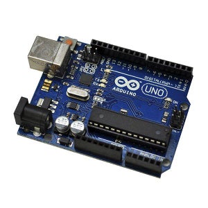

  • Arduino UNO

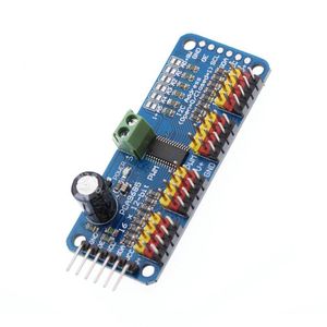

  • Servo driver PCA9685

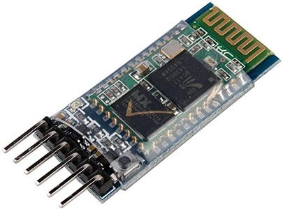

  • Hc-05 bluethooth module

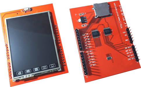

  • 2.4" TFT LCD Display Shield Touch Panel ILI9341

Step 2: Modify the TFT Shield
You have to modify the connection of a pin in the TFT module, it is necessary to disconnect the lcd_reset pin from the shield and make a bridge with a cable to the reset pin of the arduino, otherwise the screen will not be able to reset and the information will not be updated in LCD

Now you could upload the arduino code to both cards, but before uploading the final codes you must upload the test code to the arduino nano, be careful, you must upload the arduino nano code with the bluethoot module disconnected, otherwise an error will appear, after uploading the test code you have to assemble the shaft of the servos, the robot must be in this position with the code test, that is to calibrate the positions of the servos, the test code has the position "home" for the robot.

If the robot is already in the "home" position with the test code, then you can upload the final codes, the code for the Arduino Nano controls the servo motors with the help of the library for the PCA9685 driver, the Arduino UNO code controls the gestures performed with the display and the buzzer, the arduinos communicate via i2c protocol, the Nano receives the commands from an android application via bluethoot and sends data to the UNO to perform the corresponding gestures

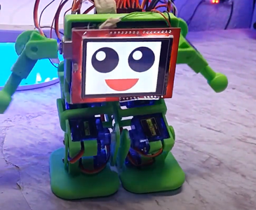

Step 8: Enjoy!
Now you have everything you need to build your Ottis robot, feel free to improve or customize it with the Fusion 360 Software, in the near future I plan to add more gestures, because there are still many sounds that I do not use and it is possible to draw a large number of figures on the TFT display
