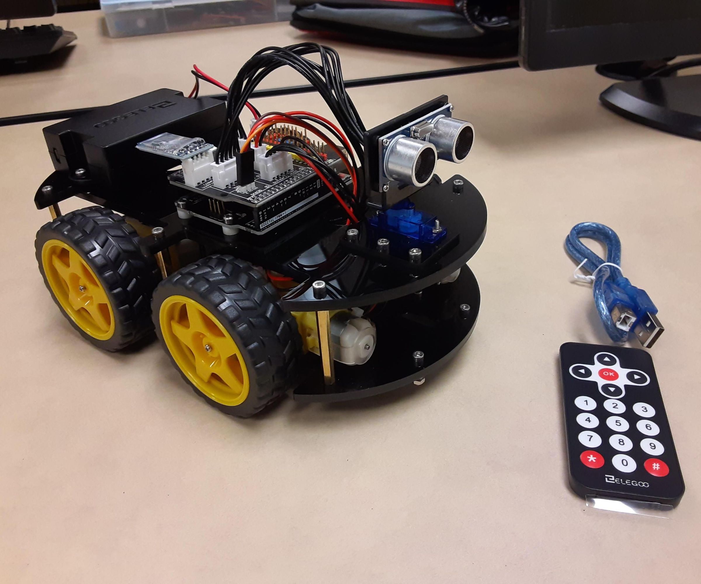

This is a simple project that just about anybody can do to create a simple walking robot.
For this particular build you will need:
*Ultrasonic Sensor
*1 3d printed case
*4 servos
*Arduino nano board
*speaker
*9v battery pack
*9v battery
*8 female wires
* usb mini b cord
*portable battery
*decorations
*loaded hot glue gun
*soldering iron
*4 small screws
*screwdriver
*electrical tape
*4 small washers
Step 1: Set Up/building
To start, you must first purchase the kit from: https://www.ottodiy.com/store/products/49452
Then follow the steps at: https://wikifactory.com/+OttoDIY/otto-diy
you may need to alter the casing to fir your parts so i used a soldering iron
Step 2: Edits and Fixing Wires
While you do not have to decorate it adding to the otherwise bland casing and add extra dimensions to the bot just be sure to counter balance the weight so that the robot is balanced.
if you over strip your wires you can twist both sets together and seal them so that the current can pass through.
the 9v battery or even the 4 double a batteries may not be enough so I opted to just use a portable battery to plug into the board directly
I also added scotch tape to the bottom of my bot's feet for more traction
cable management will be tricky so I recommend using electrical tape to seal the sets of wires connecting to each other and placing the speaker and button towards the outside then seal to bot once everything is in place just enough so it will stay in place especially if the case is not entirely structurally sound
