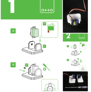

Step 3: Foot Servos Assembly
Put the micro servo inside feet and then push it inside, if is to hard maybe need to clean more the area with a cutter.
Is very important to check that the servo is able to rotate at least 90 degrees to each side.
After checking the movement use only the small screw to fix it.
Same process for the other foot.
Step 4: Fix Servo to Body
Take the other 2 micro servos put them in the defined locations in the 3D printed body and fix them only with the pointed screws.
Step 5: Fix Legs to Body
Connect the legs to the hub of the micro servo, important like the foot servos you must check the legs are able to rotate 90 degrees each side respect to the body.
After verifying the alignment fix them using the small screws to the hole inside the leg.
Step 6: Fixed Foot Leg
Taking care of the cables as showed in the illustration you should put the cables inside the slots of the body passing thought the hole of the legs.
Once they are in right position use the pointed screws to fix them from the back.

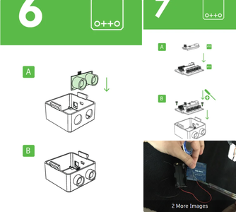

Step 7: Head Assembly
Start from the ultrasound sensor is important to pull out the eyes to the limit.
After putting the Arduino nano in the shield, optionally you can weld the battery holder positive cable to Vin in the board and negative to any GND.
Insert diagonally the both boards together facing the USB conector to the hole in the 3D printed head, then use the last 2 pointed screws to fix it.
Step 8:
Prepare the shield, cables and buzzer.
Then follow the diagram pins numbers and make sure to put them in the right position.

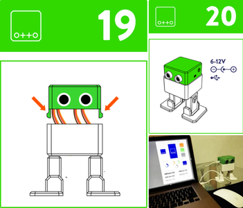

You have at least 4 option to power your Otto:
1. 4xAA alkaline batteries (1.5V each) that connected in series go to Vin pin and Gnd
2. 4xAA rechargeable batteries (1.2V each) that connected in series go to 5V pin and Gnd
3. Just directly from USB cable to your computer or even a power bank
4. External jack connector to use power adapters from 6V up to 12V output
Step 9: Snap the Head and Upload the Code
The head just snaps in, take care of the cables and close it.
