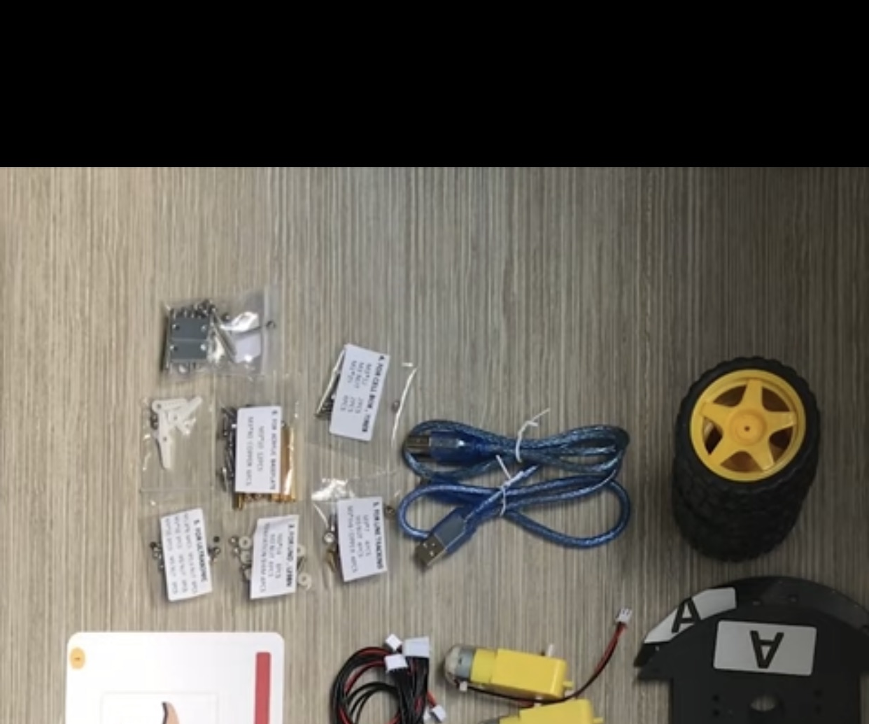

Introduction: Otto Robot
Nano ATmega328
Nano Shield I/O
Mini USB cable
HC-SR04
4 mini servo SG90
Small screws
5V Buzzer (if you have a battery pack with and on and off switch you dont need a switch)
Female - Female cable connectors
4 AA battery case
4 AA batteries
Small Magnetized screwdriver
3D print of the robot can be found at https://wikifactory.com/+OttoDIY/otto-diy/files/3Dprint
