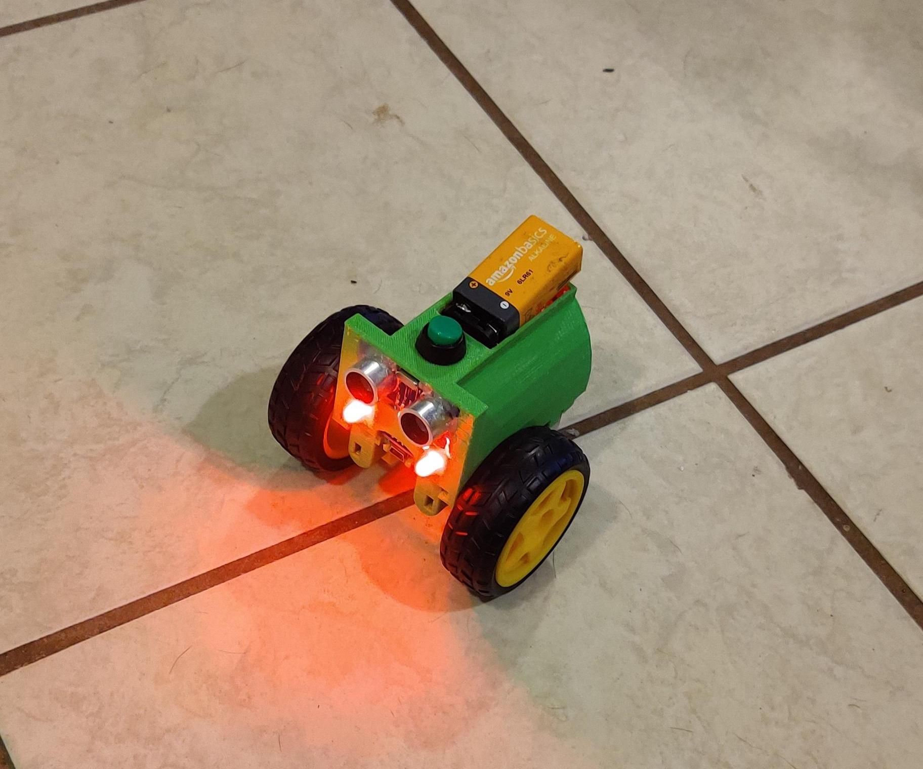

Hello, today I am going to show you the steps I took to build my own Otto robot. The supplies you need consist of a 3D printed otto robot. This can be purchased as part of a kit or just do a Google search to get free plans on how to print your own otto exoskeleton, if you do not buy a kit then the following supplies are also needed.

Attach power and on/off switch. I secured the battery pack with 3M tape and drilled a hole into otto to fit the on/off button. If you want to attach to PCB then just strip the wires and add 2 female dupont connectors as shown. The 9V battery I used did not want to work with the robot so I had to use usb to power otto.

Insert the arduino nano attached to the PCB inside the top part of the robot and secure with 2 tapered screws (4 wouldn't hurt but I ran out of screws). I would place the eye sensors in first before inserting the PCB.

Once the code is successfully uploaded then you robot is ready to go, just add you own personal touches to him and release him into the world. After looking at my robot, the top hat speaker made me think of Abraham Lincoln so I added some weatherstripping beard goodness. After noticing how his walk resembled a moonwalk I knew what I wanted to name him and voila, Ottoham Slinkon was born.
