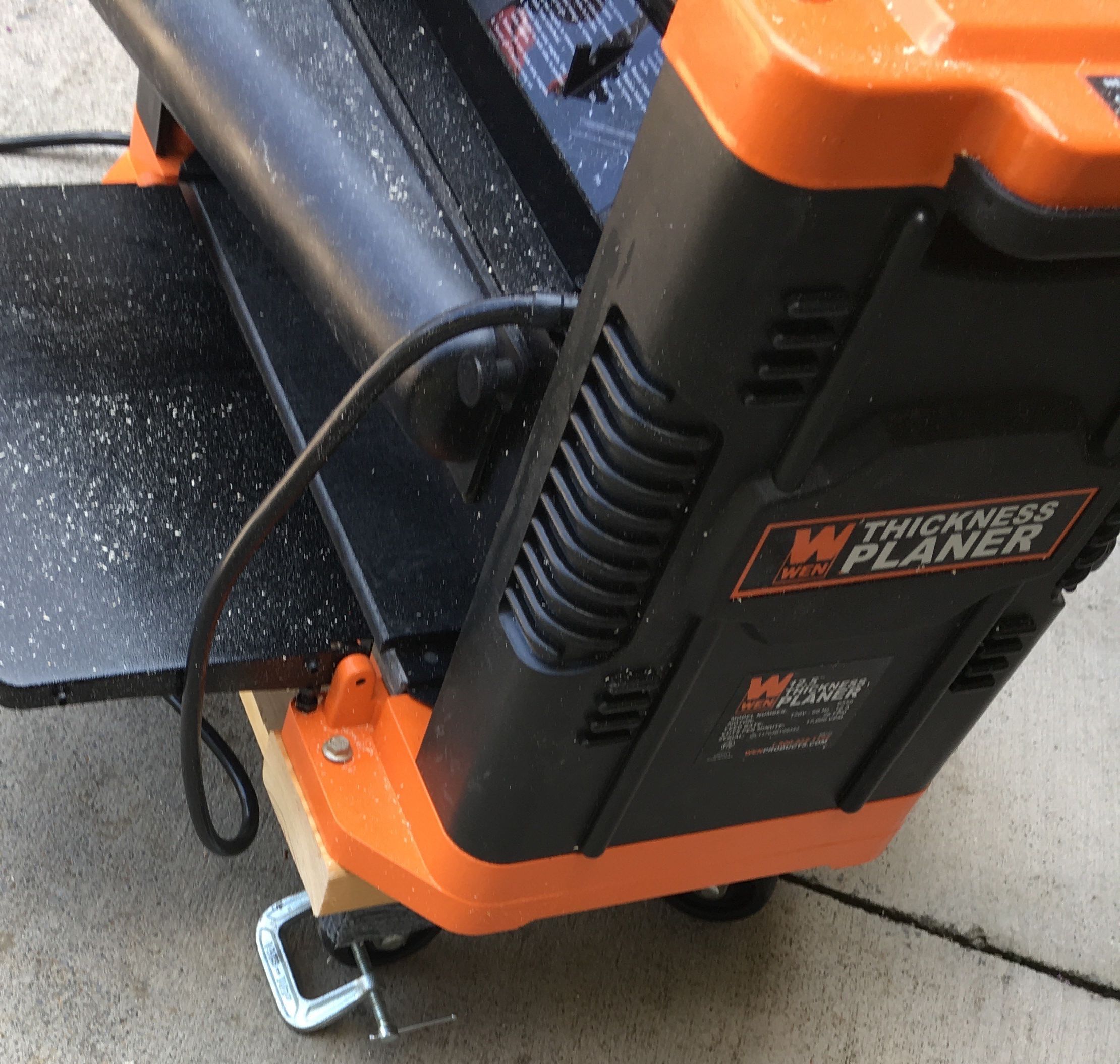

I started with two 2x4x8 pieces. I wanted the ottoman to be 3x4'. I cut the 4' lengths first by halving the 2x4 then evening them with a second cut creating two pieces slightly shorter than 4'. I repeated the process to make the two 3' pieces. Then using the table saw I cut a 1/16" off of each of the sides to square the sides. Using a planer all 4 sides of each board were planed. I placed the 3' sections inside the 4' sections. Then using 3/8" dowels with one at each corner and nails I connected the pieces with butt joints. Finally I cut several left over pieces of wood with 45 degree angles at each end and attached the pieces with screws to brace it. I then used the left over scraps from the first 45 degree cuts to brace the corners and attached them with glue and nails. I also added another another ~4' 2x4 for additional support in the center once finished.
