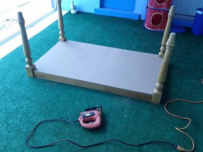

the table had an old tile top I hated it.
I thought I could bang it off the wood with the tile but it wrecked the whole table and I had to make a new top frame for it.. you can see it all in one piece standing up that whole thing I trashed.

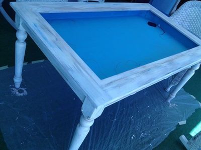

made a new top frame out of cheap pine
and added in a bottom so now the top part of the table is like a box
I colored the inside beach sky blue
and out side i painted it like scratched up rugged used wood
I then used polyurethane to protect it all
THEN at the bottom on the box inside I added in some plastic. incase the sand would be damp or get damp and wouldnt warp the bottom part .
and drilled in a small hole in one corner for the battery operated lights.

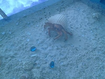

I got play sand and some shells and added in against the blue inside

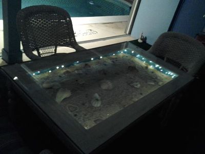

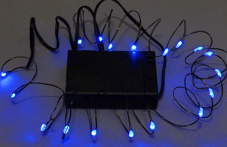

the lights blink or just stay on or fade in fade out.
they were cheap lights about 3 bucks at walmart and they are on a wire thin looking uses 3 double A batteries.
I wanted to give an illusion of a starry night.

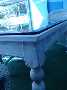

also added thin wood trim along the edges to give detail and rounded tack nails on the end corners for more detail.
I also added in the glass that was jagged but not sharp shinny sparkly looking and mixed it in with the sand it looked natural looking. I also added in under the table support beams to protect incase the sand was too heavy

one more thing I added in these small blocks of plastic to separate from the wood frame and the glass
this was a bad idea later from it being so heavy and the heat out side it began to melt...
