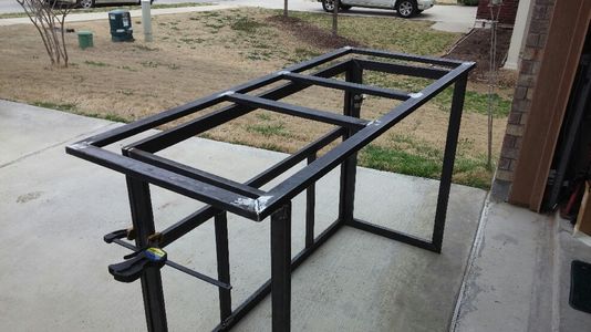

Step 1: Cutting the Frame
First, I took the 12 foot bar and set it up on the horizontal band saw to cut my steel frame pieces (Total of 6 pieces).
I set the band saw to a 45% angle and clipped the beginning of the tubing.
From there, I flipped the bar (to reverse the angle). I measured 68" from the furthest edge and cut it.
I repeated this one more time to make the 2 wide pieces of the perimeter frame.
I then made 2-28" bars with 45% angles to finish off the outside perimeter rectangle of the frame.
From there, I got creative and decided that I wanted to put cross beams in the middle to split up the tile surface that I was planning on putting down.
The 2 cross pieces I cut were flat ended 24" bars to fall in the inner dimensions of the 28" sides.
Step 2: Lining Up and Welding Frame
Once all the bars were cut, I cleaned up the oily steel tubing with some degreaser and then took them to the welding table.
Each bar I squared off, clamped down, and then tacked my welds
From there (after I re-checked each square), I finalized the welds.
