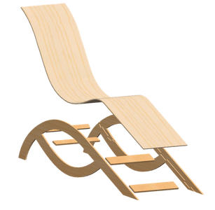

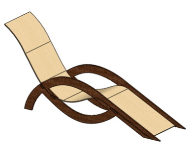

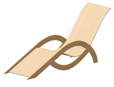

Step 1: Make You Design on CAD
I made made designs using solidworks. I created a simple shape for the frame and added a curved surface for the back rest. For durability i added extra support frames beneath the chair. Once you are happy with the design, then you are ready to transport the file to a CNC machine

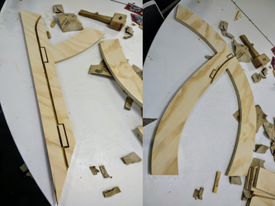

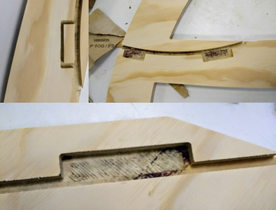

Step 2: Cut the Frame Peices

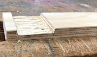

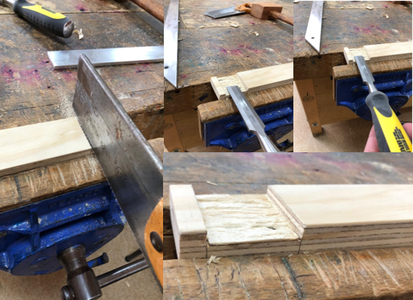

Once the machine has finished cutting the frame you can remove them from the compartment. The above pictures shows how I removed the extra wood, I used a file to remove the slot pieces

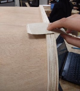

Step 3: Refine Edges

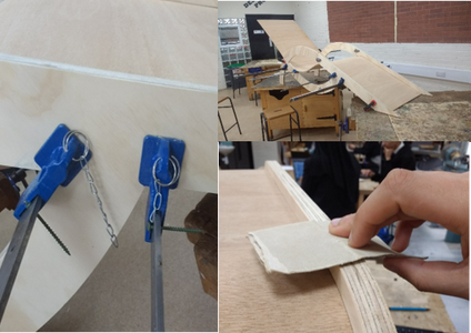

I used sand paper to remove sharp edges and make the surfaces even

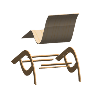

Step 4: Attach the Frames

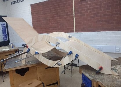

I used 2 clamps to ensure the wooden pieces don't move. Then i collected some clamps from the local DIY store and used a screwdriver to insert screws into the wood. Once this was done the wooden legs were one piece and stable.

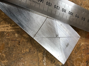

Step 5: Add Metal Back Rest Support

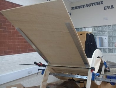

I got some aluminium strips and cut them so they can fit the edges of the back blank. I get a drill and made a hole in the top center. To ensure it was the middle i used guides and made a mark on where to cut.

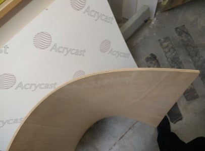

Step 6:
This was the eighth process, this was when I was cutting the flexi plywood in shape so it can fit the chair. I first measured the flexi plywood then cut it to my specification and then started to fold it in the areas where it can fit. The process was very tricky and confusing at first but I finished it.

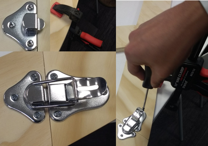

Then i done the joint stage. I needed to add holes in the metal so they can be screwed into the chair. I then used a metal wool to make the edges smooth. To make the holes I used a drill and made holes in them.

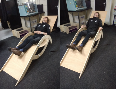

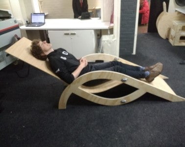

Step 9: Now Enjoy Relaxing in Your Garden
You can place the chair in the garden and relax in the sun!
