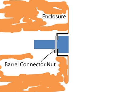

The final thing to do with the electronics is to attach a barrel jack connector. I found out the hard way my power supply had a 2.1 mm connector when none of my barrel connectors fit. So do yourself a favor and check the datasheet before you order or order the correct connectors. After installing the barrel jack find a good place for the temperature sensor where it will be able to correctly sense the outside air. After everything is wired and LEDs glued in screw the two parts together and added some silicon caulking to improve the water resistance.
