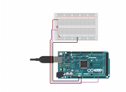

The idea is to be able to turn off outdoor lights automatically without having a switch at all.I used a light dependent resistor to detect the amount of light in the atmosphere which in turn will allow the bulb to turn on or off .

Step 1: Connections
The connections can be seen on the diagrams above.The ldr sensor has a 10K resistor connected to it .
The RBD sensor has four pins : voltage , ground ,zero cross and psm.The voltage pin is connected to the 5V on the arduino mega while ground is connected to the ground port in the arduino mega .The zero triac is connected to the digital pin to control the phase null of AC while the psm also connected to the digital pins is used to control current .
On the other side of the RBD dimmer ,the sensor is connected to the load and the other one is connected to the AC IN
