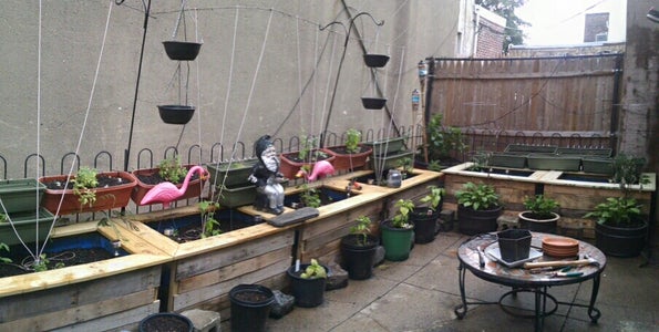

Step 5: Add Pallet Wood As Facade
Tear apart some pallets and get screwing. For my yard I only did the outside facing front. I like to be able to clean underneath with a hose. Feel free to stain, paint, or polyurethane your wood.

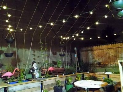

Step 6: Plant and Decorate (LEDs, Gnomes, and Flamingos!)
Get it green! Run some ropes up to the roof for hops, add string lights, pour some beer and wine, and enjoy your yard.
