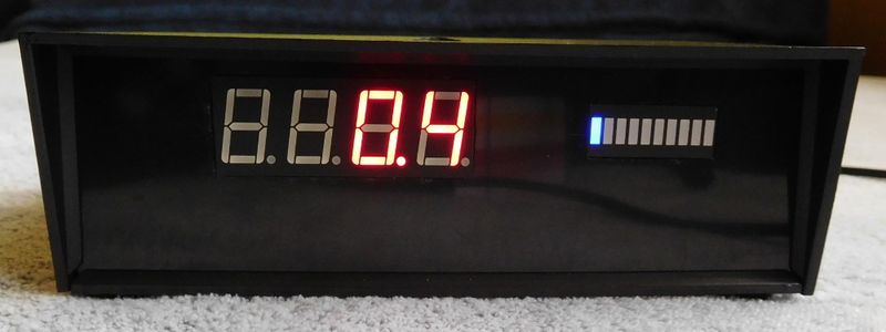

Measured temperature in °C is shown on 7-segment display. Temperature level is shown on bar graph. According to ambient light is set brightness level of displays. Main Arduino also process reactions to button press.

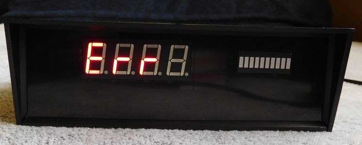

After power up the thermometer begin with initialization (show INIT, turn on all segments, show brightnes mode (the day/the night, show brightness level (for example 500), show type of active sensor). Then go to the run mode and show measured temperature.
If isn't connected connected sensor then is shown error.

Bar graph show level of the temperature. Blue - temperature around 0°C, Green color - good temperature, orange color - bad temperature, red color - the worst temperature.
