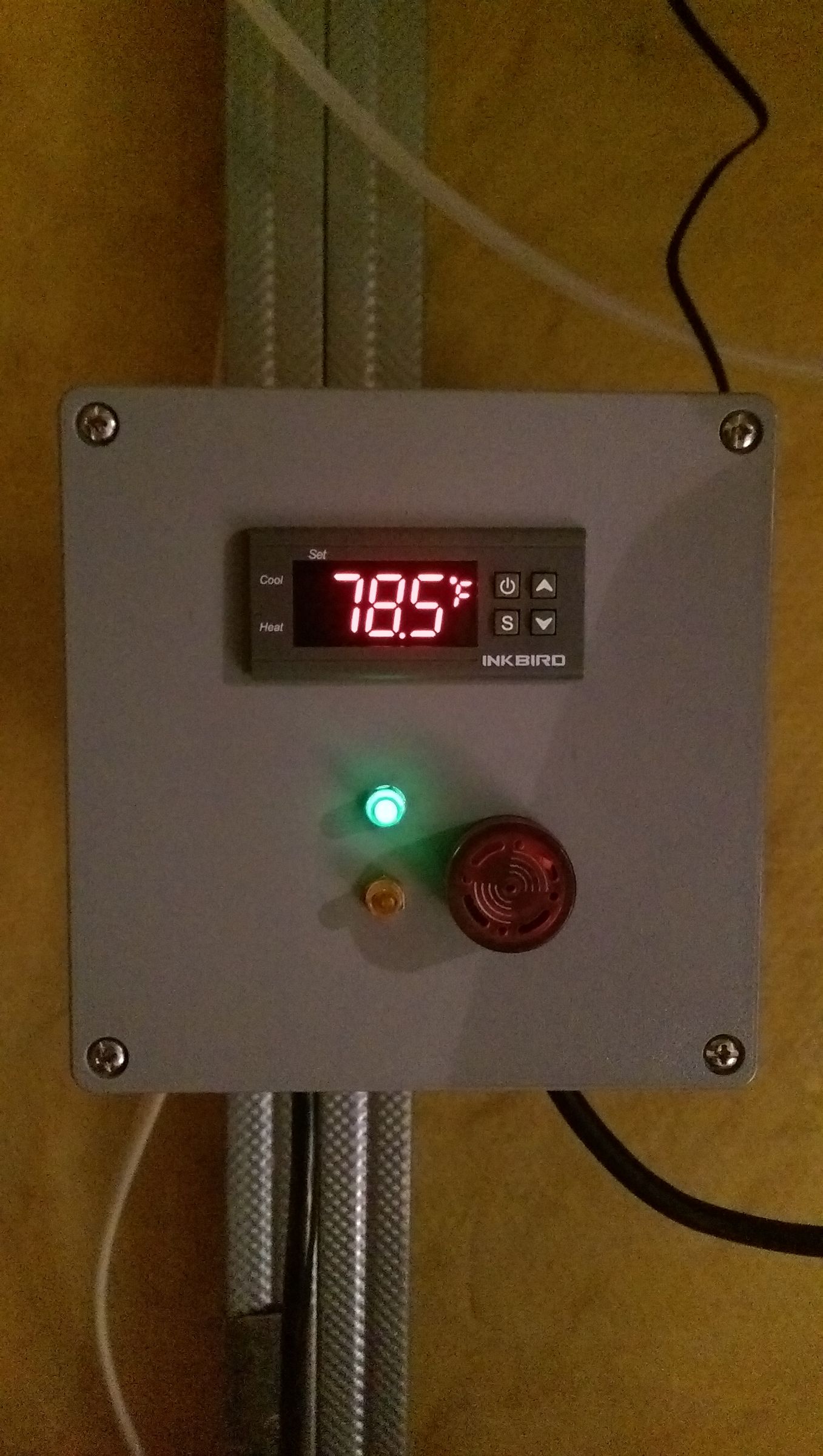

Understand this isn't dangerous as long as you don't ever work on anything with the power on, never assume it's off. Always make sure live wires are covered and not short circuiting when flipped back on and everything will be fine. I got really tired of tangled up cords and power strips. Power strips are also very dangerous and the way I use to have mine wasn't a good idea as you can see in the picture. So I decided I'd make something a bit safer and never plug and unplug a piece of my equipment ever again.

Put labels on it if you'd like. My stand is nice and clean, every cord has a drip loop. I can walk by to feed them hit the switch on the power heads and feed them and turn it back on. I hope you enjoy and I hope whatever design you choose works! Send a message for anything you need.
