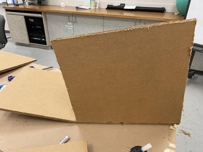

Step 2:
Cut 2 support pieces at desired angle
Use metal spoon to crease main panel piece in half
Step 3:

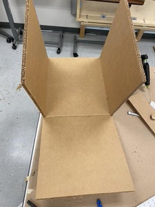

Glue 2 support panels to main panel with the angle side up using hot glue
Let panels dry for 5 minutes

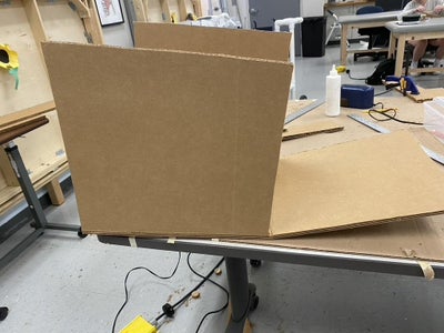

Step 4:
Fold and glue together top side of main panel to the angled side of support panels with white glue
Nail in 4 wooden dowels to increase sturdiness

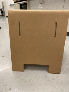

Step 5:
Cut a slit in bottom of main panel to desired width and height of feet
Cut 2 slits 1/4" wide for straps to rest in

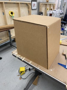

Cut out panel to close off back of frame
  • 16" x 20"
Glue and use 4 wooden dowels to secure back of frame

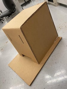

Step 8:
Secure frame on support board using white glue
Step 9:
Edge frame using edging tape
Prime, paint and polyurethane for maximum durability
