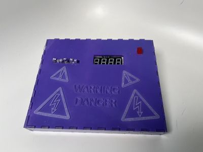

It is designed to match the stainless steel aesthetic many kitchen appliances have in order to fit in within the space. It has symbols etched onto the front for understanding as well as a hook attached there so it can fit on the handle of your oven.

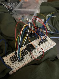

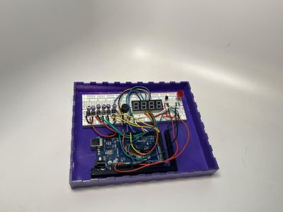

Iteration 1:
  • Arduino Mega
  • Breadboard
  • Jumper Wires
  • 4 Digit Segment Display
  • LED
  • 1K Ohm Resistor
  • Buttons
  • Buzzer
  • Heat Sensor

Step 1: Doing First Iteration

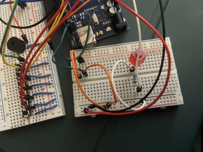

  1. First thing I did was make the timer with buzzer via this link
  2. Once I got the timer working I added the LED to flash when the timer was done

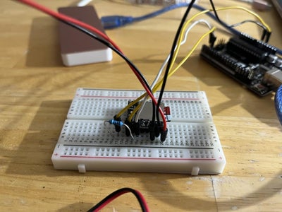

  3. With the LED, was the heat sensor. The LED would light up when the heart sensor found a temperature greater than the set heat variable.

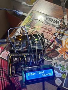

Step 5: Second Iteration – Timer
After the Neopixels I started on getting the on the timer:
  • After a lot of struggling related to connecting the remote to the segment displaus, I found this resource for a remote controlled timer where I adjusted it to get rid of the LED and second potentiometer controls.
  • I got the timer working for setting second with the remote. I set my own choice of buttons on the remote to certain controls like start, numbers, and reset. The reset button would only work once on the times up screen and if you put in wrong number on the start screen. Due to code complications I was not able to make it so you could reset while the timer was going.
  • The timer source came with the buzzer so I connected that to my board.

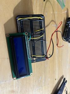

Step 7: Second Iteration – Soldering
The next step I did was taking all my circuit pieces and solder them onto a protoboard:
  • I did all of my wires and additional pieces like LCD, heat sensor, buzzer, etc.
  • Once soldered, the only the not working was the LCD, so I went through every connection with a multimeter and found one of the display pins was not fully attached to the protoboard so I re-sodlered it and it all worked.
