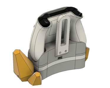

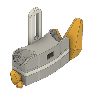

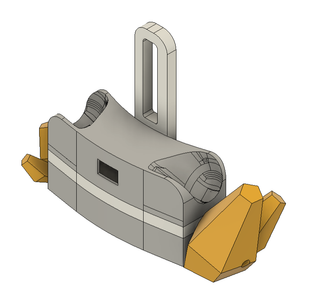

Step 1: DESIGN

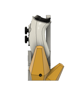

Our initial task was to design this project, which was made possible by a 3D model of the Xbox Controller.
The controller would be held up by its two handles on a base that would house an RGB driver PCB, according to my design.
In order to create the controller holder in the main holder body, we first chose the XBOX controller's face and selected the surface of the holder using the offset tool in the surface environment. Next, we create a holder body using the thicken command that is precisely the right size for supporting the controller from both handles.
We modeled the center section around the newly constructed holder body, and the result is a beautiful base that houses the circuit in the center, the battery at the bottom, and the Xbox Controller at the top.
The end product is a nice base that holds the Xbox controller at the top, the battery at the bottom, and the circuit in the center. We designed the center section around the newly built holder body.

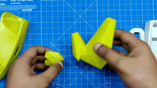

At last, we added a stand on the back side of the main holder body to add extra protection for keeping the XBOX Controller in its place.

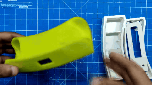

After the model was complete, we exported the mesh files and used a 0.4mm nozzle with 20% infill to 3D print it in white and glass yellow PLA.

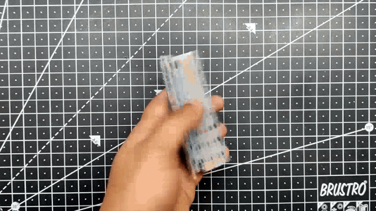

After finalizing the PCB and generating its Gerber data, I sent it to SEEED Studio for samples.
The PCB was ordered in a white solder mask with black silkscreen.
PCBs were received in a week, and their quality was super good considering the rate, which was also pretty low.

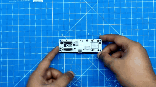

Next is the PCB assembly process.

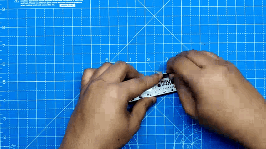

Step 4: PCB Assembly Process
- Using a solder paste dispensing needle, we first add solder paste to each component pad individually to begin the PCB assembly process. In this instance, we are using standard 37/63 solder paste.
- Next, we pick and place all the SMD components in their places on the PCB using an ESD tweezer.
- With extreme caution, we lifted the complete circuit board and placed it on the SMT hotplate, which increases the PCB's temperature to the point at which the solder paste melts and all of the components are connected to their pads.
- Next, we add all the THT components, which include the header pin, JST CON, and USB Micro Port, to their locations and then solder their pads using a soldering iron.

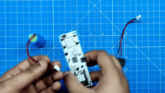

Step 5: TESTING PROCESS

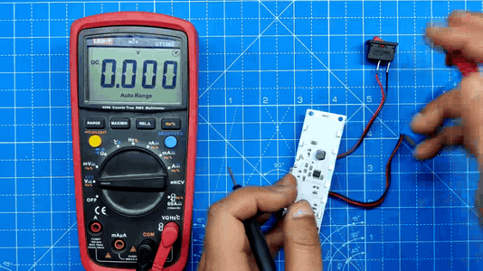

- Following PCB assembly, we connected the JST wire of the lithium cell to the JST connector on the circuit board and then connected the JST wire of the switch to the JST connector on the circuit board.
- To confirm if the power management system is functioning, we flip the switch and use a multimeter to measure the output voltage of the IP5306, which is 5V.

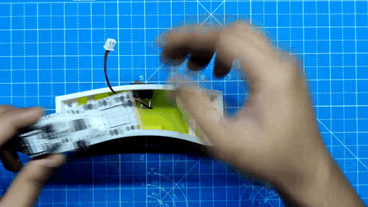

Step 7: Main Assembly

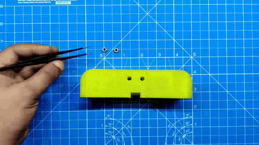

- First, we inserted two M3 screw inserts into the rear side of the main body to begin the major assembly procedure.

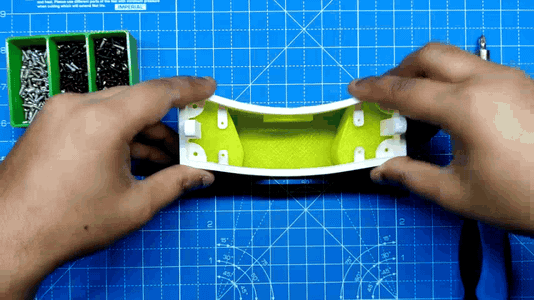

- Next, we used four M2 screws to attach the center portion of the main body to the upper part.
- After that, we positioned the switch on top of the main body from the front..
- Next, we reconnect the JST wire harness with the JST connector on the circuit and place the circuit into the middle section. We then secure the circuit in its place using four M2 screws.
- After that, we secured the assembly and added the battery JST connector to the circuit.
- The model was designed so that, in order to keep everything in the correct position, we would only need one screw from each side to hold the top, bottom, middle portion, and geode together.
- We tighten the M2 screw from both the left and right sides of the middle body.
- Finally, we use two M3 bolts to attach the back support section to the back of the middle body.

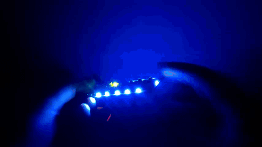

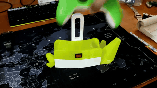

Step 8: RESULT

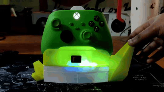

After the tedious build, here's the result so far.
The best thing is that we used the same surface offset as the controller's handle, so it fits precisely in the holder and keeps the controller from falling out of place. This gives the Xbox controller stand an entirely unique appearance.
All we need to do is press the button on the front to turn on the RGB lights.
A few things still need to be worked on in the upcoming version: the circle requires more LEDs because they are producing fewer lumens, and we should reprint the central section of the light source using transparent PLA in Version 2.
