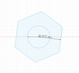

Step 9: Sketch Nut
  1. Create a center diameter circle 10mm next to the tee.
  2. Click create then polygon circumscribed polygon start in the center then enter 10mm.
  3. Finish sketch.

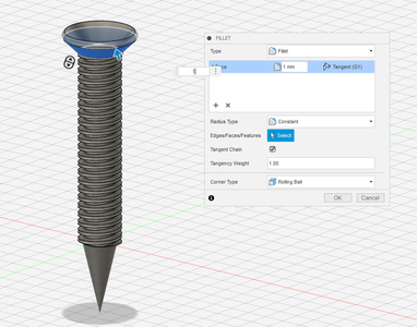

Step 12: Fillet and Chamfer
  1. Add a 1mm chamfer to the nut.
  2. Add a 1mm fillet to tee
