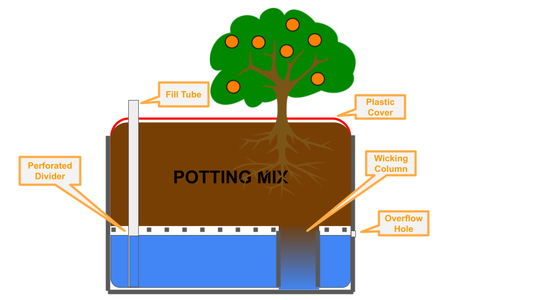

Principles of Operation
  • Potting mix is on top, water is on the bottom
  • Perforated divider provides aeration to the roots
  • Water is steadily wicked up by capillary action via wicking columns
  • Overflow hole prevents over-watering
  • Plastic cover prevents soil evaporation, weeds and excess rainwater

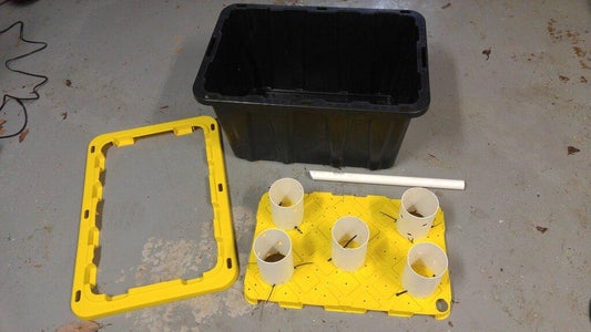

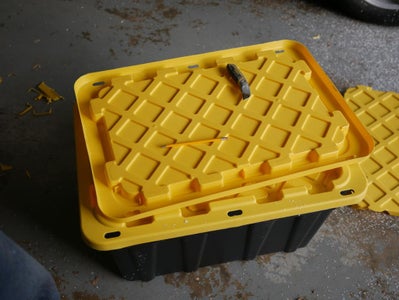

  1. Container
  2. Any container of the right size that is strong enough to handle the weight and pressure. I'm using a 27 Gallon HDX container which is about as deep as capillary action allows (about 10 inches of potting mix). Lid is used as the divider.
  3. PVC (4").
  4. Used to support the divider. About 3 feet is needed (It's usually sold in 10 foot lengths). I use the perforated kind, fewer holes to drill (and more aeration).
  5. PVC (1.25")
  6. For the fill tube. Less than 2 feet needed
  7. PVC Union (1.25")
  8. To make a mosquito-resistant breather cap. If you cut it in half, you can make two.
  9. Weedblock/Lanscaping Fabric
  10. To keep potting mix from falling through gaps and holes. 4' width is a perfect fit, but you can overlap smaller pieces if you have to.
  11. Screen material
  12. To keep mosquitoes out of the holes. I'm using aluminum, but any outdoor screen will work.
  13. Plastic Sheeting
  14. To cover the top. I'm using "red plastic mulch", but anything will work.
  15. Potting Mix (not soil!)
  16. I used about 80 quarts of potting mix (two bags of Kellog's Organic).

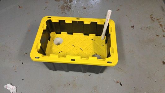

Step 1: Cutting Things Up

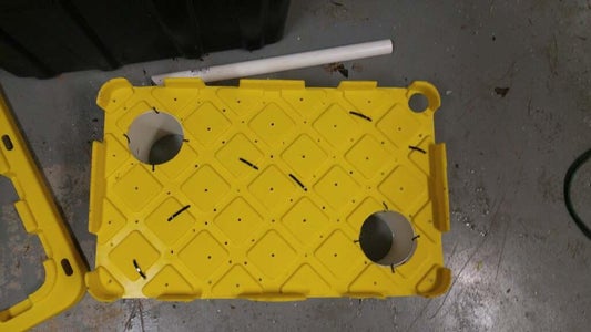

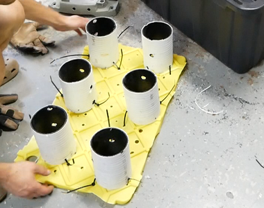

Most of the work is in setting up the divider, which is made from the lid.
  1. Drill the big holes. I am using two 4" wicking tubes, so 2 big holes.
  2. Drill the small holes. This means lots of breather holes and one hole for the filler tube.
  3. Drill tiny holes. This means lots of holes that you can use for zip-ties.
  4. Now you can cut the lid - cut out the middle, then trim the outer ring. Do not cut through the ring - you will need it to hold down the plastic.
  5. Cut the pipes. I cut the 4" pipe sections to 6" height. Also cut your filler pipe to length and slant the bottom cut so it doesn't sit flush against the floor.
  6. Drill container holes. One or two overflow holes, once you know the exact height. They should be just under the divider height.
  7. Cover the holes with some screen to keep mosquitoes out. I hot-glued aluminum screen over them.
  8. Make a cap for the filler tube (optional). I cut a union in half and hot-glued aluminum screen to it.

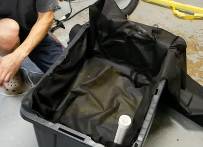

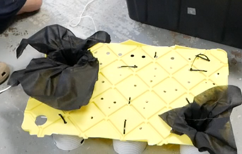

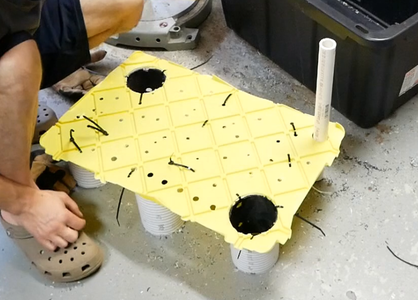

Step 2: Assemble
  • Zip-tie the support columns to the divider so it's easier to keep them lined up. Two of them should line up with the 4" holes in the divider. Ensure that they are distributed evenly to offer maximum support to the entire surface.
  • Install the assembled divider and fill tube. Place fill tube on the same side as the overflow hole. Now remove the fill tube :)
  • Line the big holes with fabric
  • Line the whole thing with fabric. Hot glue may be helpful to keep it in place.
  • Punch holes through fabric (wicking columns and fill tube).
  • Reinstall the fill tube.
  • You can now fill the container with potting mix.

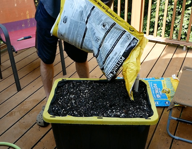

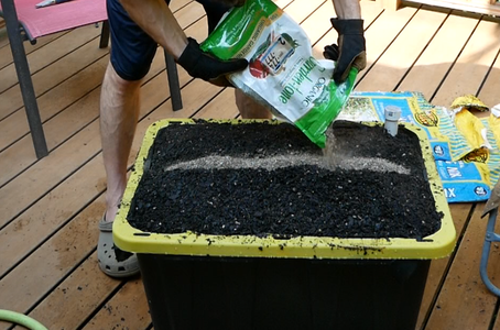

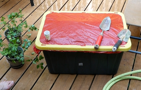

Step 3: Filling and Planting
  1. Fill the wicking columns first, packing them down gently.
  2. Water the potting mix as you go to help it settle.
  3. Overfill the container to make a rain-shedding mound.
  4. Create a trench down the midline and fill it with fertilizer. Balanced fertilizer is recommended (5 to 15 each N/P/K). The quantity is approximate (I am using a 2" line). Close the soil around it gently, do not mix it in. It will leech out over time.
  5. Cover the surface with plastic. Be sure to poke a hole for the fill tube in the right place. Plastic should extend over the edges to allow rainwater to run off.
  6. Install the ring.
  7. Fill the water reservoir. If you used a 1.25" fill tube, you can just stick the end of a garden hose in for maximum flow.

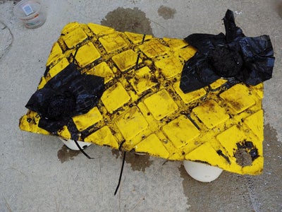

Step 4: Troubleshooting and Tips
  • If you don't use enough supports, your divider will collapse. This one was built with only 5 support pipes. You'll know that it's collapsing because the soil keeps sinking over time.

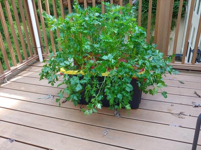

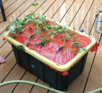

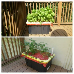

Step 5: Results
This is what the parsley looked like when planted, and then two months later. I have not had to do anything with it at all. There is still plenty of water in the reservoir.
The basil is from last year, same story.
Update November 2021
I had some light frost (29F) that killed all the basil growing directly in the ground, but not in boxes (both in the same area). I suspect that the thermal mass of water and damp soil makes a difference.
