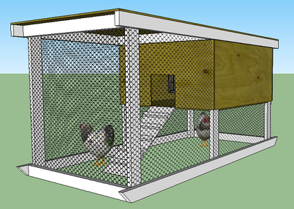

This my original design for an inexpensive and simple to build Chicken Tractor to house 3-6 large hens or 8-10 Bantams.
I built this chicken tractor out of recycled wood materials and only purchased some wood screws and a 25 foot roll of chicken wire. You can use recycled or new materials.
The tractor is 4' high x 8' long and 4.' wide and is designed so it can be moved by dragging to a new location. This would be a good design for people that just want a few chickens and have a small yard.
Material list:
12) 2x4x8 lumber
3) 4x8 sheets of 1/2 inch plywood or similar material
1) 25 foot roll 48" chicken wire or hardware cloth
1) pound 3 inch screws
1/2) pound 1 inch screws
1) pound small chicken wire staples Hinges if desired
Approximate cost under $50

Step 1: Construct the Side Walls
Step 1: Construct the side walls
Side walls are constructed from 2x4 lumber. Attach side braces to bottom and roof brace using 3 inch exterior grade wood screws. The bottom brace is cut at an angle 3 inches from the end so it will slide easier over the ground.

Step 12: Attach Chicken Wire or Hardware Cloth to Pen
Step 12: Attach Chicken wire or hardware cloth to pen
Attach chicken wire using ½ heavy duty staples into the frame and braces. Chicken wire is placed on the inside of the braces and goes to the bottom of the floor braces.
Create a ladder or ramp for chickens to get in and out of the pen door.
Step 13: Install Nest Boxes and Roost Bar
Step 13: Install nest boxes and roost bar
Roost bar is 2x2 lumber and is placed so chickens can roost off the floor.
That is it for the plans and you can modify the
plans to suit your needs with additional doors in the box and run.
