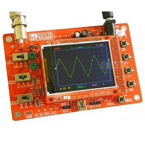

Welcome to my overview Instructable! This is going to be more of a 'pre-Instructable', where I just review the individual components of the DIY Oscilloscope kit from Gearbest. To follow will be an assembly Instructable and also a usage and final review Instructable.
This kit is an opensource product, allowing you to fully modify it in anyway you want. All of the source can be found on the main product page here. If you make any mods to your kit, be sure to post them and share with others! Maybe after I assemble it I will try to make some mods to it to share!

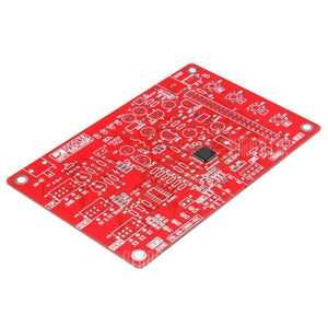

Step 2: Main Board
Now, I don't have a fancy microscope that I can use to REALLY inspect a circuit boards quality, but I like to think that my eyes are still working pretty well.
The PCB that comes with this kit is a bare board except for the main processor, a STM32, a 32-bit ARM Cortex microcontroller. A lot of times when I get a kit and there are SMDs already soldered on, I would think that the only assembly that I need to do is solder some through-hole components. However, with this kit that is untrue and for the best! Soldering PTH(plated through hole) components is easy enough on a board like this, so the addition of SMD components that are required to solder on is a great thing in a kit like this. That's the reason to buy a KIT right??
there are a handful of SMD resistors that need to be soldered on along with two additional ICs, one SO14 package and one TO263 package. The resistors in this kit at size 0805, not the easiest, but far from the hardest! (Try soldering some 0402 components by hand!)
Overall the board seems to be very high quality with a very nice red soldermask. All of the silkscreen on the board is easy to read and does not overlap awkwardly. All components are labeled closely and cleanly. I am looking forward to assembing all of the SMD and PTH components on this board!

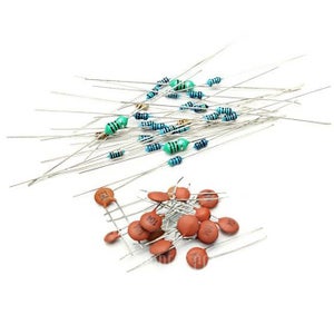

Step 3: PTH Components
This kit comes with a multitude of different style components for you to solder and master your skills. There are resistors of a couple different sizes, polarized electrolytic can style capacitors, non-polarized ceramic capacitors, diodes, trim pots, an inductor, some transistors, buttons, switches, headers, a USB Mini port and a BNC connection. With soldering this variety of components, there are going to be a few different techniques required to solder in each one, I will display some of these in my assembly Instructable.
I am no component/brand expert but these components seem to be of good quality for a kit like this. The three position switches grip into the three different positions pretty well so you don't slide past accidently. The push buttons have a nice audible click to them, something that I find a good property that is sort of a bonus just based off of the mechanical nature of the item.
The true test for all of these components will really come once you start using the kit and applying force to the switches buttons and connectors.

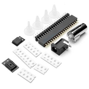

Step 4: SMD Components
There is not much to say here, there are three different package types that are in this kit, the 0805 resistors with five different values, the SO14 IC and the TO263. The SO14 package does have the finest pitch of these components but with a nice sharp soldering iron tip it shouldn't be a problem for beginners.

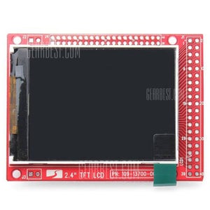

Step 5: TFT LCD Display
TFT LCD screens are becoming quite popular in DIY projects, as the price drops and resolutions increase it's easy to see why! I think one of the great things about this kit is that they provide mating headers for attaching the screen. This is a huge advantage for hobbyist who like to pick apart old projects to use components or test with components already lying around. If you had to unsolder this 40 pin connector, you might go crazy and end up just buying another one anyways!
Another good 'freedom' feature is the fact that the board for the LCD has two different orientations for how you want to mount. You could also use the other set of connections for a secondary header that you could use when you temporarily salvage the screen to test out a new project.
Overall the screen looks pretty nice. According the the product page the image is very nice too, compared to another Oscope kit that I have done. Once I get it together and powered on, I will do a side by side of the two.

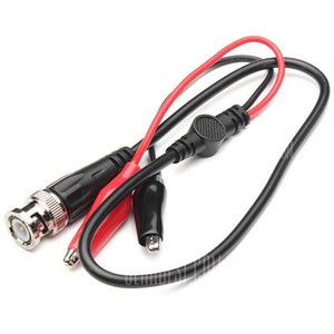

Step 6: BNC to Alligator Cable
This kit comes with a short 1' cable to be used with the kit. Of course, you could use any oscope cable that you have lying around. This is a good cable for doing quick measurements in the field, or somewhere that you may not be able to bring a full size scope.
