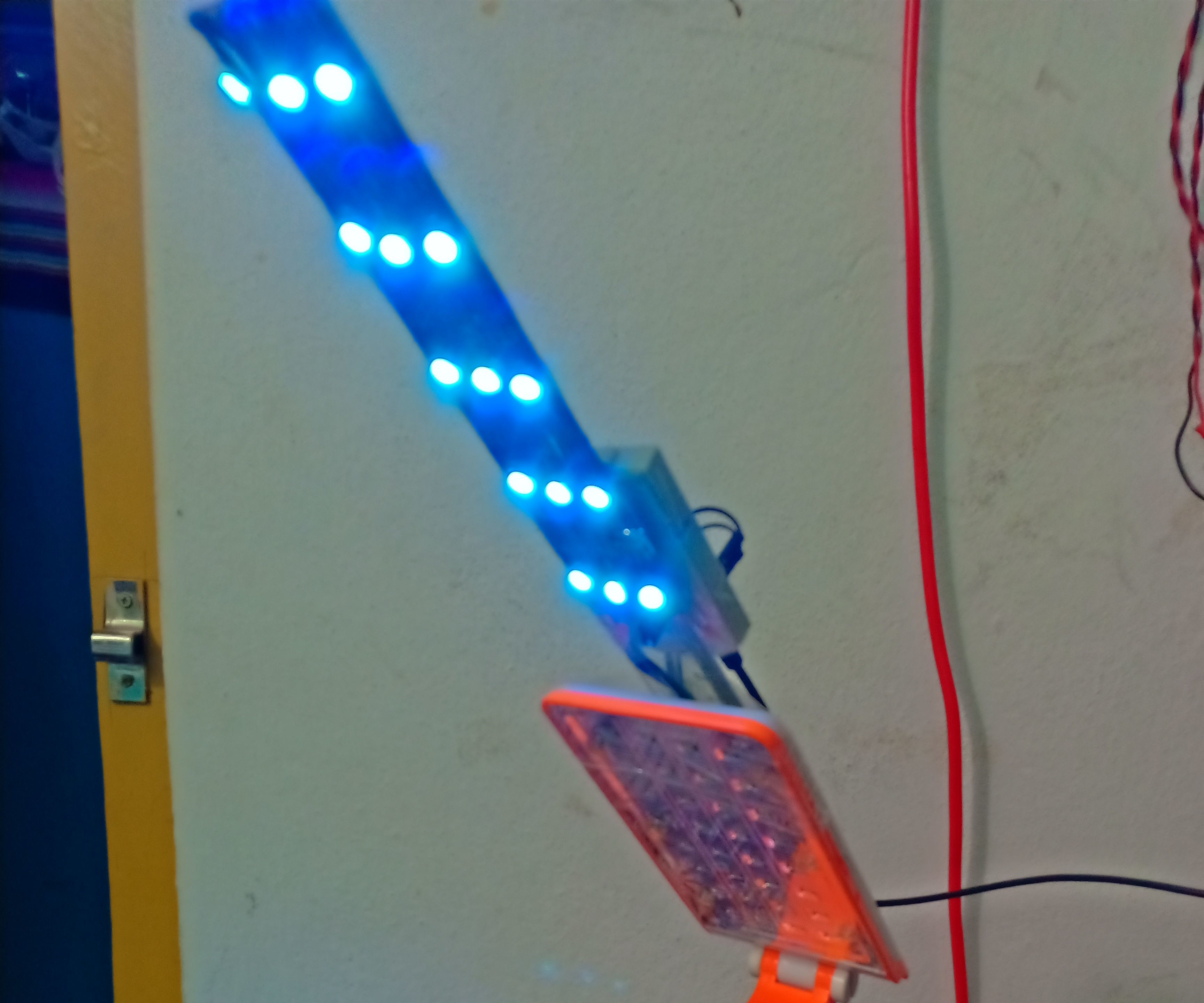

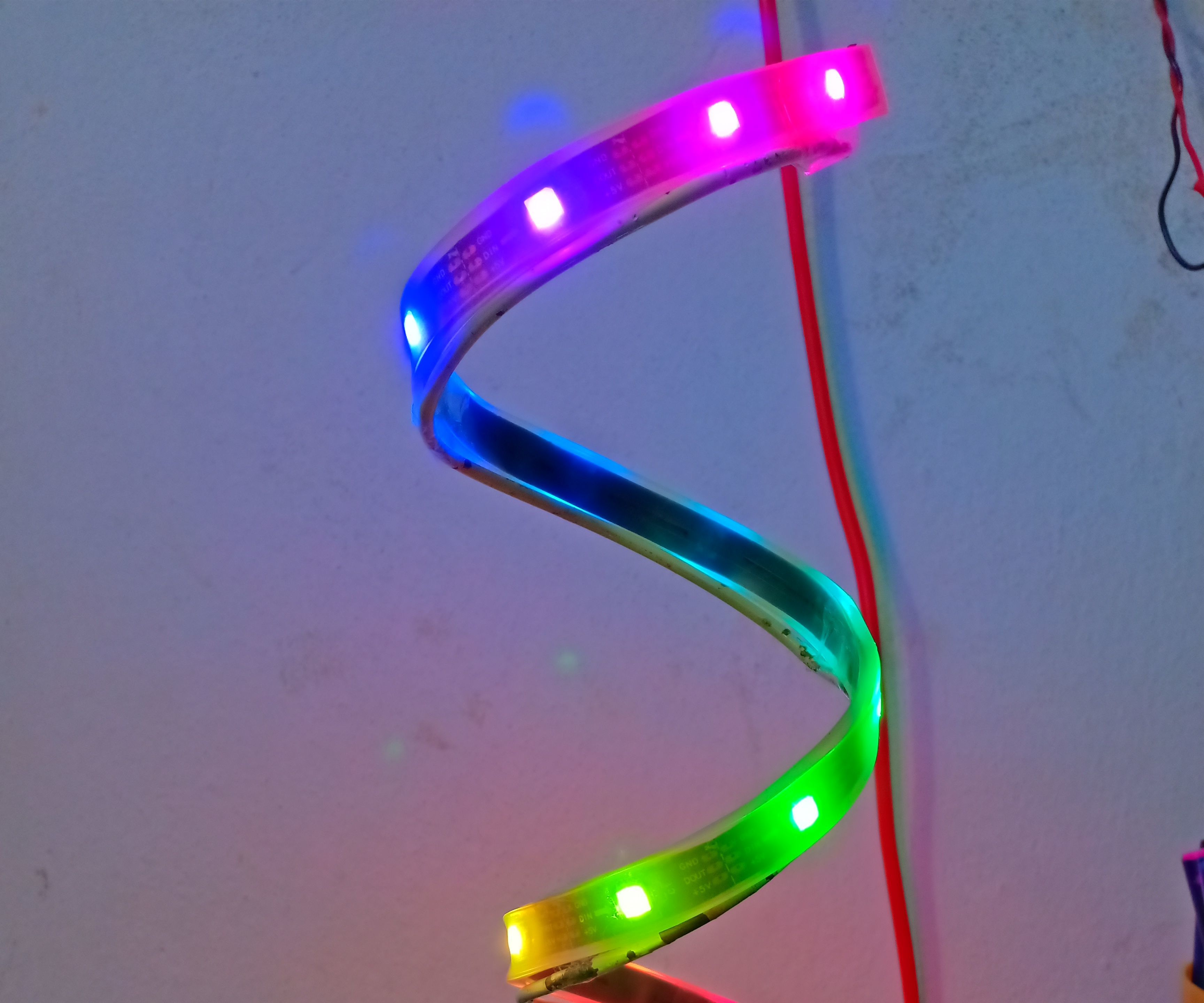

Step 4: Adding Leds
Here i'm adding LED's to make the robot attractive. So whenever I say 'Wakeup' these LED's will be turned ON creating a feel that robot is going to turn ON.
For this i've used 16 LED's which are connected to arduino mega (I can't connect the LED's to arduino uno //which works as talking robot//
Because i'm exhausted with the pins) that is why i've used 2 arduinos.
And here i'll make 2 arduinos to communicate with each other.
This is simple when I say wakeup the arduino will to that command and will give the command analogWrite(A0,500) (because i've connected arduino uno A0 to arduino Mega A15. So whenever arduino mega receives this command it will activate the Led's.
