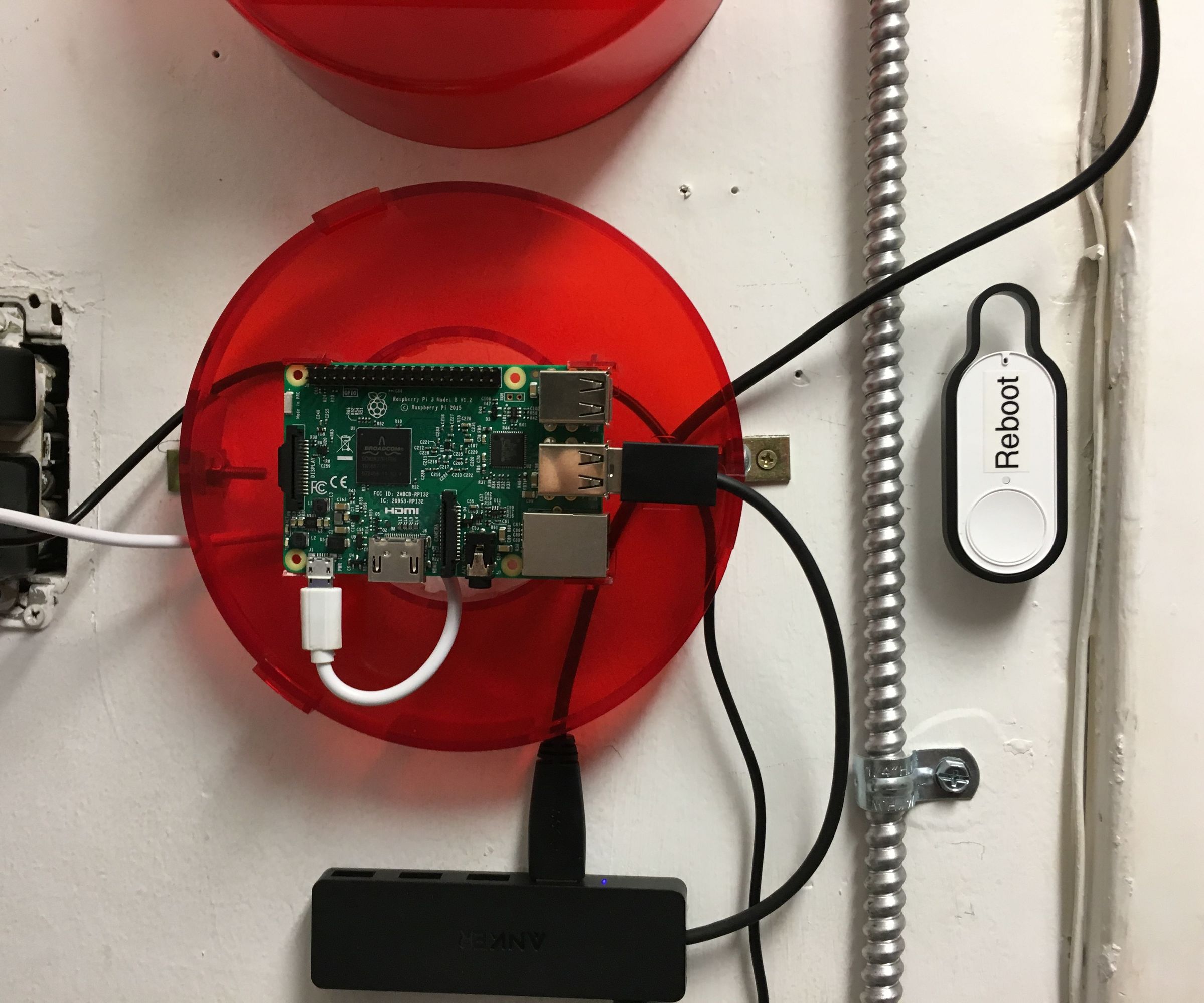

Lastly, make it look good! If you are using this as a real life solution, make sure that it has a permanent place, somewhere you won't accidentally step on it. I've mounted mine to the wall of a closet, and that's where it lives, in fact, I'll even include a picture of what it looks like, so anyone who wants an example can see one.
If you noticed, I have some extra lights on my Pi, these are USB flash drives that I stripped down, when plugged, in they have some lights that adds a little bit to the whole look, there are so many ways to make it look good, let me know what you did!
