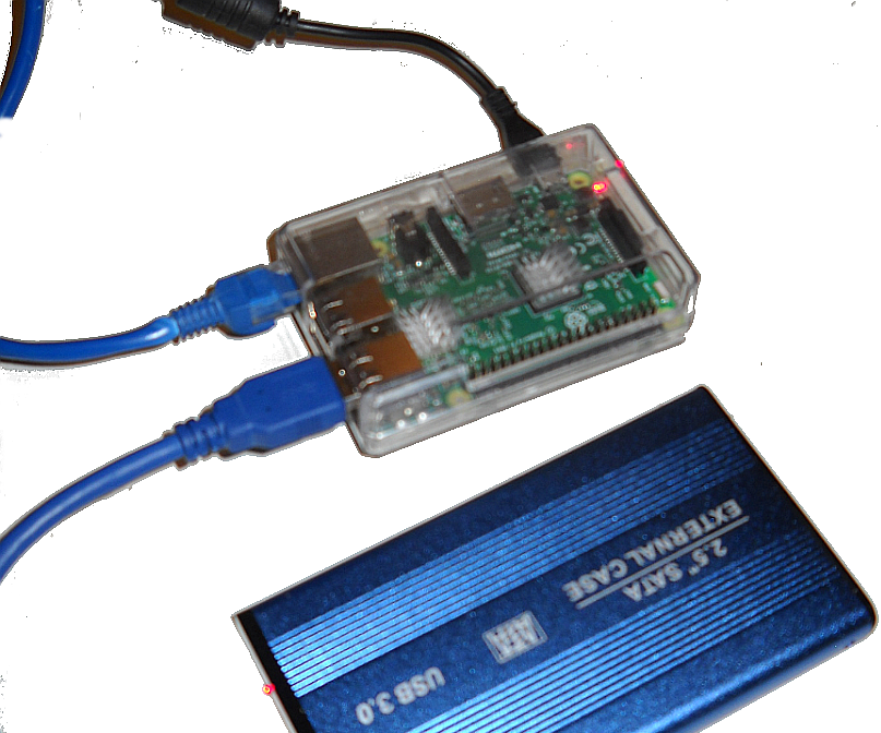

These instructions are for installing owncloud 9 on a raspberry pi 3b using a 2.5 inch hard drive for the cloud storage.

Plug in your usb connected 2.5 inch hard drive. The power supply for your pi needs to output 5 volts 2.5 amps.

Now watch Owncloud work seamlessly. Your raspberry could server sits, drawing about 1.5 watts. When you save a file into one of your Owncloud backed up directories, the raspberry pi fires up the hard drive and automatically saves a copy. A few minutes later the 2.5 hard drive goes to sleep again. You can access your files with a browser or with the client.
