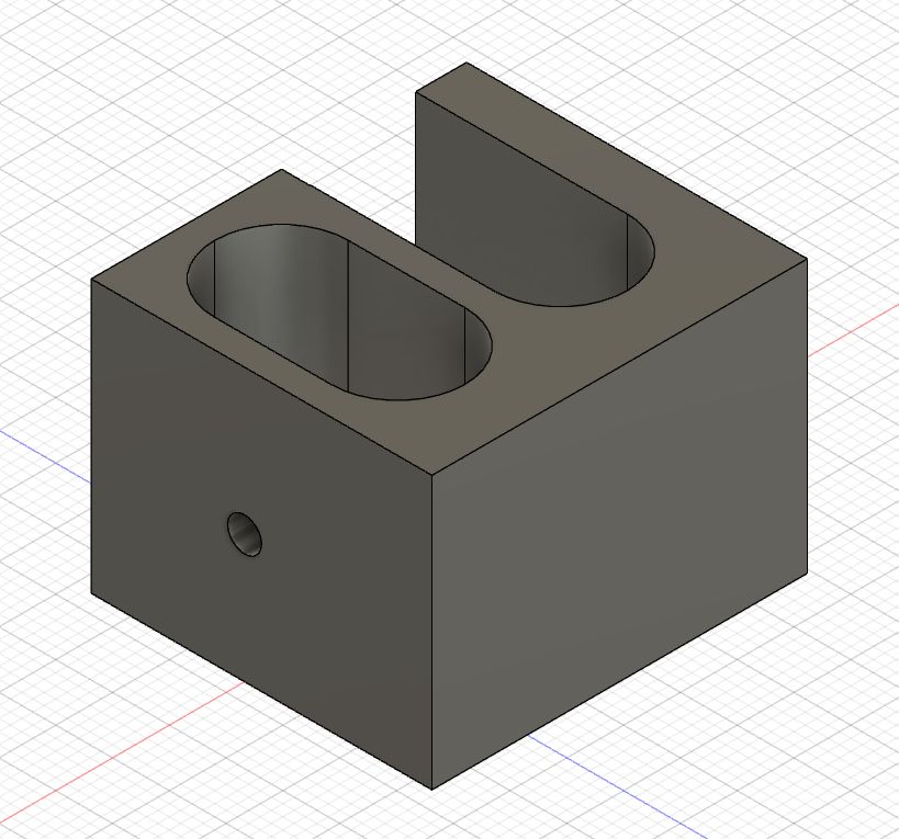

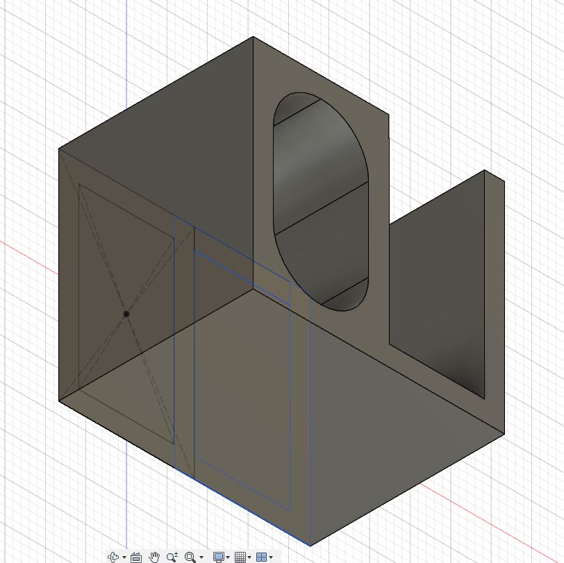

This really is not that difficult of a bracket to design, but it needed to be a 1 to 1 fit and to beef up the corner area so it wouldn't break again. I have been playing around with 3d scanning but I cant get it right just yet. So I pulled out the calipers and started measuring.
I got the overall sizes and radius of the inside corners.Then I determined the overall outside dimensions and then started making rectangles in fusion.

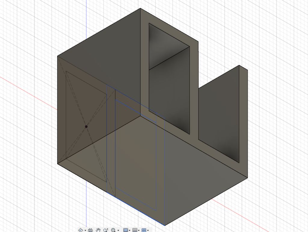

Then make an extrusion from those rectangles
Then we made the inner bevel radius.

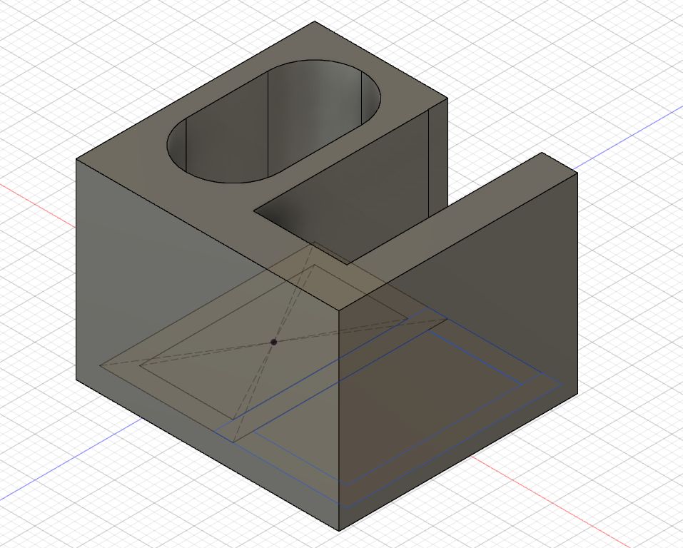

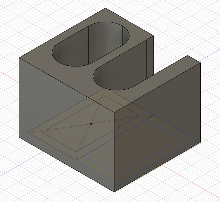

Then we make the bottom and right side thicker for better stability.
Now on the open side we need to create the bevel.
We also create a hole for the screw to hold the part on

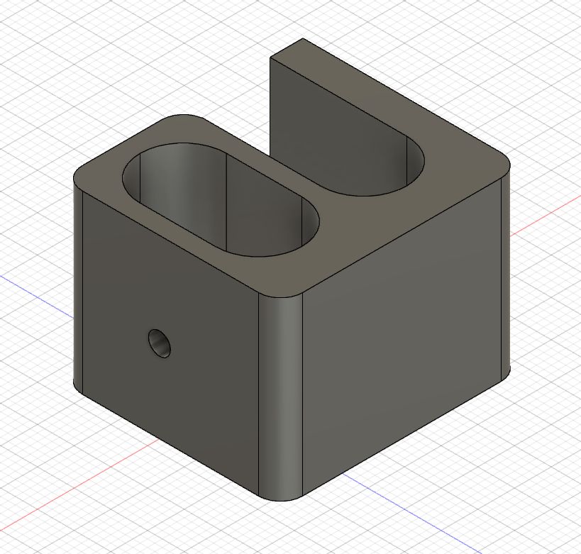

And finally we put a bevel edge on the rest of the corners to finish it off
