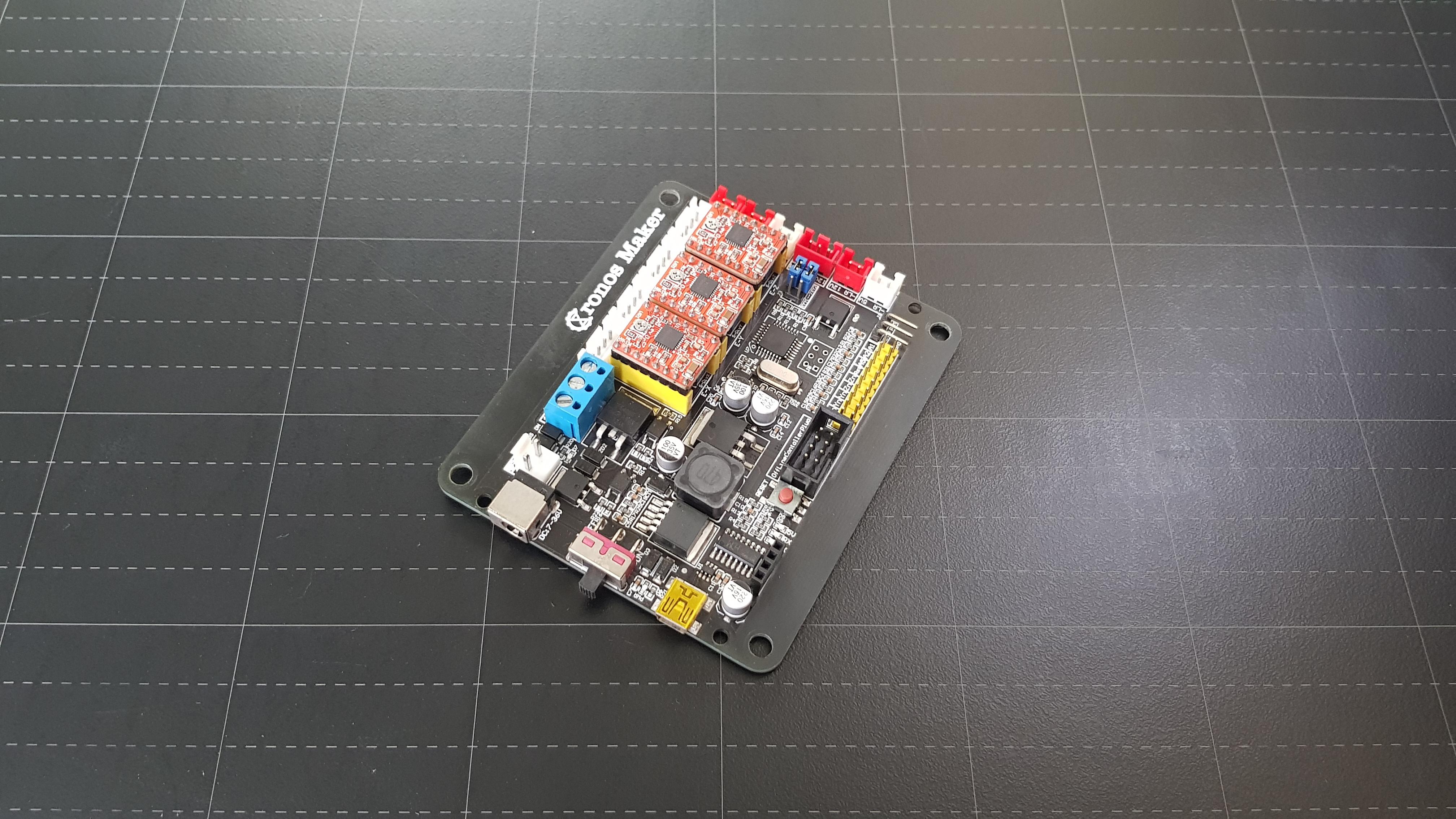

          I used a GRBL-based controller for a 3-axis CNC machine and it supports laser control.Connection diagrams:
        • Plugging three stepper motor drivers A4988 on the CNC controller at X, Y and Z label position.
        • Connecting the cables from CNC controller to three stepper motors.
        • The laser module has 3 wires connected to a female header: Red (12V+), Black (GND), Yellow (PWM) and I just connected it to a 3-pin laser male header on the CNC controller with the same label.My laser module parameters are shown on the nameplate as follows:
          • Wavelength: 450nm.
          • Power output: 2.5W.

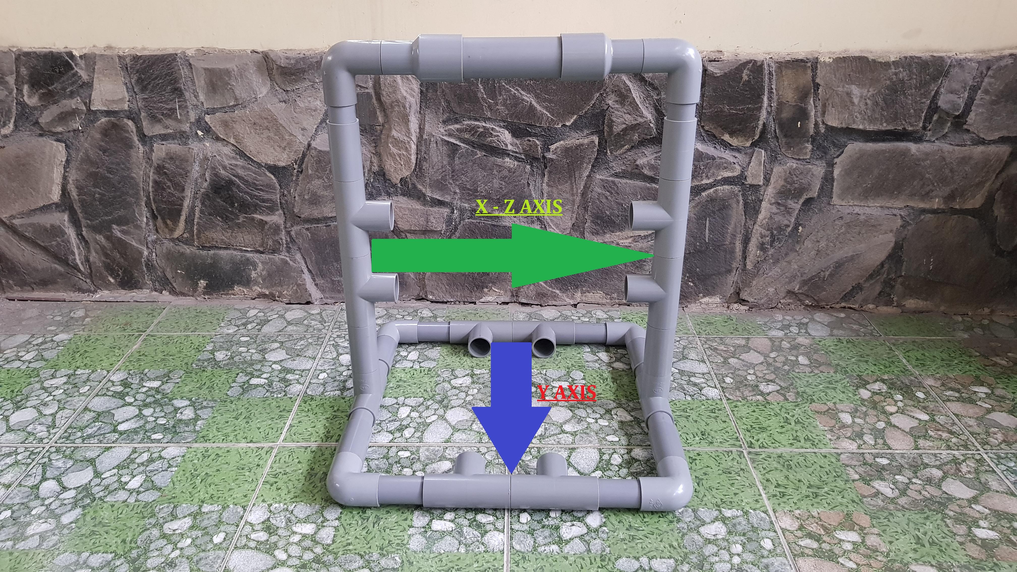

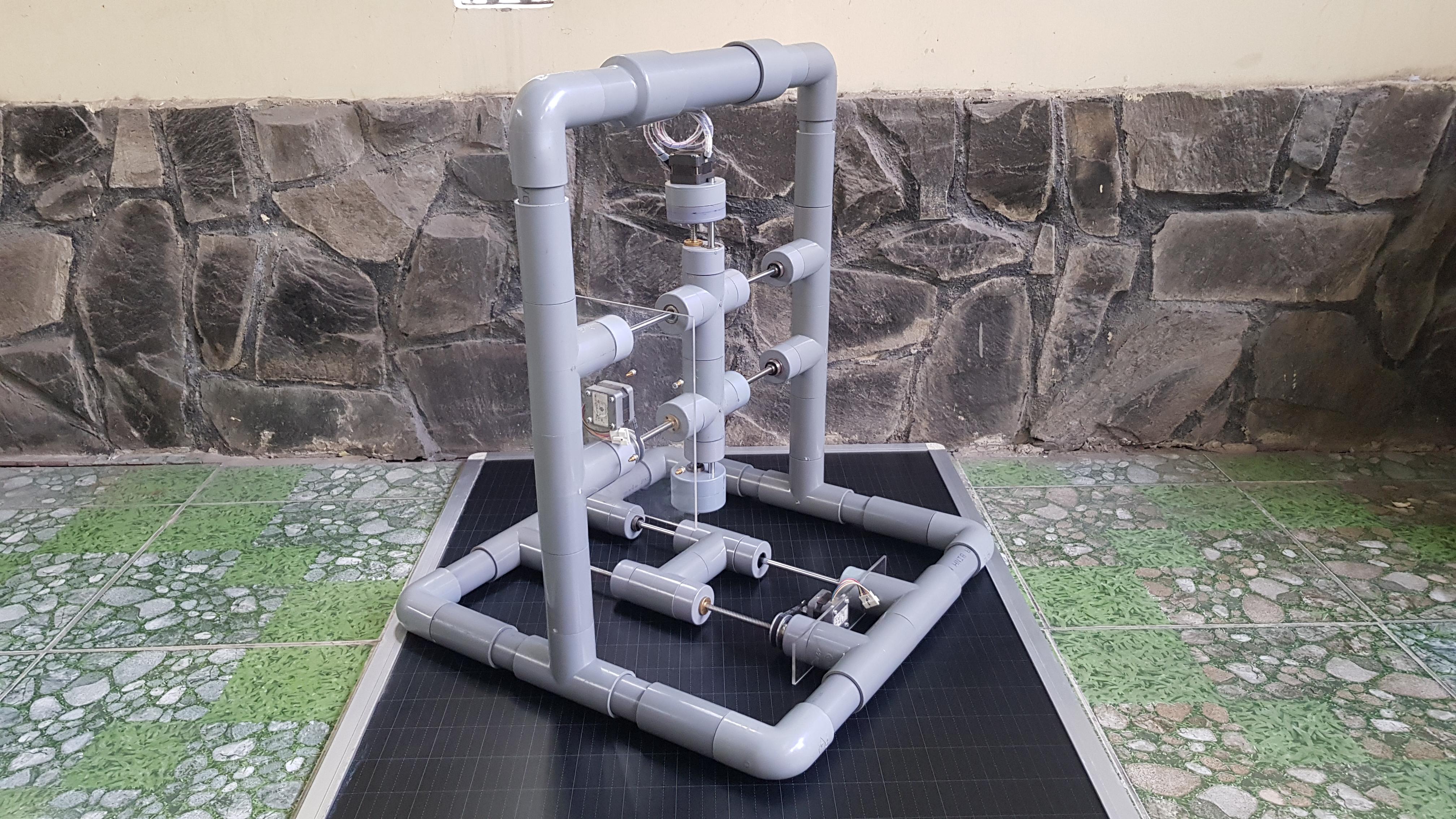

        • Step 3: Building P-CNC Frame

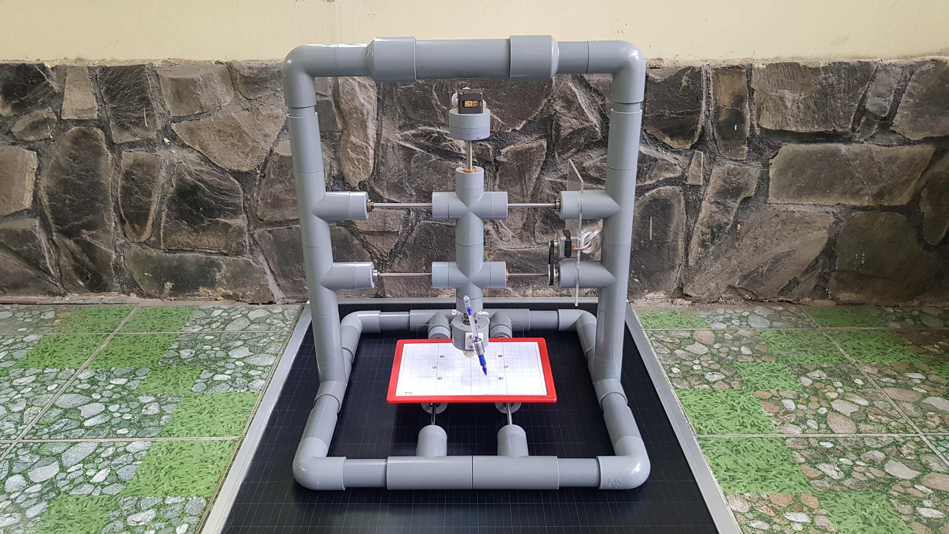

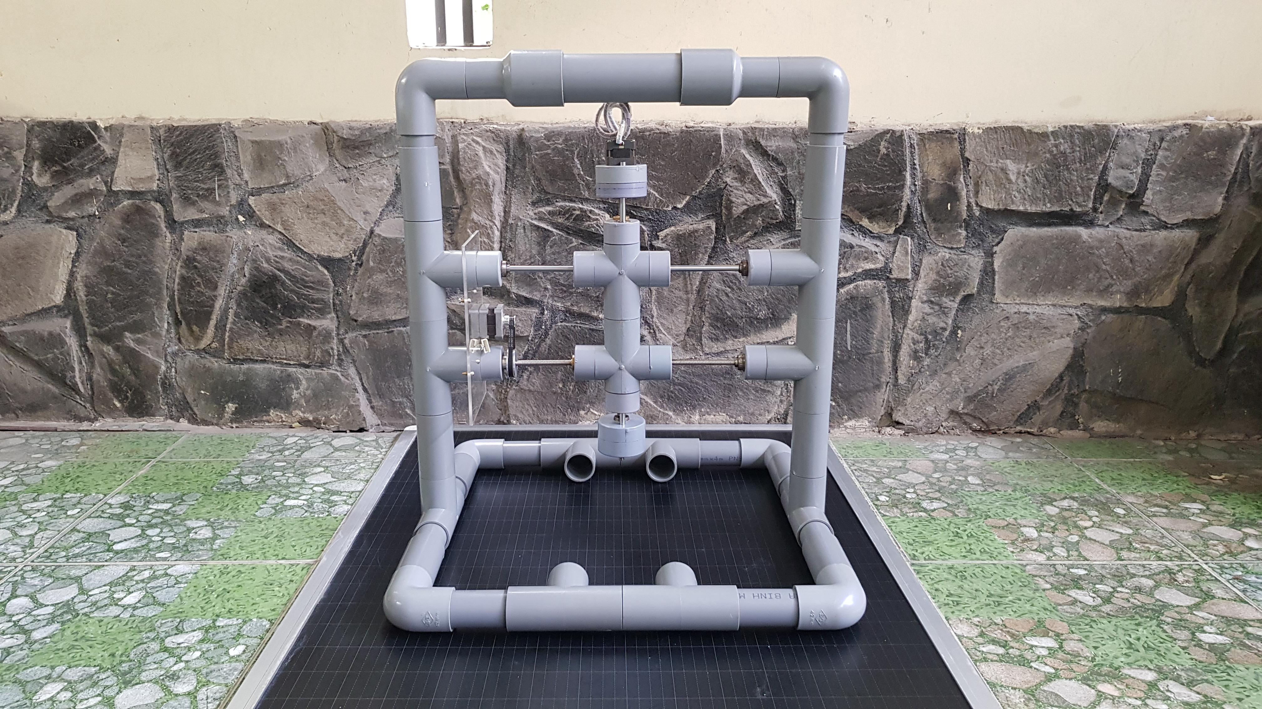

          I assembled a PVC frame, with horizontal dimension L480 x W480mm and vertical dimension W480 x H550mm.
          It was made of:
          • 10pcs x PVC tees Ø42mm.
          • 6pcs x PVC elbows Ø42mm.
          • 8pcs x PVC straight connectors Ø42mm.
          • 2pcs x PVC reducer Ø60mm - Ø42mm.
          • And some PVC connecting pipes Ø42mm & Ø60mm.
          With PVC fittings, I could built a frame easily which had 4 pairs of pipes that were completely symmetrical each other. My arrangement idea was as follows:
          • The X and Z axes: mounted on the vertical frame.
          • And the Y axis: mounted on the horizontal frame.

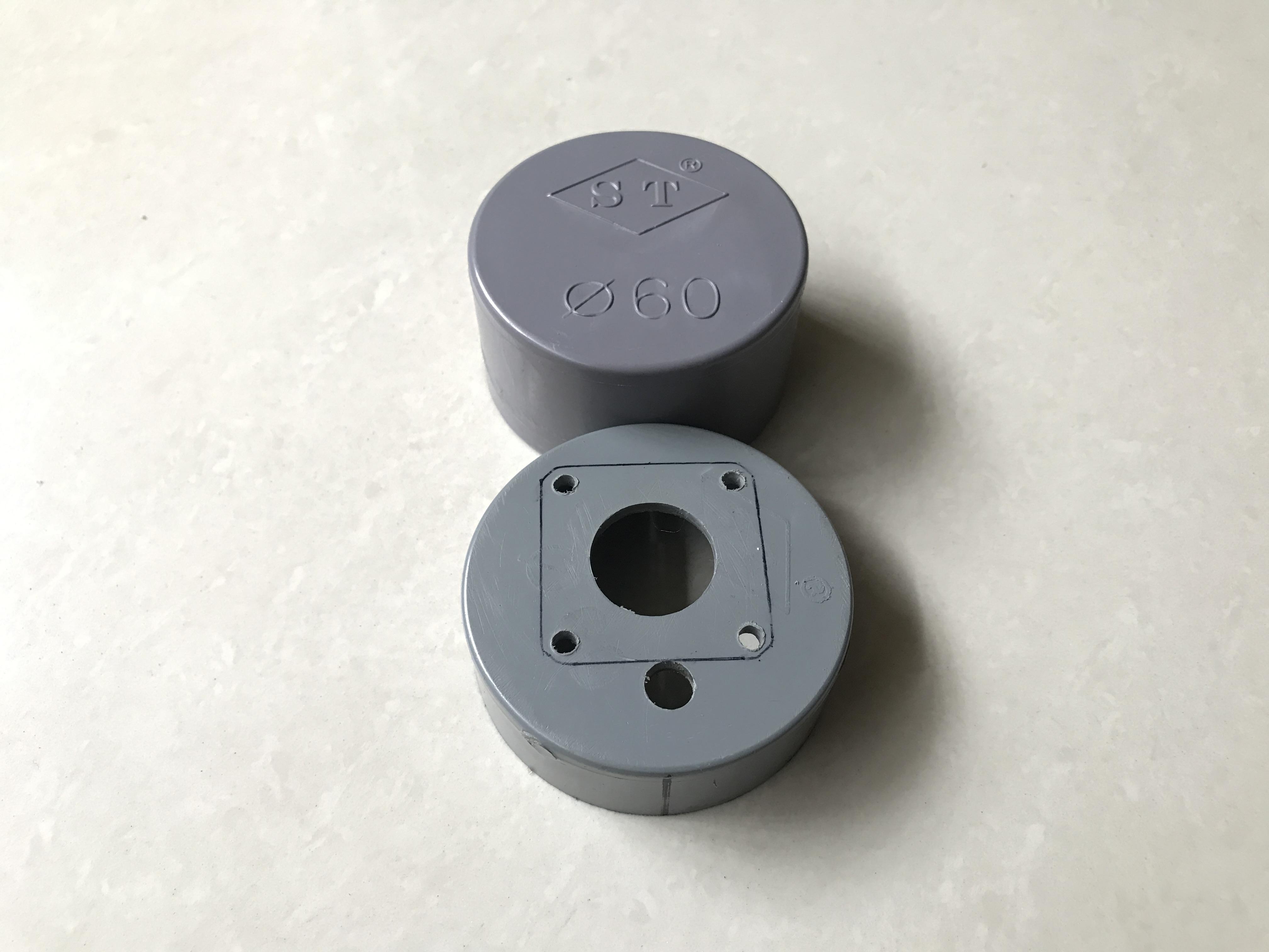

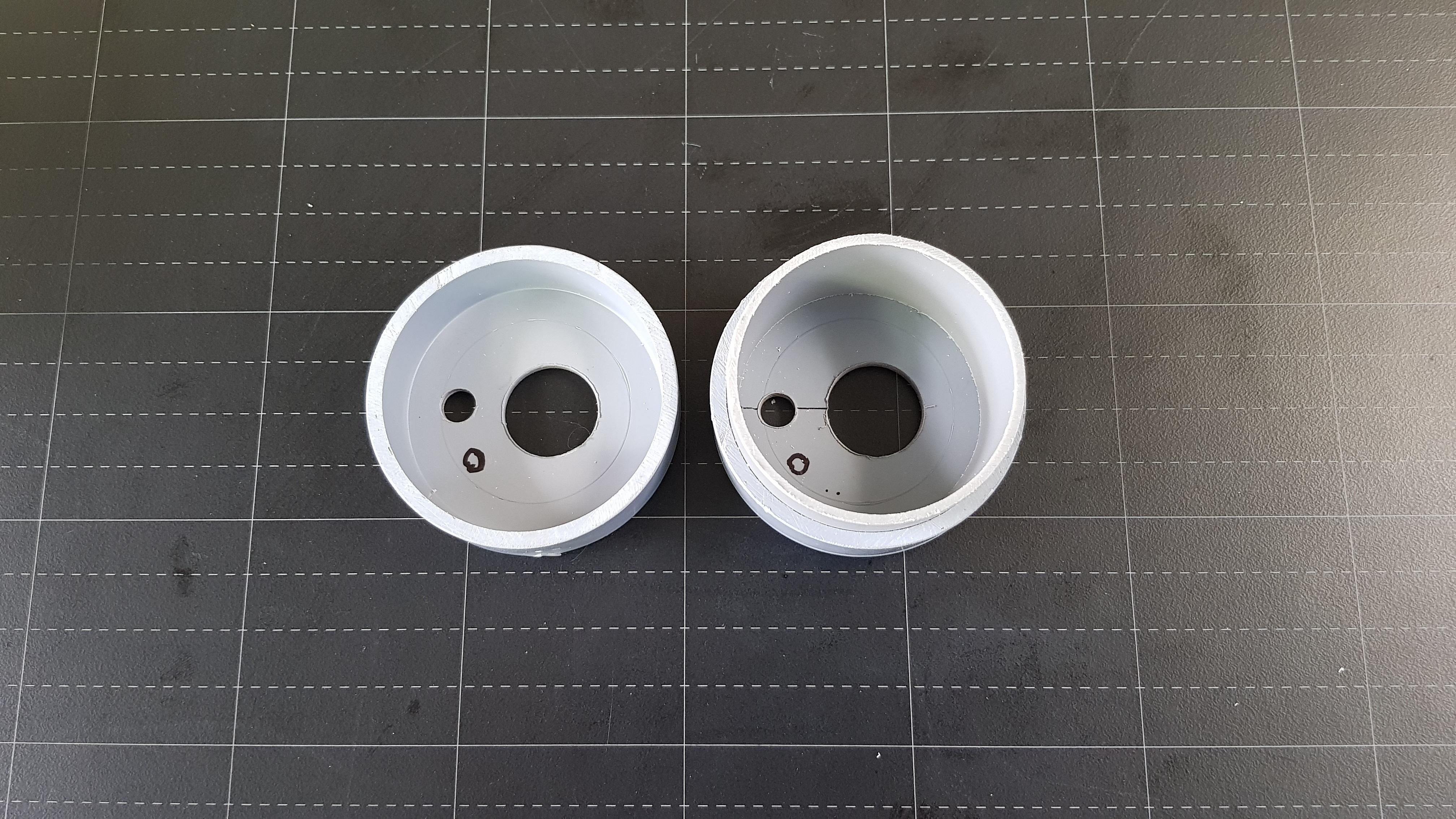

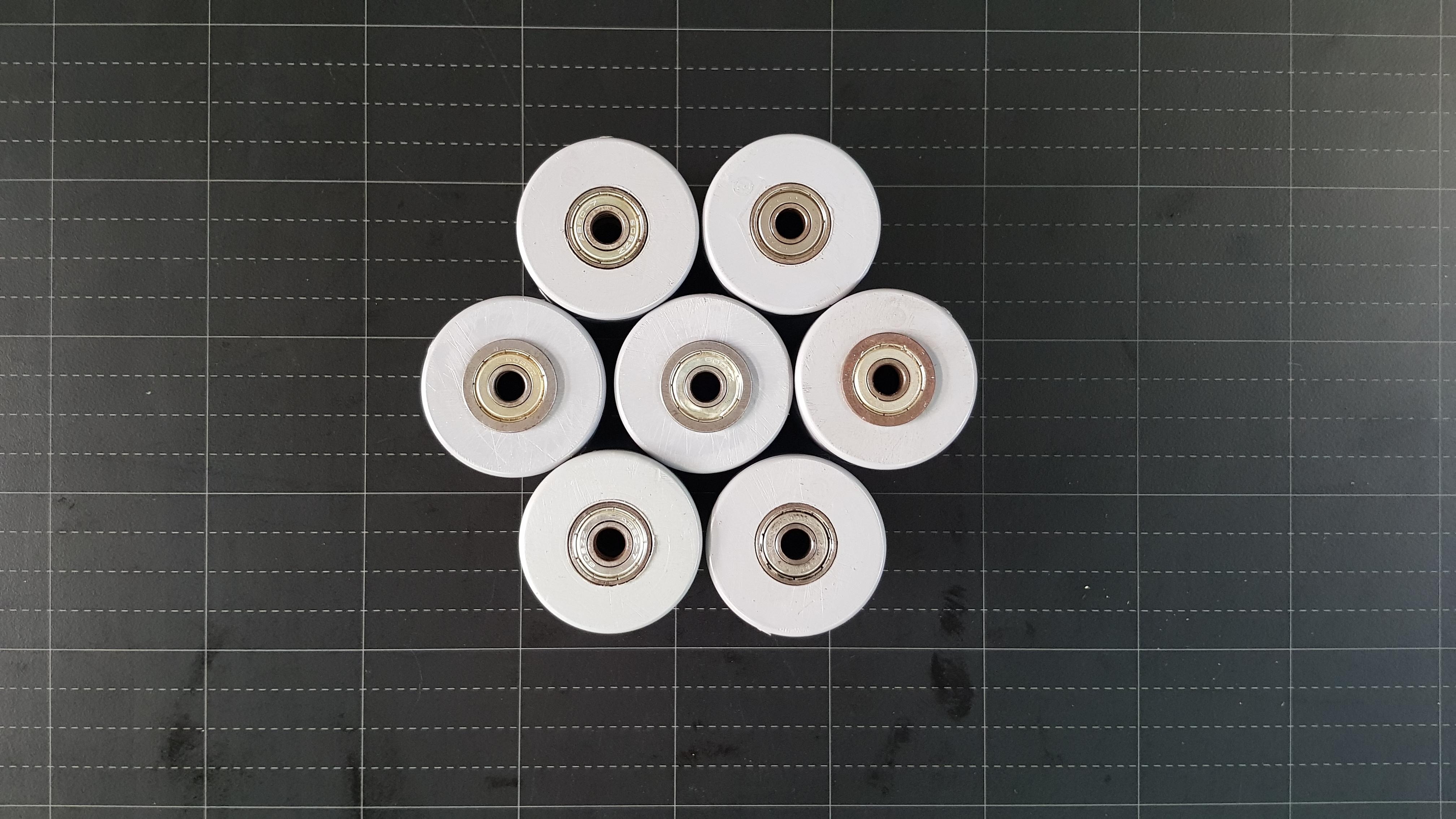

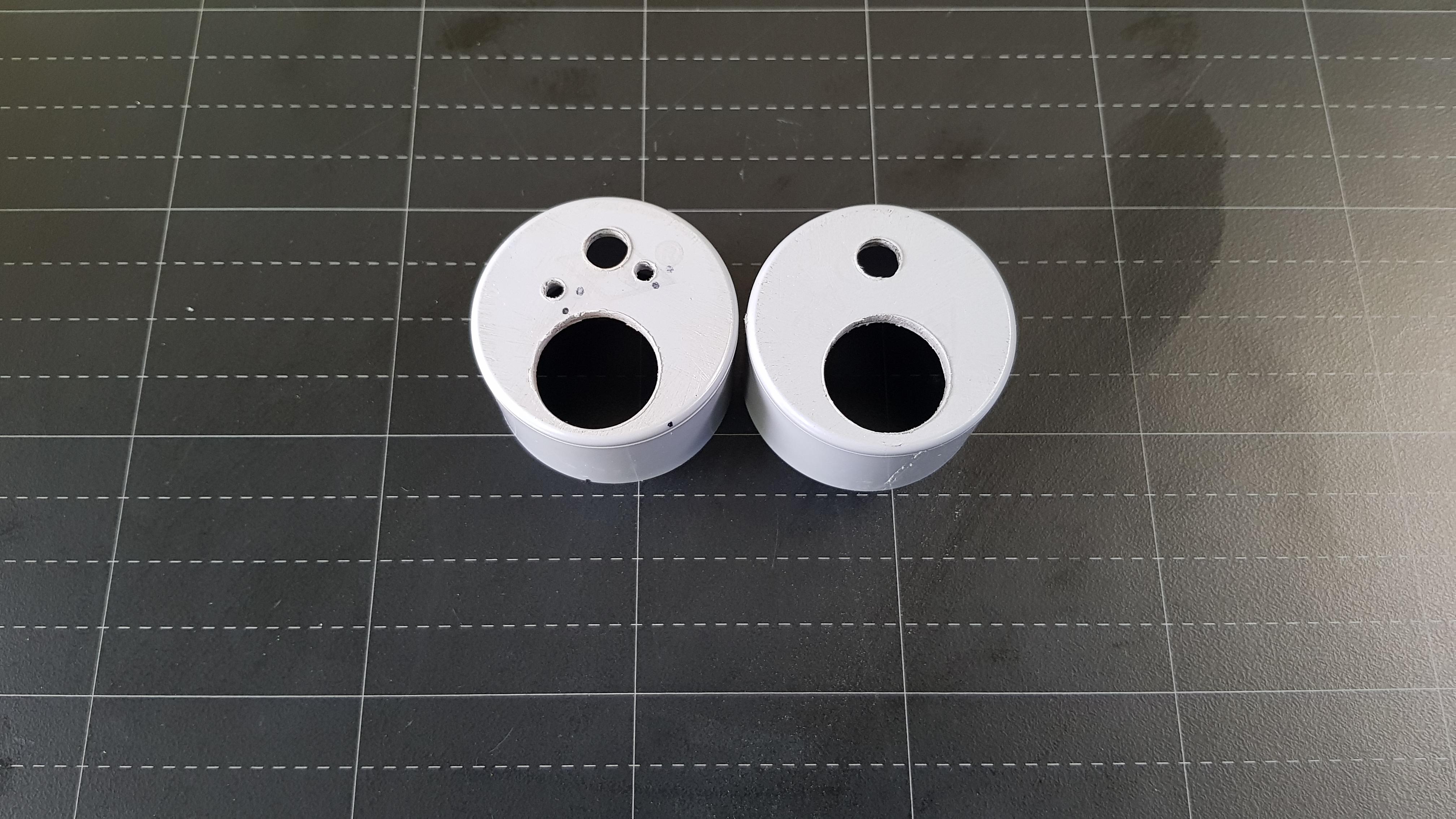

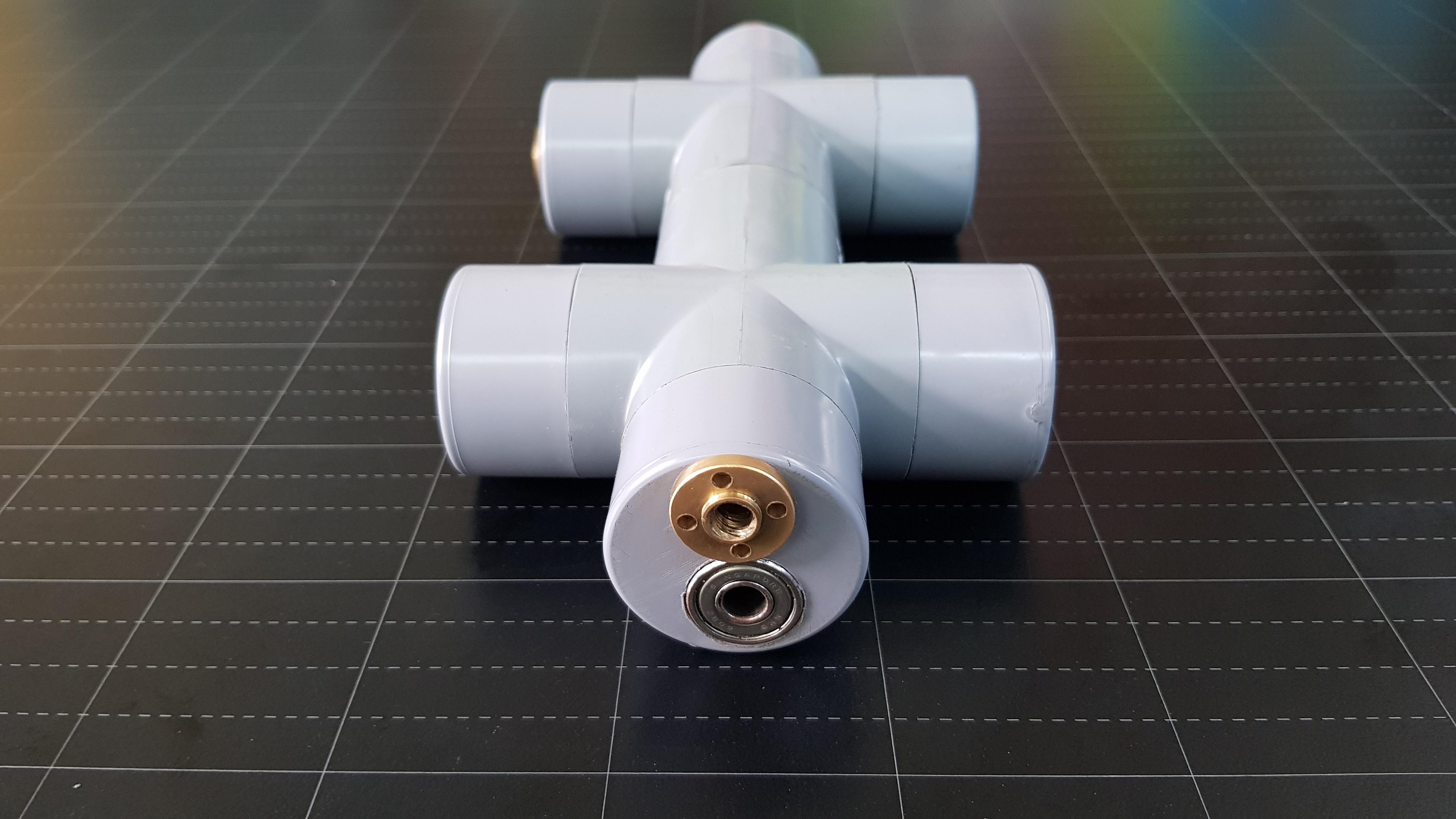

          Step 4: Drilling Works
          I used PVC pipe end caps plus bearings/copper nuts to mount/ thread the CNC round shafts and lead screws. For drilling works, I used a normal drill bit 8mm & a punch drill bit 22mm in this project. Detail is as follows:
          • One drilling hole - Ø22mm - on the end cap Ø42mm: total 14pcs, for mounting round shafts and lead screws of X and Y axes.
          • One drilling hole - Ø10mm - on the end cap Ø42mm: total2pcs,for copper nuts of lead screws. I used 8mm drill bit, then I made these holes a little wider carefully, until copper nuts could be tightly inserted to the holes. Their pictures are as same as above pictures with 10mm holes in the center.
          • Two drilling holes - Ø22mm & Ø8mm - on the end cap Ø42mm: total 4pcs, for mounting Z axis.
          • Two drilling holes - Ø22mm & Ø8mm - on the end cap 60mm: total 4pcs, for mounting Z axis stepper motor and Z axis working base. One of them is used to mount the stepper motor so it has been drilled 4 more small holes.

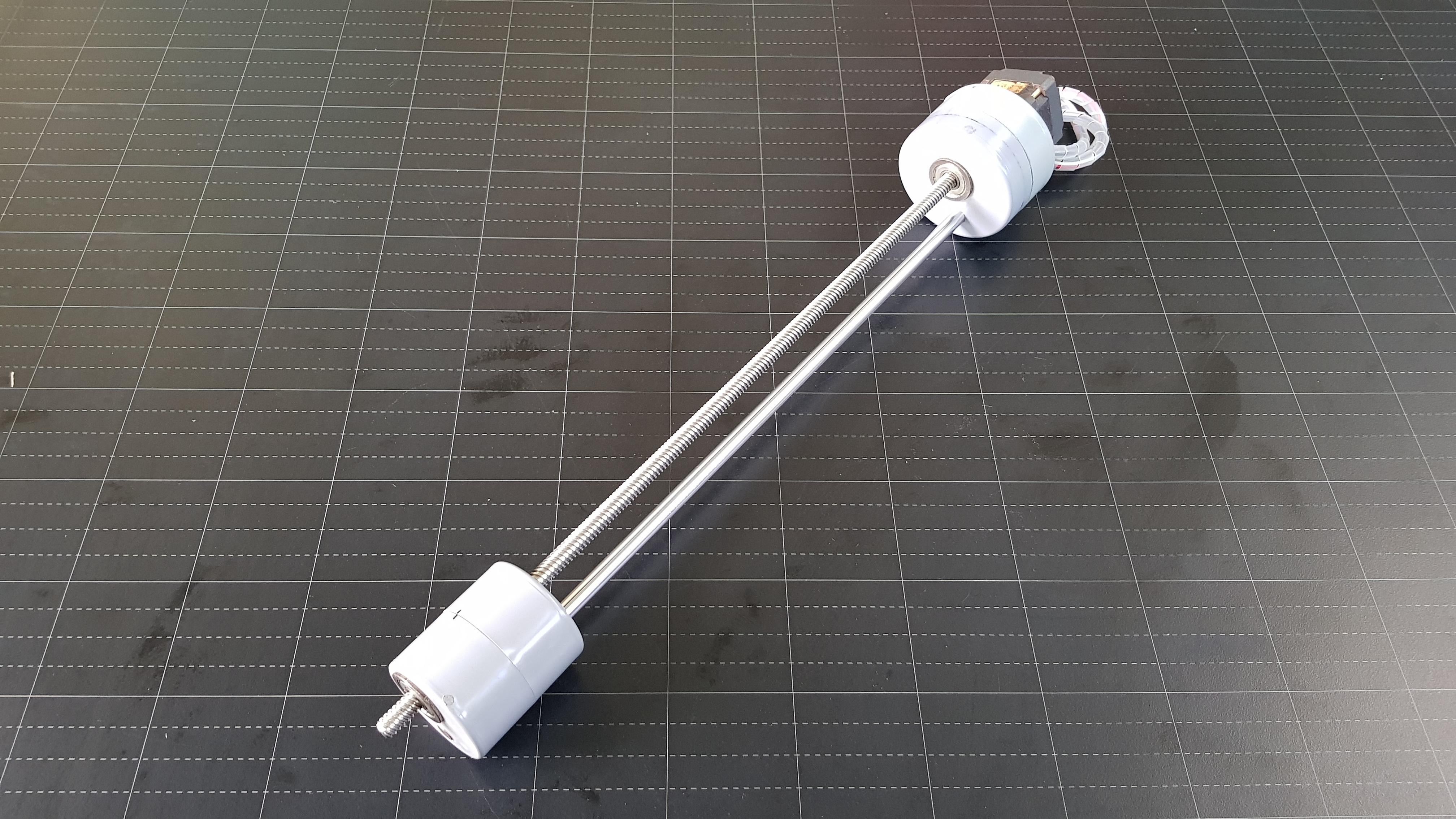

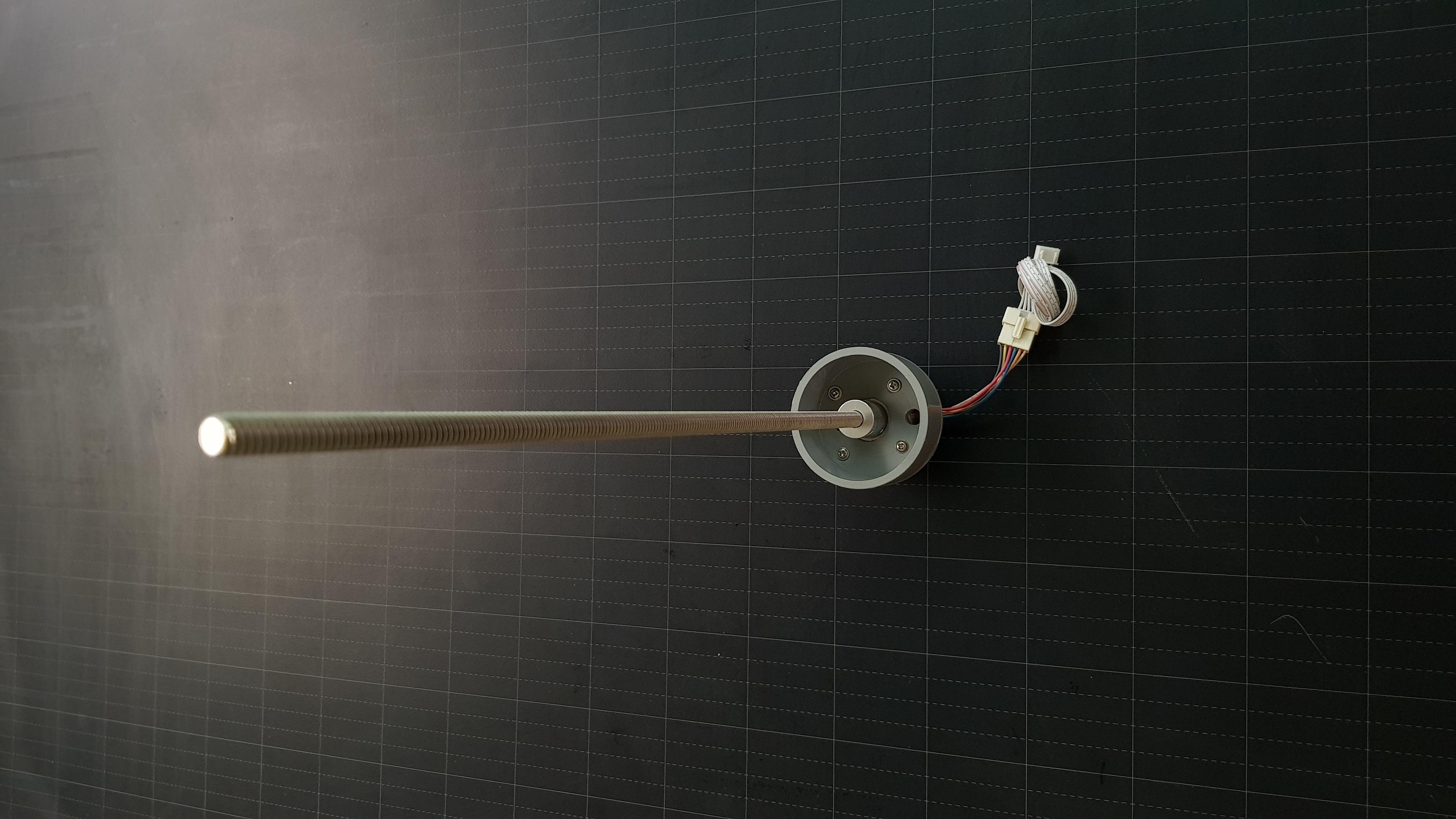

          Step 5: Z Axis Assembly Work
          • All end caps Ø60mm for mounting Z axis should be cut to proper length to extend Z axis working space.
          • Mounting Z stepper motor and connecting to 400mm lead screw by flexible coupling 5 x 8mm.
          • Connecting motor base to a remaining end cap and installing a shaft into 8mm diameter holes.
          • Fixing it by two end caps at the opposite of Z stepper motor.

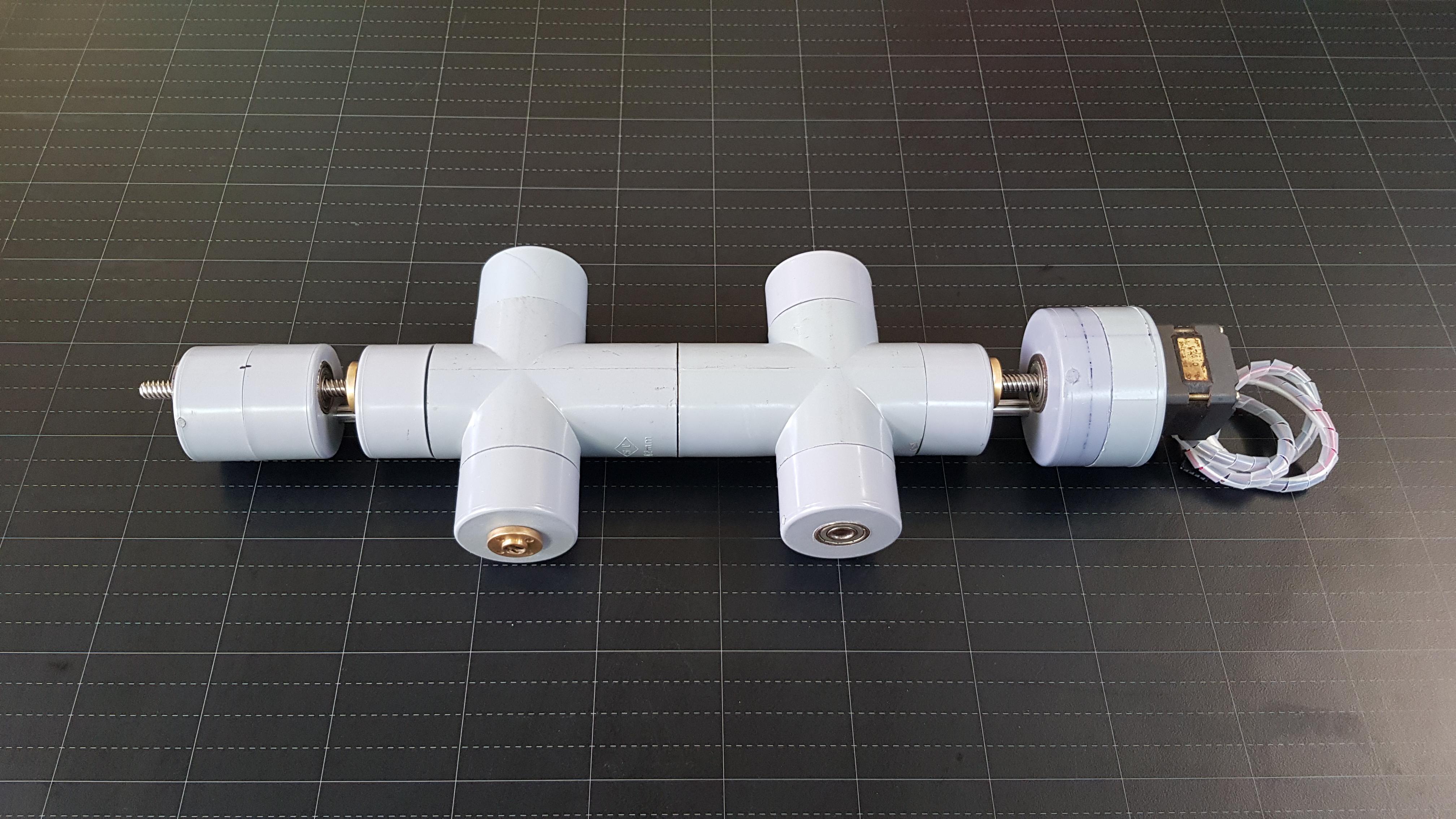

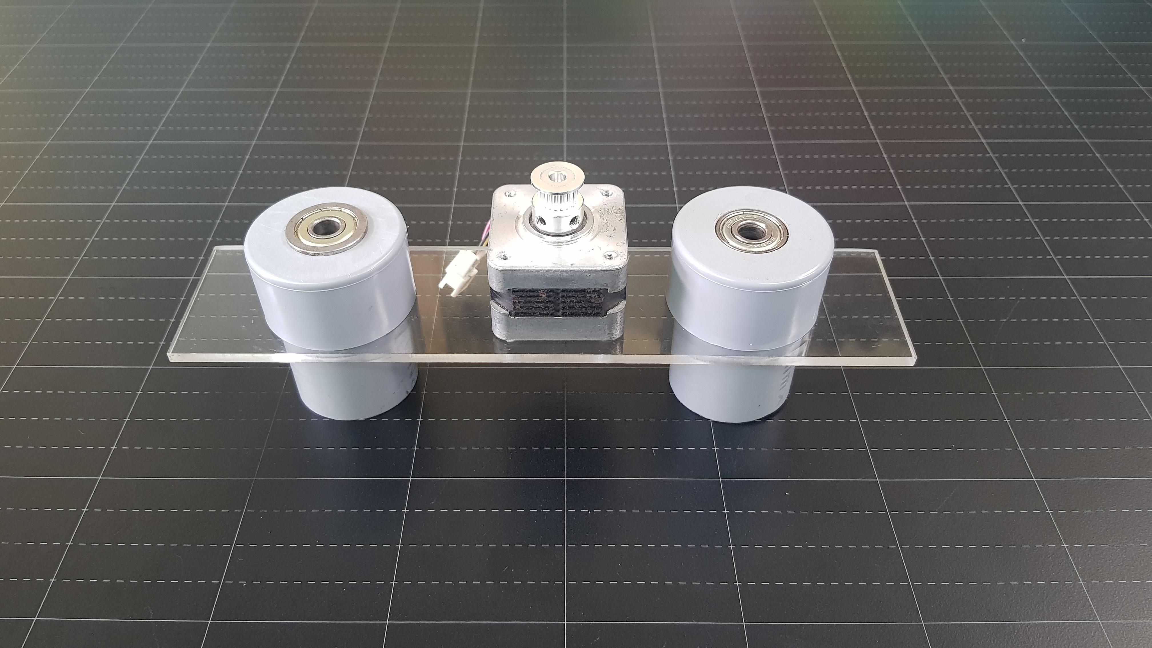

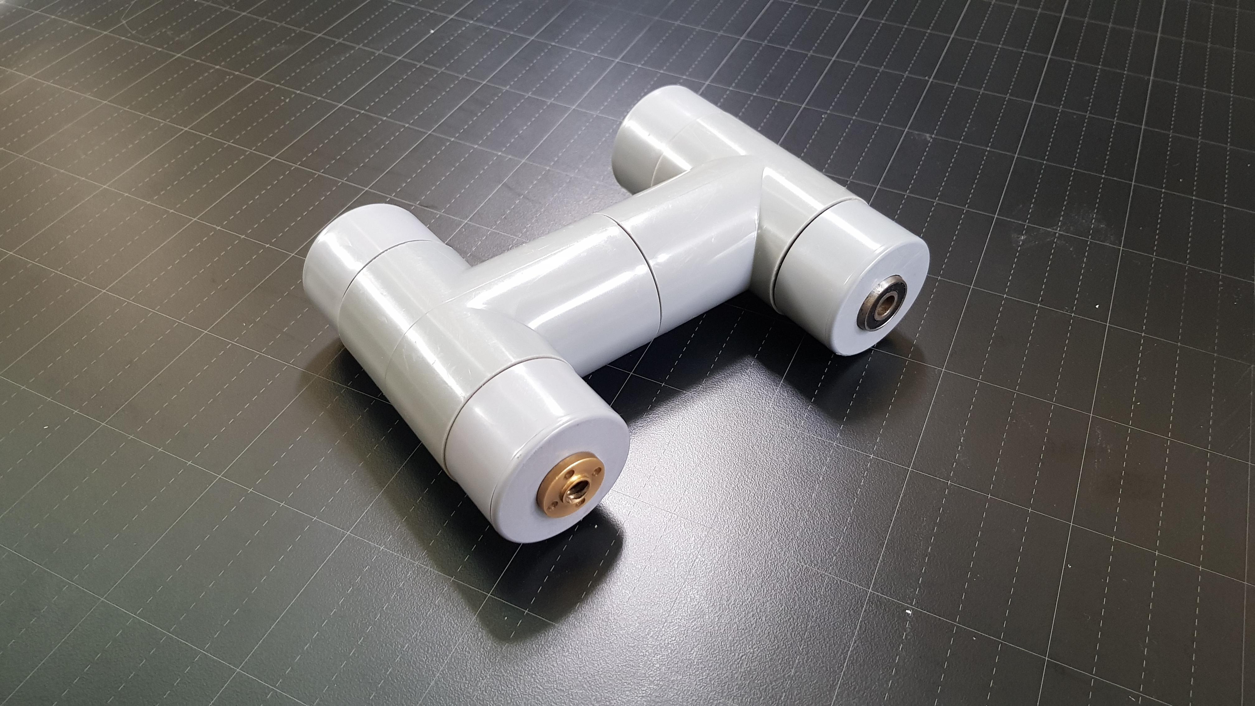

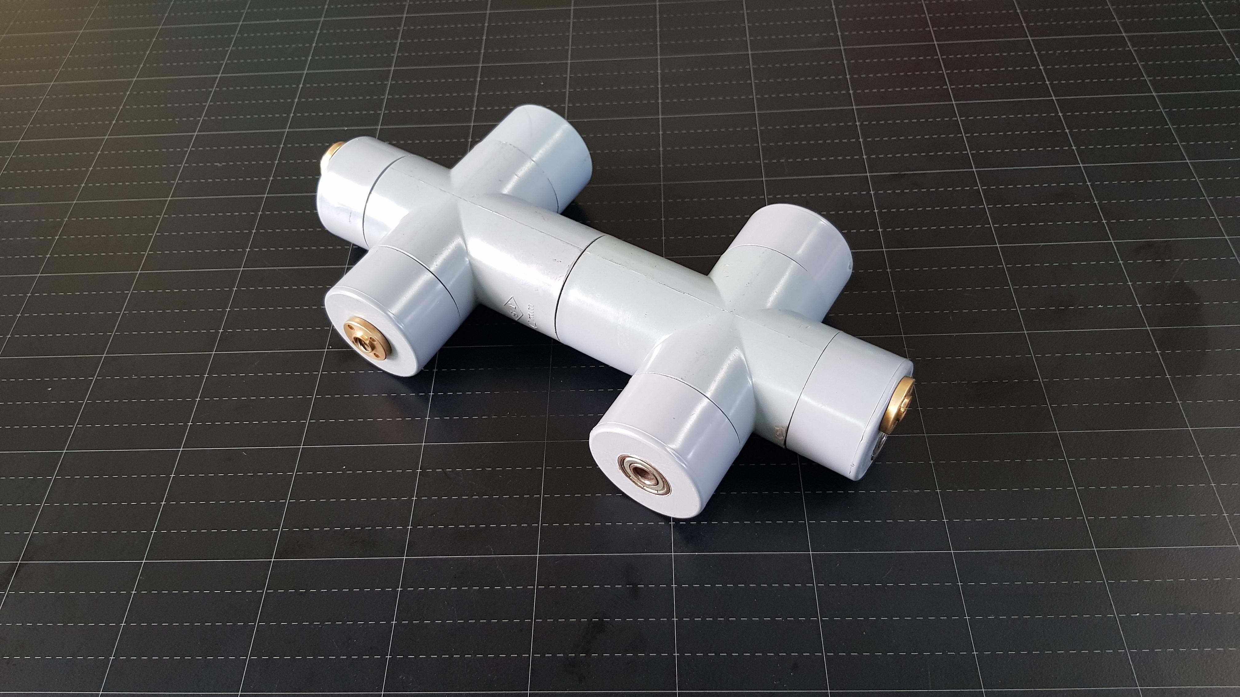

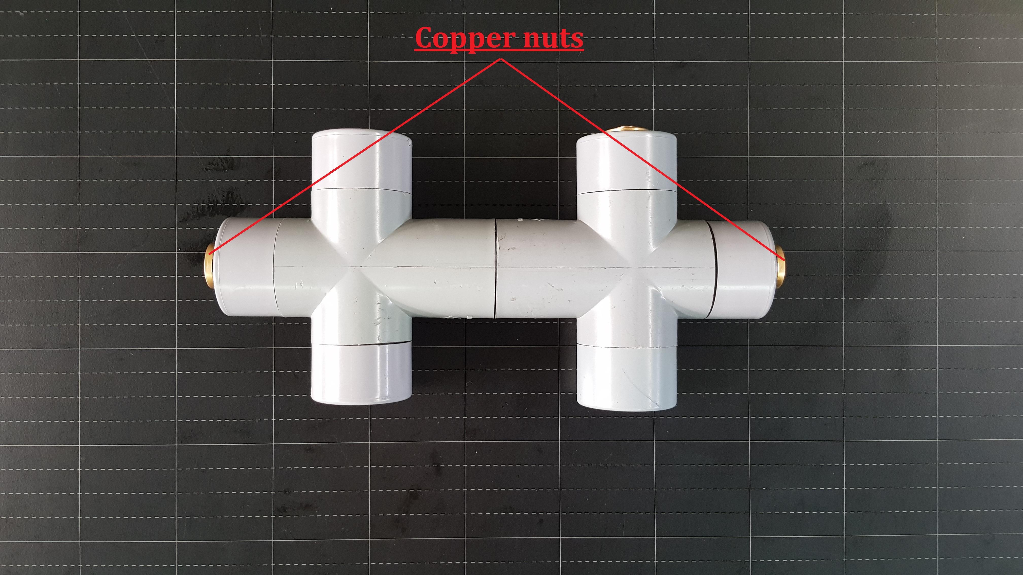

          Step 6: X Axis Assembly Work

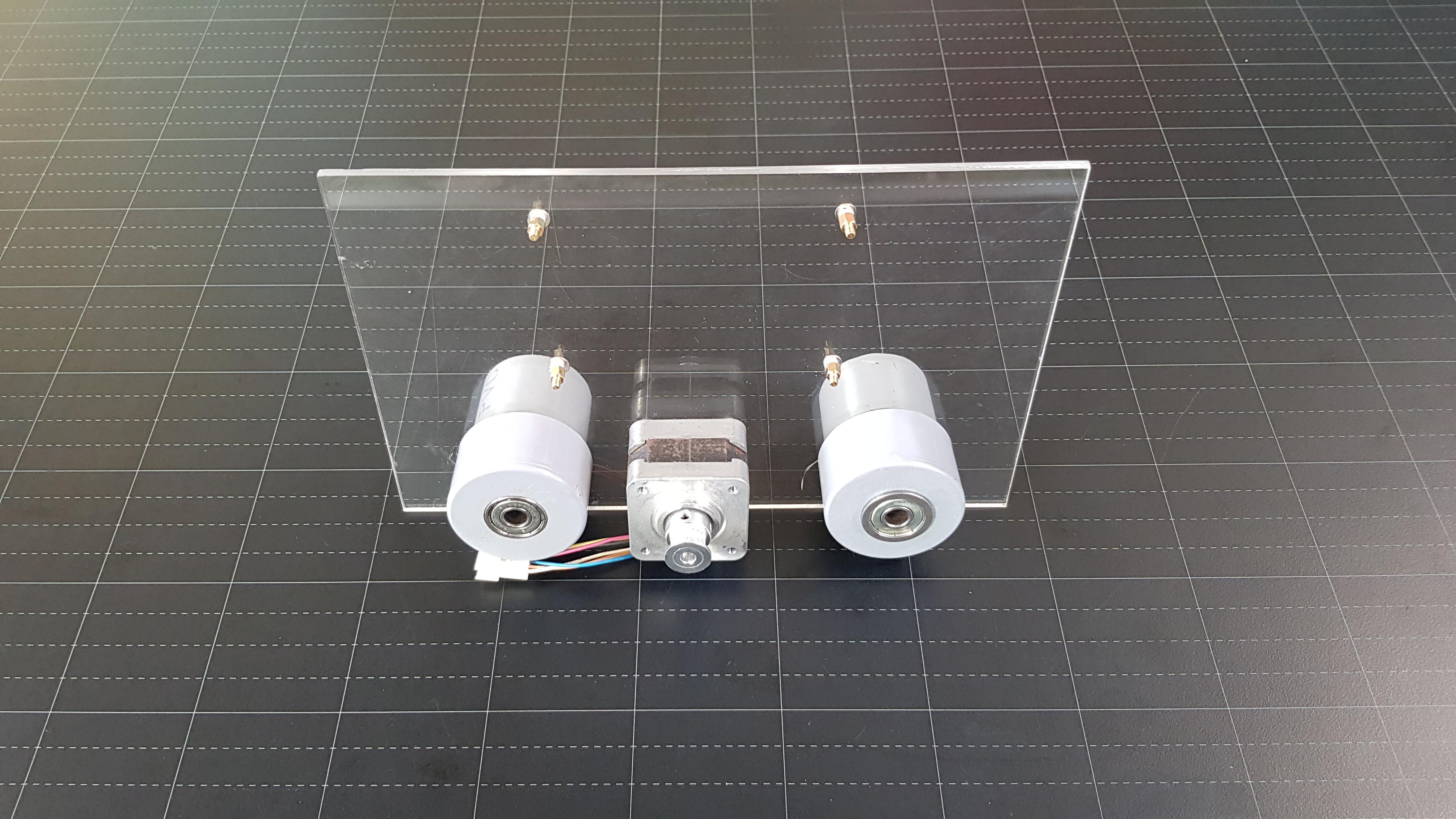

          • X axis was built from 2pcs x PVC crosses. After cutting & connecting 2 crosses together, I installed 6pcs x end caps Ø42mm with bearings & copper nuts at the six ends of PVC crosses.
          • The Z axis will be mounted on this X axis movement base. It carries one stepper motor and its support on top as described in previous step.
          • To prevent it from slipping during operation, I installed 2 copper nuts on the top and bottom end caps.
          • I cut one acrylic plate size 150 x 230mm, drilled 8 small holes for mounting X stepper motor and P-CNC controller. This acrylic plate was then connected on the P-CNC frame by 2 big holes whose diameter is equal outer diameter of pipe Ø42. Based on the 200mm closed timing belt and 60 teeth pulley used, I had to carefully measure the distance from stepper motor shaft to the big hole center before drilling.
          • Threading connecting pipes through these holes and locked them by end caps at stepper motor working side.

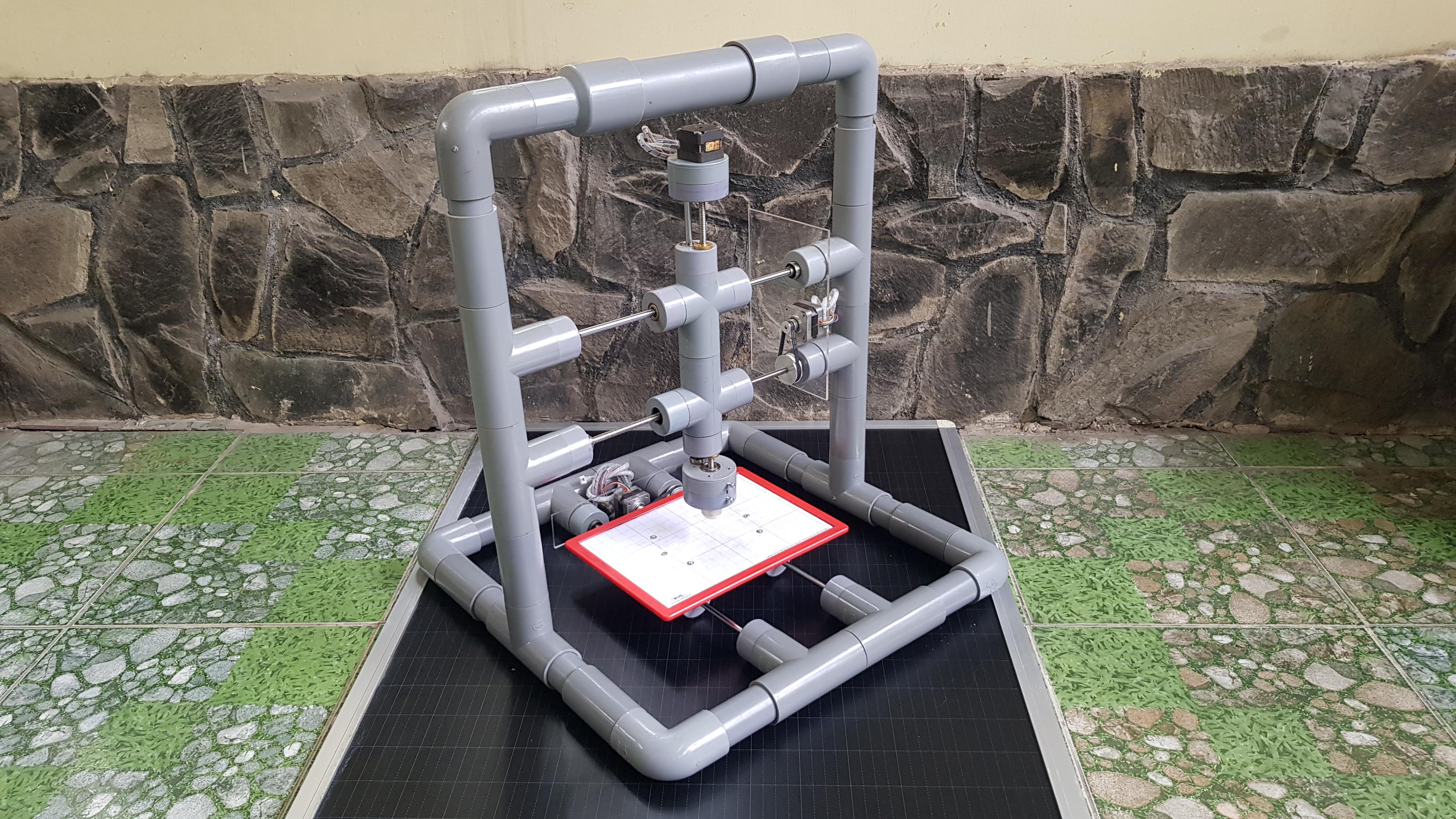

          • Mounting the Z axis to the working base of the X axis.

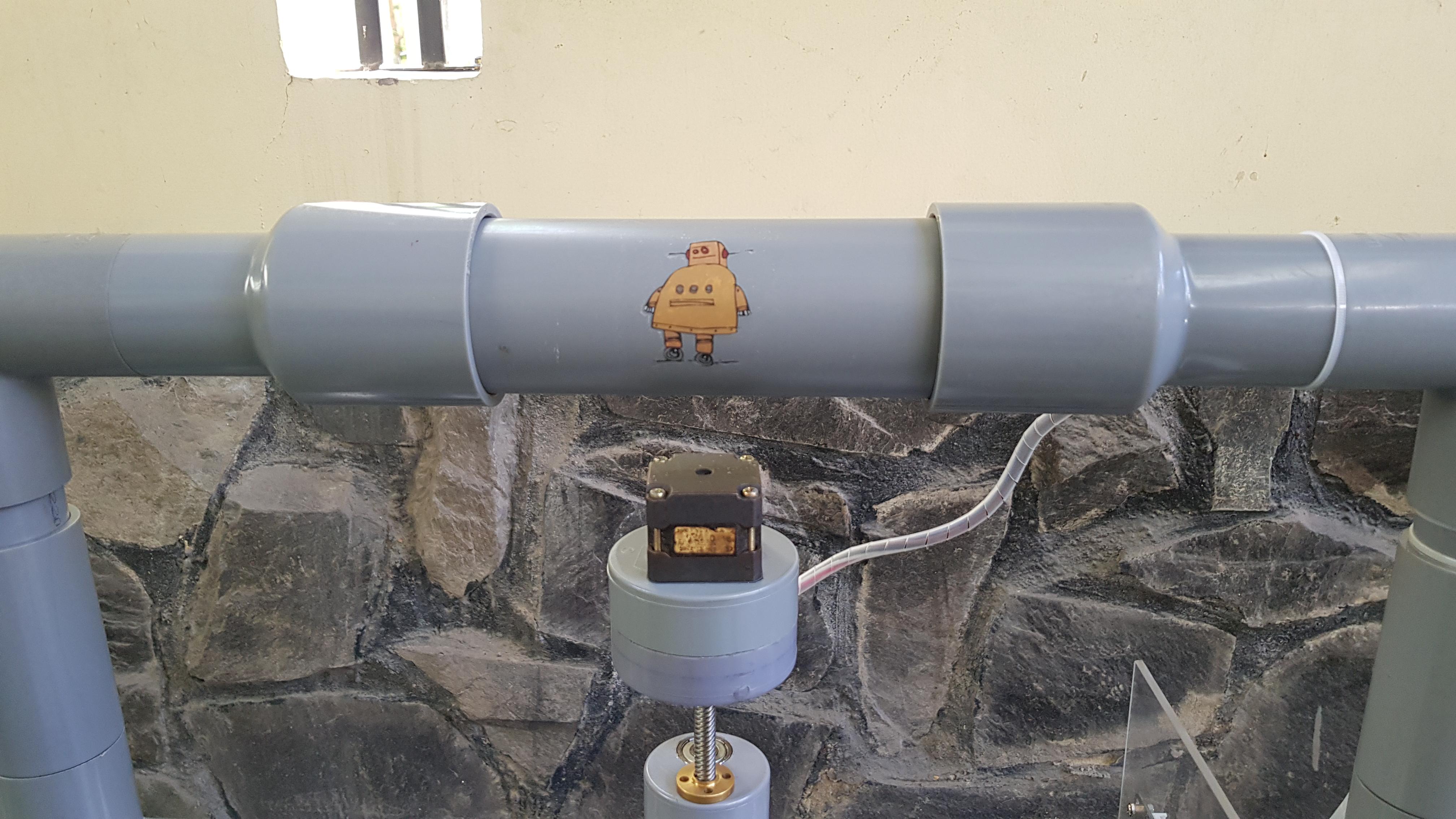

          • Pre-assembling with 20 & 60 teeth pulleys and closed timing belt 200mm and check if it had any mistakes.
          • Mounting X and Z axes on the main P-CNC frame. With a PVC frame arranged symmetrically, it was easy for me to do the alignment and it worked very smoothly by hand.

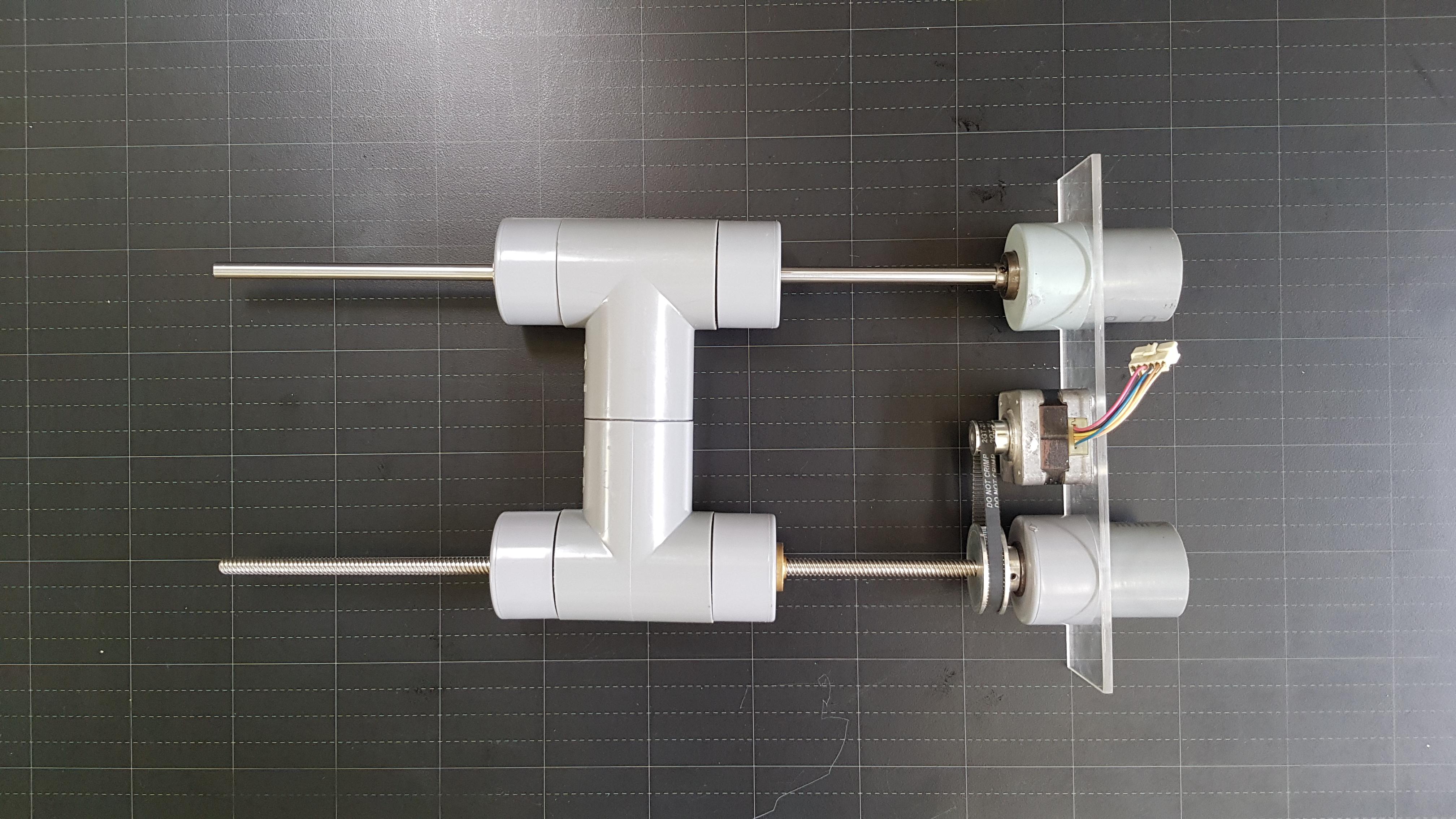

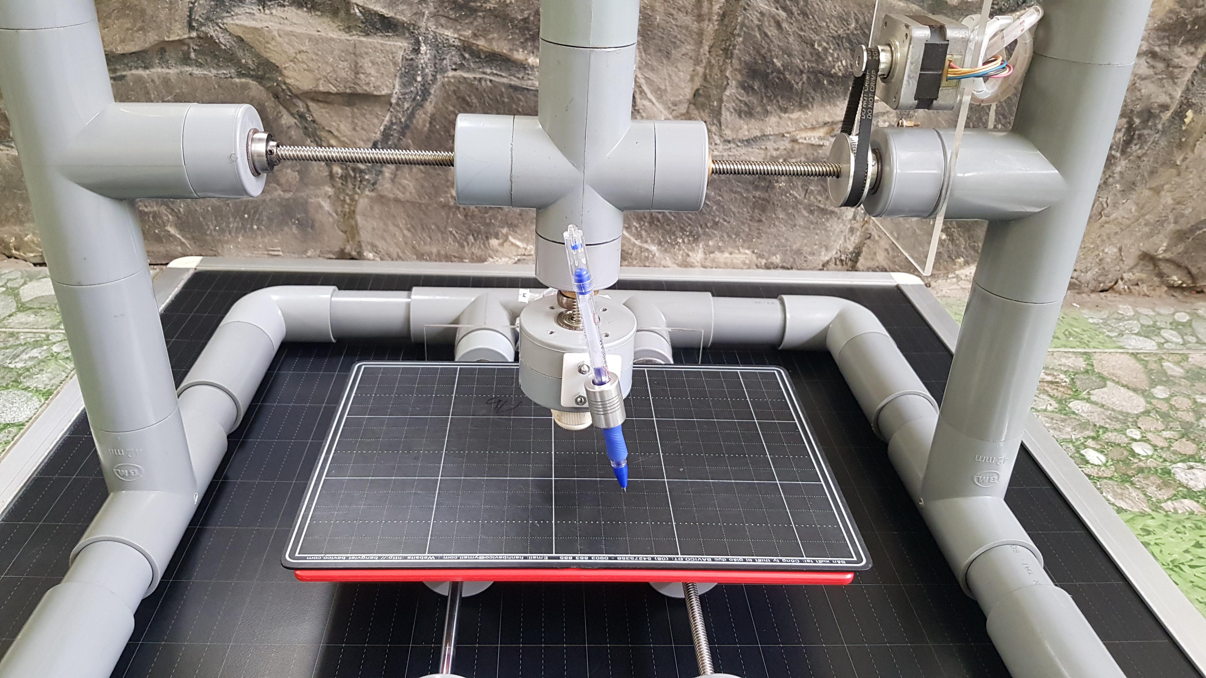

          Step 7: Y Axis Assembly Work
          • Y axis was built from 2pcs x PVC tees which were connected together. I installed 4pcs x end caps Ø42mm with bearings & copper nut at the four ends of PVC tees.
          • As same as X axis, one acrylic plate size 50 x 230mm was drilled 4 small holes for mounting Y stepper motor and 2 big holes for mounting to main frame.
          • Pre-assembling Y axis with 20 & 60 teeth pulleys and closed timing belt 200mm and check if it had any mistakes.
          • Mounting Y axis on the main P-CNC frame.

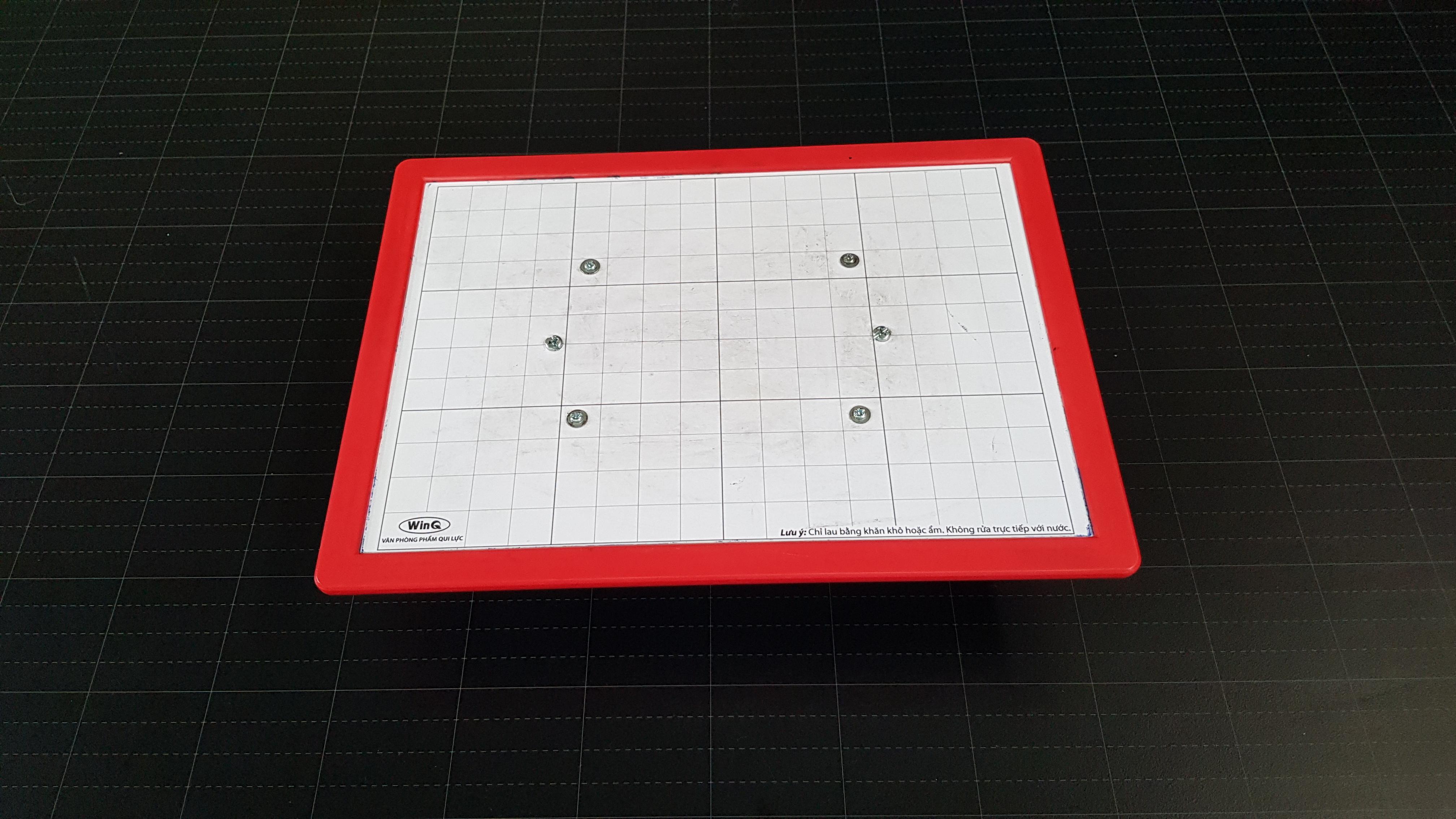

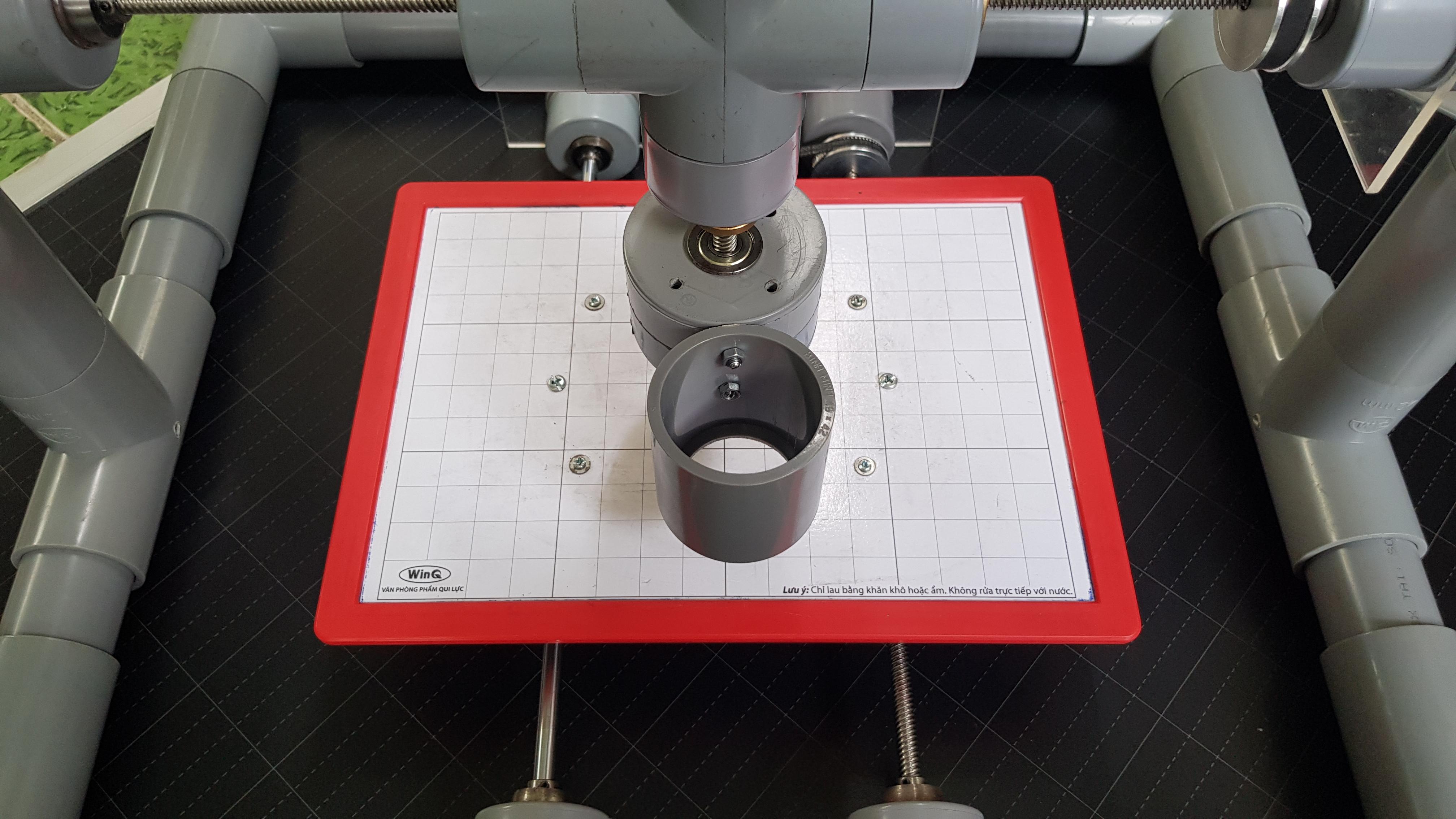

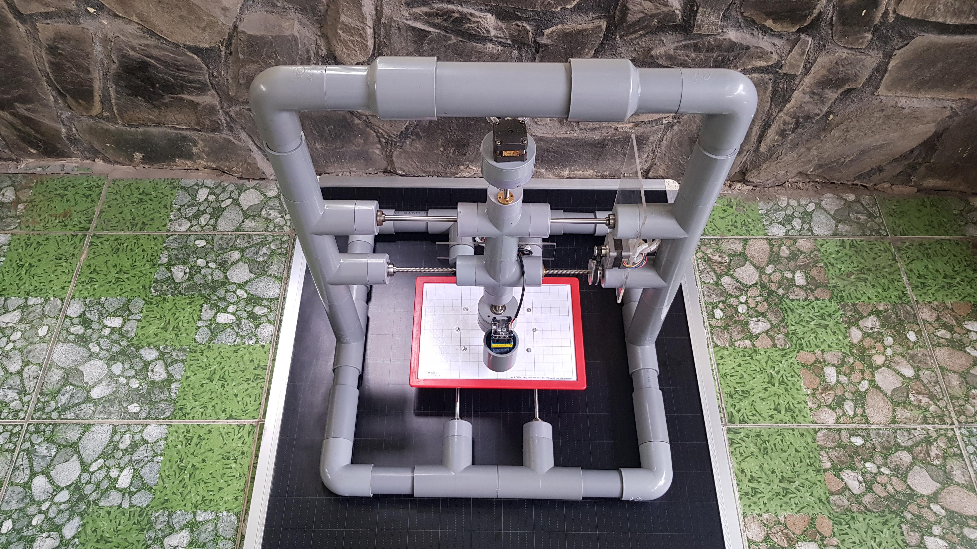

          Step 8: Y Axis Working Platform
          • I reused a black and white board, A4 size for kids as a working platform which had a plastic border at outer edges. Before connecting X axis base to working platform by bolts, I inserted 2pcs x acrylic sheets thickness 5mm to make a gap between working platform and other supports.
          • Because the thickness of outer border is bigger than the black & white board, so all bolt heads will be located lower than the red outer border.
          • Mouting Y axis including working platform to main frame.

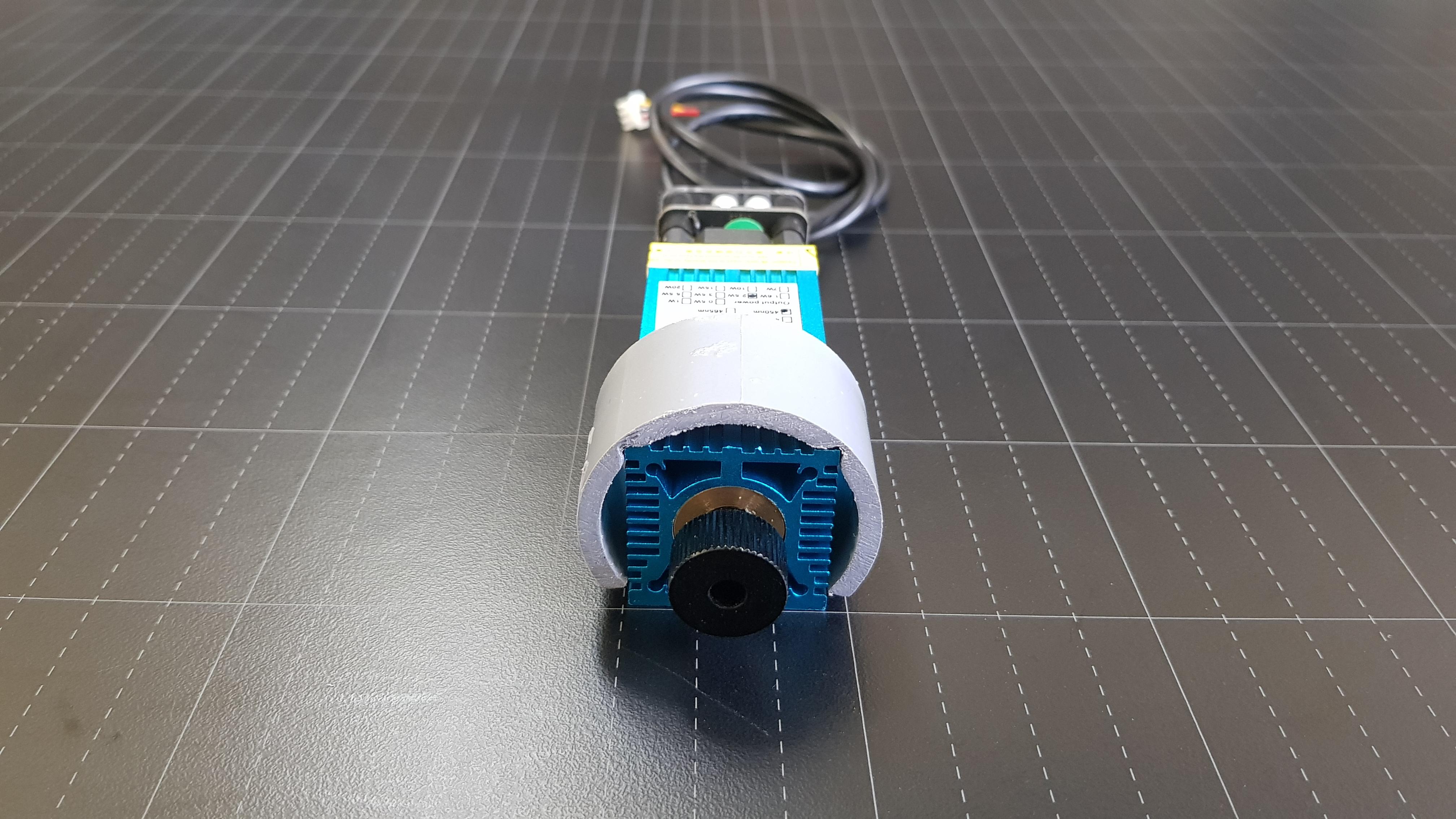

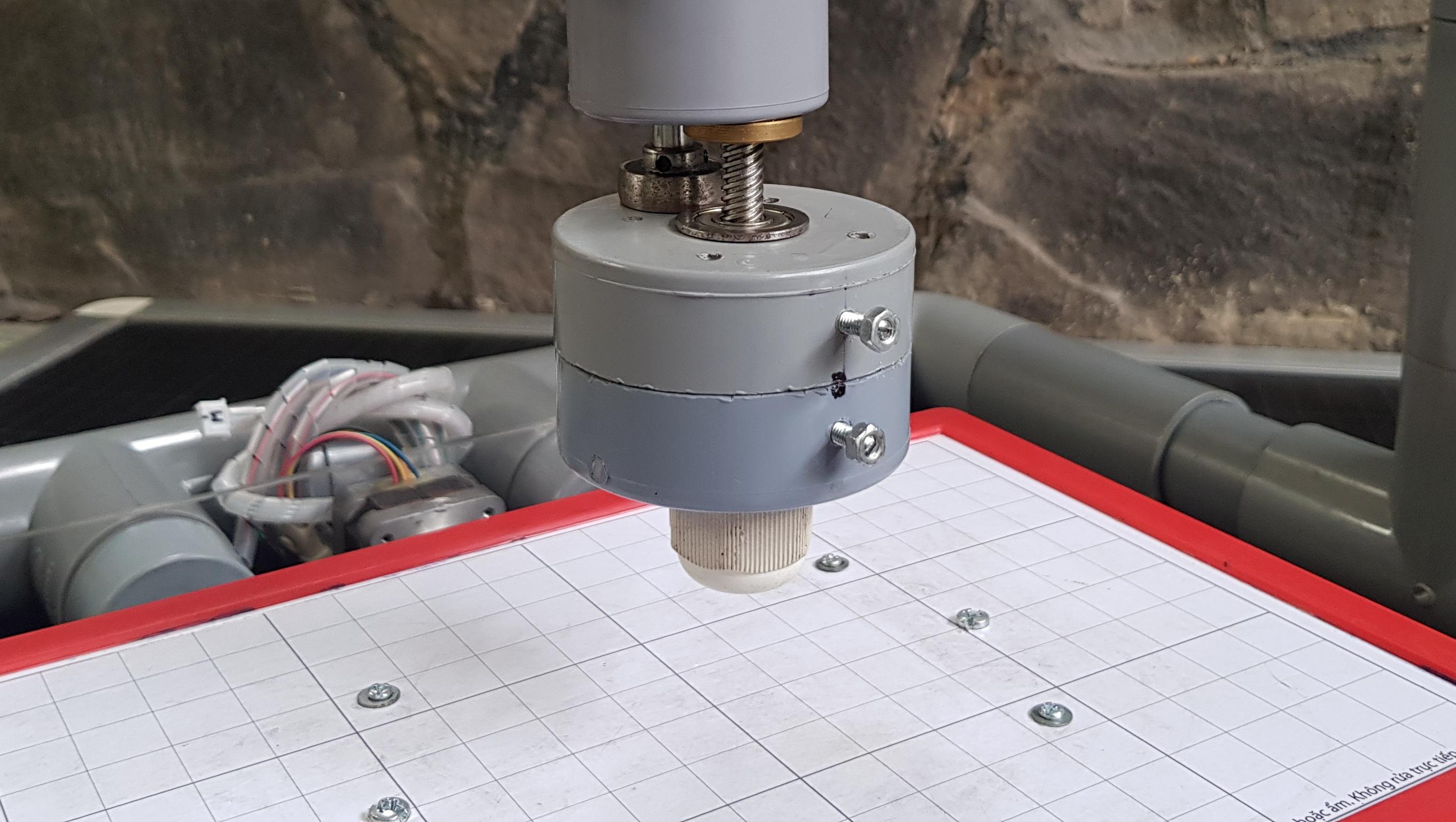

          Step 9: Laser Module Holder

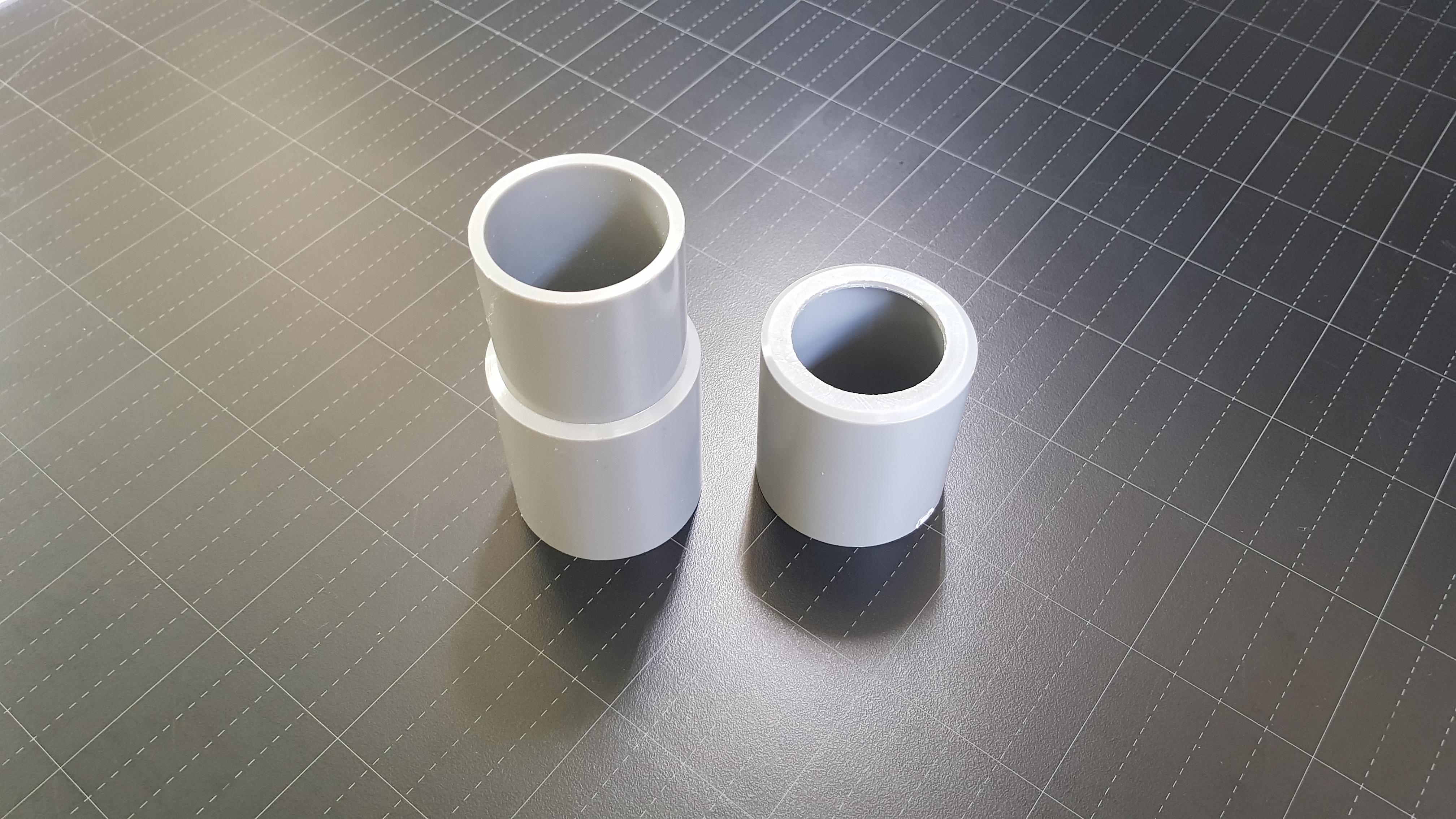

          • Drilling 2 holes and installing 2 bolts on the Z working base. With these 2 bolts, I can easily switch between 2 operating modes: pen plotting or laser engraving mode.
          • Cutting a PVC reducer Ø50mm to Ø42mm at the diameter 42mm side.
          • Measuring the size of laser module then cutting 2 grooves along the pipe 42mm (which had been cut above) following laser module dimension. It looked like this.
          • Checking with laser module.
          • Laser module with 42mm diameter pipe would be inserted and pushed into the 50mm diameter part until the laser head sticked out. In this way, the laser module was fixed firmly and I could easily mount or remove the laser module from the P-CNC chassis.
          • Drilling 2 holes and connecting 50mm diameter support to Z working base by bolts.
          • Inserting the laser module into the 50mm pipe support as described above.

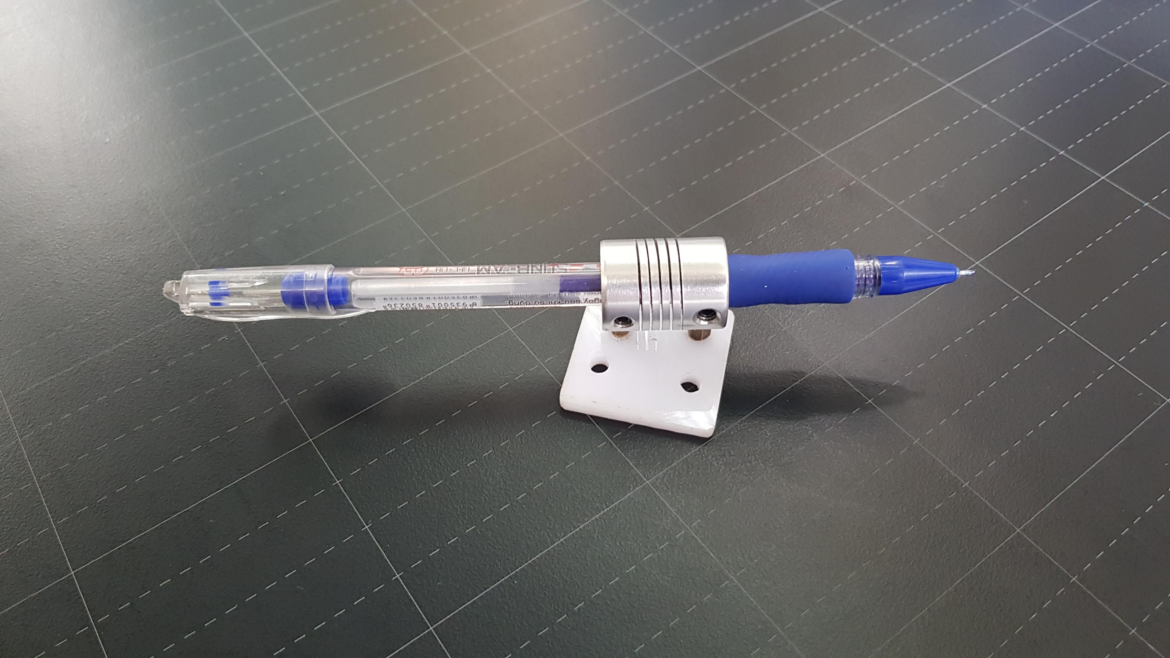

          Step 10: Pen Holder
          • Cutting a small acrylic sheet and drilled 4 holes on it. Two holes were used to mount flexible coupling 10x10 mm for pen clamping and the other two holes were used to connect to the Z working base.
          • Connecting pen holder to Z axis working base.

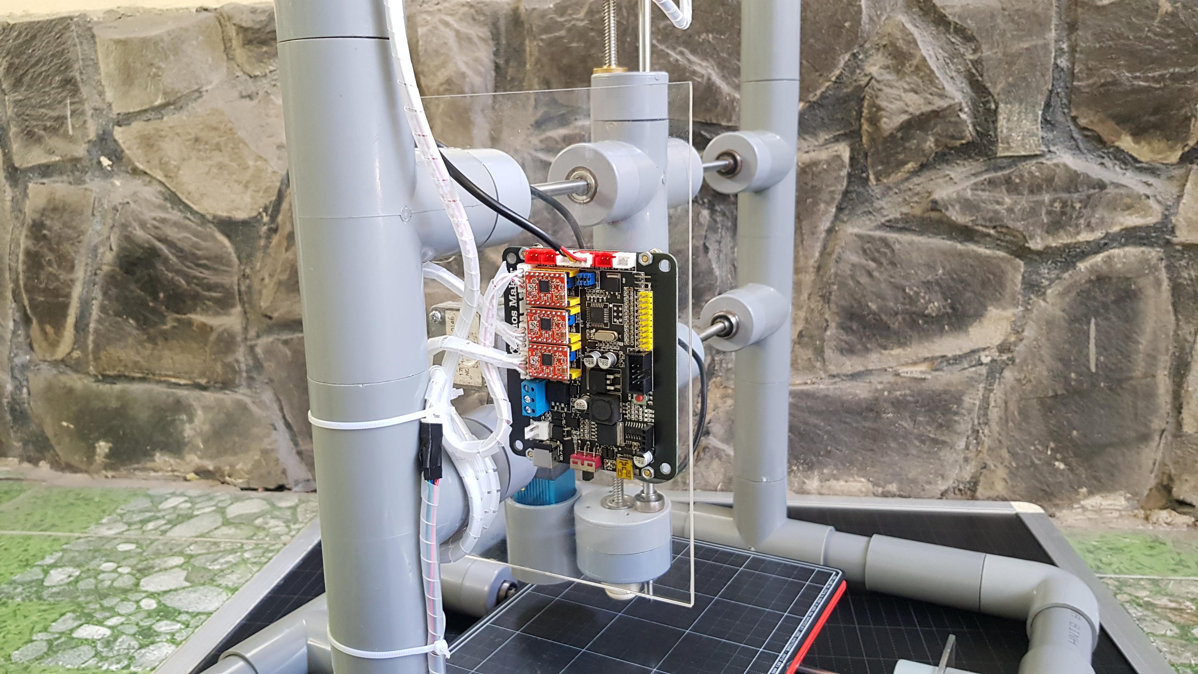

          Step 11: CNC Control Board Mounting and Wiring
        • Mounting CNC control board to X axis acrylic support and connecting all wires to stepper motors and laser module.
          • Etching an Instructables logo on the top of the P-CNC machine.
          • Cable ties, cable spiral wrap were used to fix all wires. For safety reasons, I prepared a paper to test the pen plotting functionality before working with the laser.

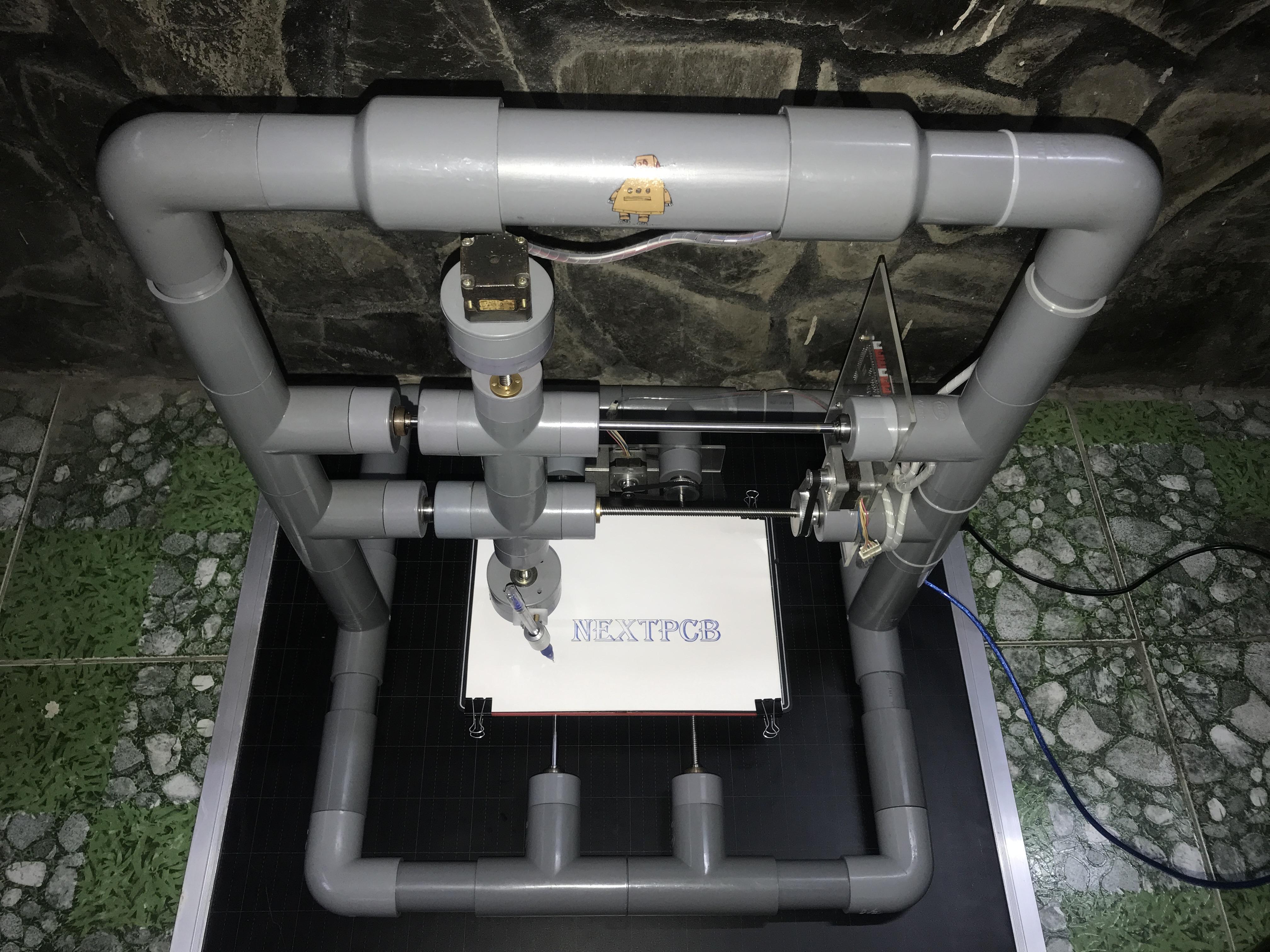

          For pen plotting mode, I used the following softwares:
          • Inkscape and Gcodetools extension: create the G-code files from texts or images.
          • Universal Gcode Platform (UGS): send the G-code file that generated by Inkscape to P-CNC controller and monitor the P-CNC in action on its Visualizer tab.
          For the first testing, I created a G-code file for a text "NEXTPCB" because NEXTPCB has always supported me on my projects.
          Step 14: Pen Plotter Testing
          The pen plotting mode has worked quite well through the images above and in my introduction video.

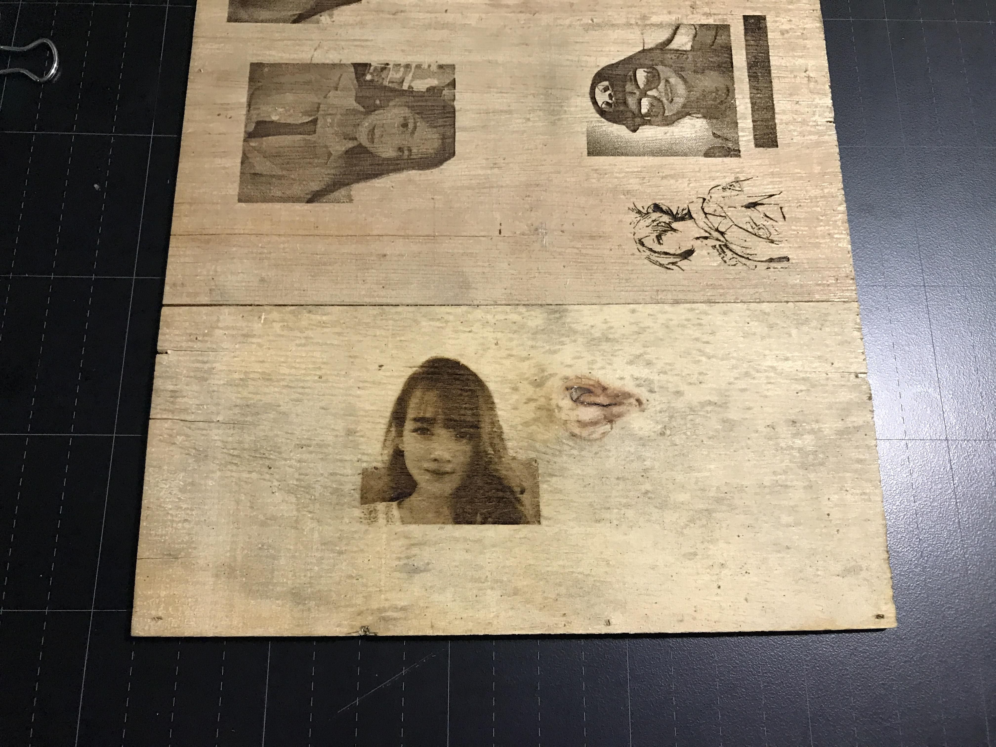

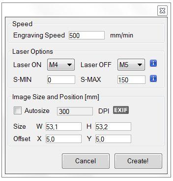

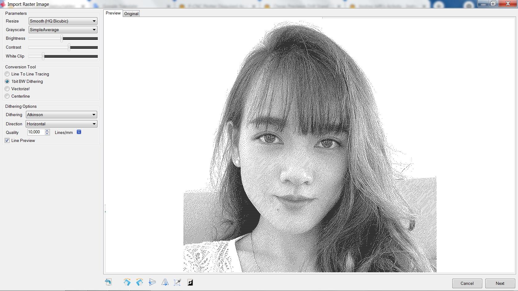

          Step 15: LaserGRBL Software
          To engrave on plywood, I used LaserGRBL software, detail description at: https://lasergrbl.com/. LaserGRBL can load and stream Gcode of images to GRBL based engraver by its internal conversion tool.
          We can enable PWM control to produce grayscale tones if our laser module support TTL control connected to Arduino PIN D11.The plywood composition is not homogeneous so after a few tests I used the “dithering” tool as suggested from LaserGRBL original information and it really worked well to create a nice engraving photo.
          For each specific type of plywood, the laser engraving may be different. I had an A4 size plywood and it is itself divided into 2 parts: one easy to be burnt and the other part not easy to be burnt with the same setup. My setting is as follows:
          • Open a picture with LaserGRBL.
          • Select “1bit BW dithering” tool from conversion tool options.
          • Adjust Brightness, Contrast and White clip by sliders
          • Select Dithering Options from the drop down list. I have tried with below options:
          - Dithering: Atkinsion.
          - Direction: Horizontal.
          - Quality: 10 Lines/mm.
          • Click "Next" then one small window pop up.
          • Enter Enraving Speed, select Laser Options, adjust Image Size and Position on the popped-up window. Here below is my settings:
          • Click "Creat" and it's ready to transfer Gcode to my P-CNC controller.
          Step 16: Laser Engraving Testing
          The results were amazing for me as it was my first time working with a laser engraver.
