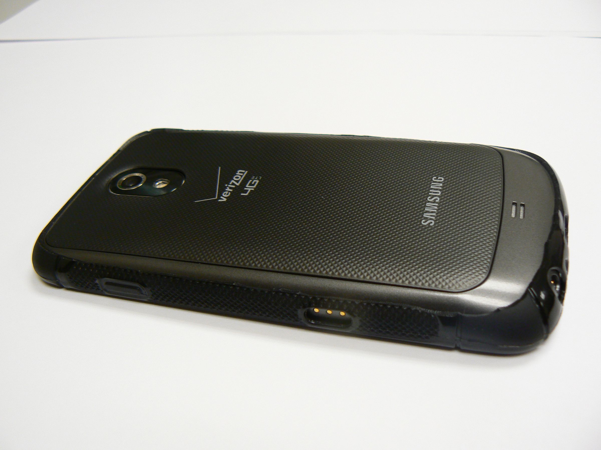

Don't like the USB cable sticking out the back of you PALM Touchstone? Change where the USB cable exits from the back to the bottom! Perfect for Car mounting.
I modified mine because I wanted to make a clean car mount for my new Galaxy Nexus http://goo.gl/CkJMn
iFixit has a tear down that does not include full disassembly instructions, so I've included more comprehensive step-by-steps here.
