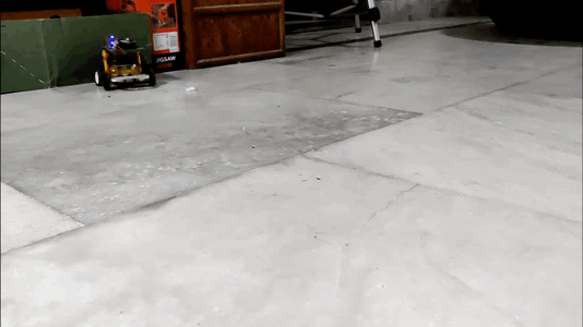

As you can see, our robot is working! and it's pretty fast which was my goal, to make it as fast and sturdy as possible.

This version is definitely not the final iteration as I still have to improve a lot of things in this bot.
  • first would be the overall stability and alignment of motors, as you could see in the attached gifs, this robot is unable to take a straight path, this is because of misalignment of motor position.
  • The solution here is to remake the base of this project with a better motor mounting solution.
