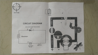

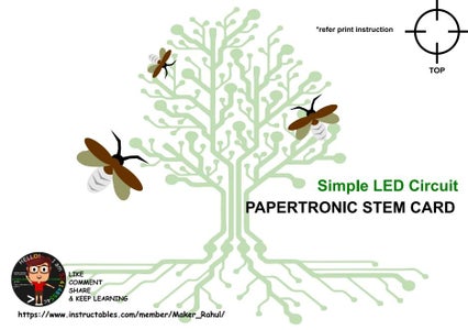

This is Design I made using "Inkscape" - Opensource Vector Designing Software
But don't bother if you never have used this software.
Final Design is in PDF file that is attached here...

According to my design you have to take single-sided print of first page which have bugs clipart and double-sided print of remining two. Here you have to take care of Top and Bottom alignment. I made marking to help but if still difficult then take each print on separate page and later stick last page up and down together.
Fold it so it looks like some greeting or wish card.

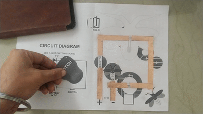

as seen on image, stick conductive tape on valid given path!
only make sure to overlay tape on joints properly.
using multimeter check the connection continuity.

How to make paper switch? is very important part of this activity.
just follow what I did on image... that's all
finally, I glued switch on its proper place on box.
