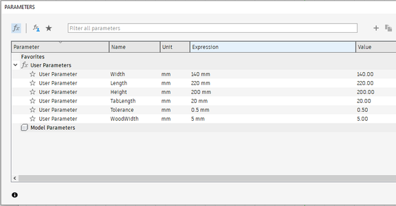

Step 2: Defining Parameters

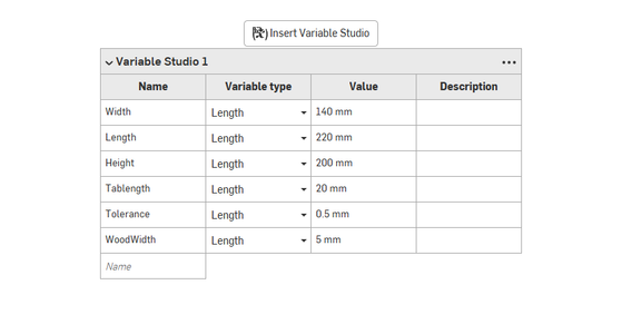

This is a crucial step of parametric design. Basically you need to decide which values can be modified after designing.
In this case, LENGTH, WIDTH, and HEIGHT, are the obvious ones, as they most directly contribute to the look of the treehouse and the amount of material used. However there are some more important factors as well, such as the width of the material, and tolerance to make sure the tabs fit together with no issue.
The process for creating parameters varies from CAD software (In Fusion find the User Parameters section), however the main principles will be consistent.

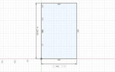

Step 3: Sketch the Base
Next we need to create the base for the birdhouse. However we must use the WIDTH and LENGTH values defined in the previous step.
Instead of typing the value directly into the dimension field, enter the parameter name to ensure it can change afterwards.
From this point on, try to base all dimensions off of the parameters you've already listed, as this will ideally result in the least amount of issues as values change.

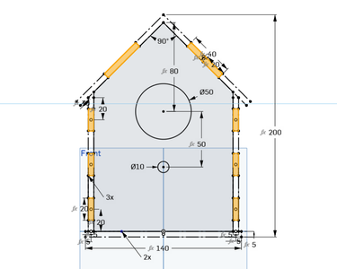

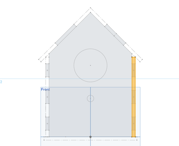

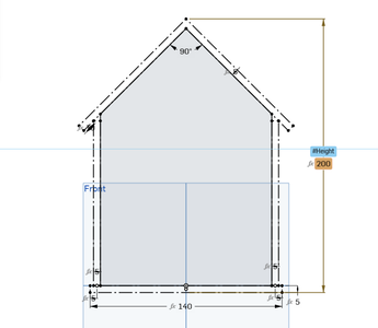

Step 6: Sketch Front Profile
In a new sketch, you can create the general profile of the birdhouse, referencing the width of the base, and keeping a few critical things in mind.
Define the height of the birdhouse using your HEIGHT parameter.
Ensure you include the walls (Of course using the WOODWIDTH parameter)
Add the roof boards, also using the WOODWIDTH variable, and keeping their angle and 90 degrees.
Include a hole for an entrance and one for a wooden dowel. (These do not HAVE to be constrained to parameters)
Step 7: Create Front and Back
Next create tabs using TABLENGTH once again, using a linear pattern to create 3 on each side.
Create two tabs on top for the roof boards, these are dimensioned as TABLENGTH * 2
Finally extrude a board with both holes and one without.

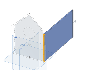

Step 8: Create Sides
Create another sketch on top of the front profile outlining the area of the wall. Then extrude this area to LENGTH.
Again, create a sketch, this time on the wall profile to create slots to interface with the tabs on the front and back boards. (Remember to add TOLERANCE).
Don't forget to add tabs on the bottom to interface with the slots on the base.
You only need to do this for one side as they are identical.

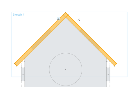

Step 9: Create Roof Boards
Similarly to the walls, create a sketch on the front profile and extrude each side of the roof boards.
Then create the slots for the modified tabs on top of the front and back boards (These should be located vertically in the middle of the roof boards).
Finally create a large tab on one of the boards that interlocks with the adjacent one.

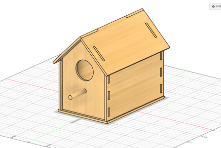

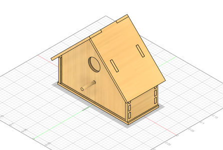

Step 10: Import All Parts and Assemble
You have completed the majority of the parts required, however the assembly also requires technique and precision.
After gathering all the parts needed, you must create joints from the center of the tabs to the center of the slots (As shown in picture 2). This ensures there is even tolerance on all sides and everything lines up perfectly.
After everything is assembled, it finally resembles a full birdhouse, however there is still one thing missing.
Step 11: Final Touches
The wooden dowel is the only part of the project that is not designed to be laser cut. However it is a very simple part and is only a simple extrude.
And after adding it to the house, the project is complete.

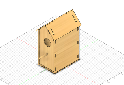

After importing each house into one design, use the "Render" section from the dropdown to create a realistic visualization of each birdhouse.
After adjusting lighting and composition, press the teapot button to render the final image.
