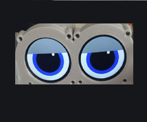

In addition to the code shared in Part 1, I will be providing a new example.
I will try to convert it to c array and display selected part to two screens with import command.
In this demonstration, I will be exploring a less common approach by sharing a code example that extracts specific sections from a bitmap C array containing various pairs of eye shapes and displays them on two GC9A01 screens. My goal is to show that, although this method is not widely preferred, it is entirely feasible and worth experimenting with.
Sample code below as demo for first row only.
