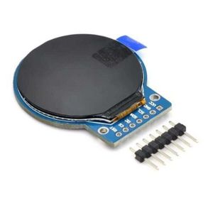

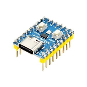

To draw an eye shape using the Arduino_GFX_Library, follow these steps:
  1. Install the Ardunio_GFX_Library

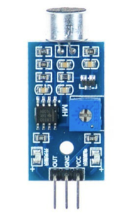

  2. Set up the hardware, including connecting an two GC9A01and sound sensor
Step 1:
Complete the connections. Install the library.
The code creates an eye drawing using given angle and color variables and includes functionality to stop the drawing when a signal is received from a sound sensor. This integration of the sound sensor with the Arduino_GFX_Library allows for interactive control, ensuring that the eye drawing pauses or stops based on auditory input.
