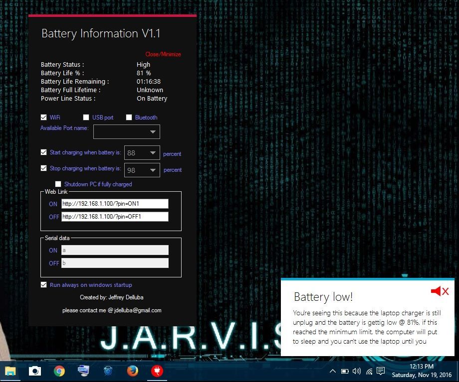

Step 5: Computer App
Computer app was written in Visual Studio 2013 (Download link) under framework 4.0, your system should have this in order to run the app if you don't have you may find it here Microsoft download.
If you want to create your own this will help Interfacing your arduino with a C# program
