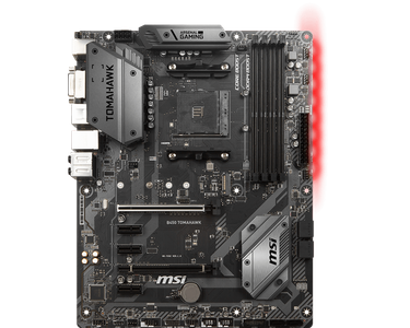

  1. Motherboard (MSI B450 TOMAHAWK ATX AM4)

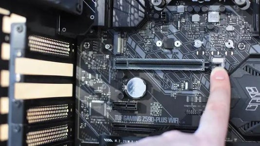

Step 4: Install the M.2 SSD
Keep in mind some motherboards may come with a heatsink for your M.2 drive, in which case you will locate and unscrew the heatsink on to be able to install your ssd. In my case, I had to purchase a M.2 with a heatsink on it. Make sure to read and check your motherboard to see if there are any slots and heatsinks for you to use.
  1. Locate the M.2 Slot on the MOBO (Motherboard)
  2. Slide the M.2 drive into the slot at a slight angle (Around 30 degrees).
  3. Gently press it down flat and secure it with the provided screw.
  4. In some cases there will be pieces that simply require you rotating to secure the M.2.

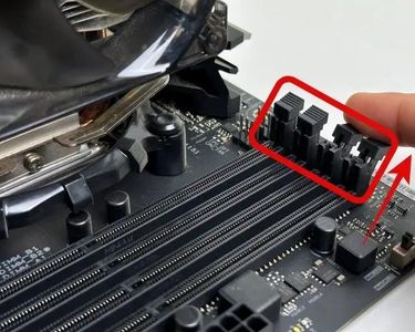

Step 5: Install Ram
  1. Open the clips on the side on the RAM slots.
  2. Align the notch on your RAM stick with the slot.
  3. Firmly press the RAM into place until you hear a click and the clips snap shut.
  4. Make sure you are lining it up correctly, it should be firm but not hard to insert. Doing this incorrectly could damage your RAM and/or slots.

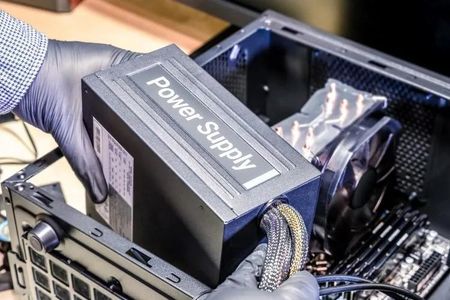

Step 7: Install the Power Supply (PSU) & Connect Cables
  1. Place the PSU into its slot, typically found at the bottom rear.
  2. Secure it in place with the appropriate screws.
  3. Move cables to the back side of the PC case for cleaner cable management.
  4. Plug the 24-pin ATX power cable into the MOBO
  5. Connect the 8-pin CPU power cables near the top of the board
Step 8: Installing the GPU
  1. Check which GPU slot you will use and remove the appropriate expansion slot cover from the rear end of the case. Some motherboards may only have one slot, and in my case we will be using the top slot.
  2. Insert your GPU (AMD in my case) into the top PCIe x16 slot on the motherboard, be careful but firm while inserting.
  3. Secure it in place with screws in the rear expansion slot.
  4. Plug in the PCIe Power cables from the PSU to the GPU.

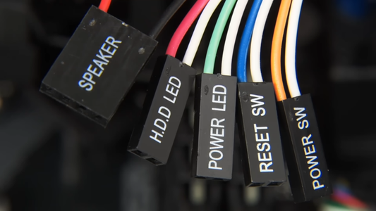

Step 9: Connecting Front Panel and Case Fans
  1. Read your motherboard's manual to know where to connect your front panel pins to. Plug in the front panel conenctions (power switch, reset, LEDs if any) according to your MOBO manual.
  2. Connect the USB, HD Audio, and Case Fans to their respective headers on the MOBO.

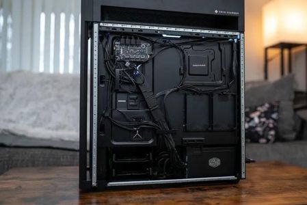

Step 10: Cable Management
  1. After routing all cables towards the back of your case, you can use zip ties or Velcro straps to neatly organize and group cables.
  2. Make sure airflow is not blocked by any loose wires, as it could effect performance.
