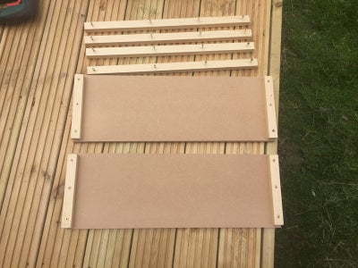

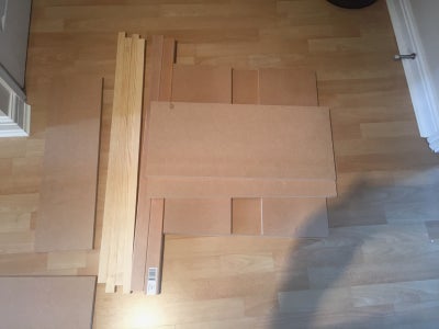

The basic pieces were cut and wooden battons screwed into place.
Once complete, four of the sides were screwed together.
The rear panel was cut further to provide an access port to store the powerstrip, cables and a router.

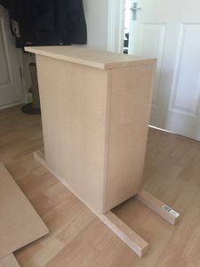

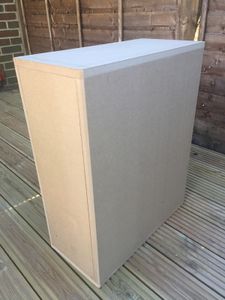

The top and bottom panels were then cut (oversized), screwed into place and a flush trim router bit used to line everything up.
The basic box section was now complete.

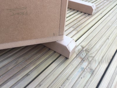

Hardwood was used for the legs. These were shaped and were to be sanded and rouned at the edges later.

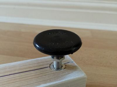

Holes were drilled into the bottom of the legs and threaded inserts screwed into place which were to hold the self levelling feet.

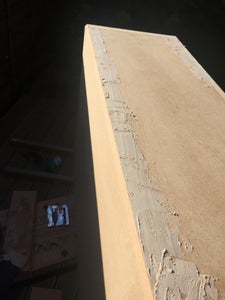

The rough MDF edges were filled with car body filler and sanded down until smooth.
After a few passes to make sure there were no lumps and bumps, blackboard vinyl was applied around the 4 vertical surfaces.

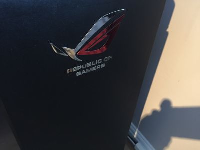

A Metal ROG sticker was then applied to the front of the unit.

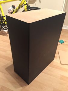

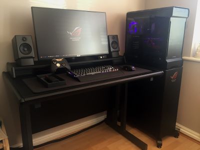

Step 4: Complete Project
Once the legs were filled, sanded and painted, They were bolted onto the underside of the stand.
Finally, the unit was placed next to my desk and the PC moved into position.
I'm happy with the outcome; it's fairly understated and serves the purpose for which it was built.
