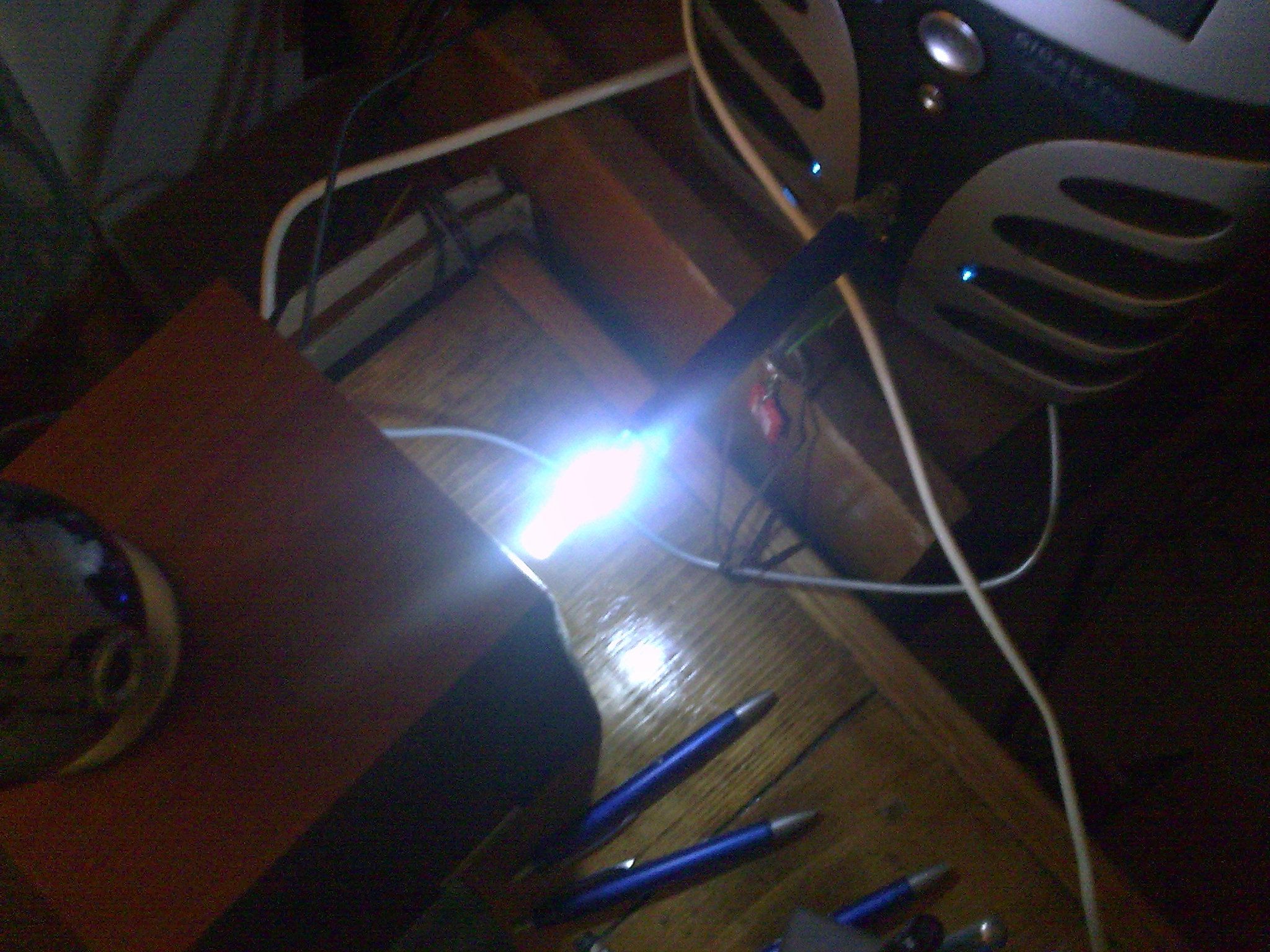

The problem with those is that I discovered in time that they really bother me during night because of their excessive brightness. So I ripped the wires off, returned back to the good ol' red HDD activity LED, and installed 2 high brightness LEDs inside the case. I left the old LEDs in place just for the looks.
I connected them in parallel with a 56 ohm resistor for each LED, and mounted them on 2 small PCBs which I glued to the interior of the front panel. They are connected with a molex connector to the 5V line of the PSU.
