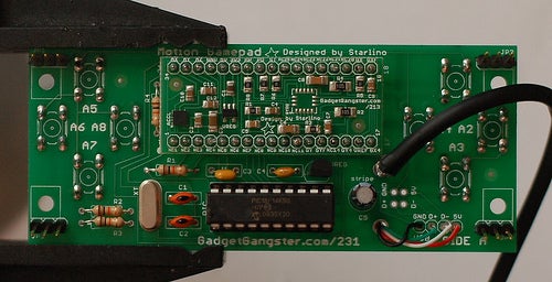

Introduction: PC Motion Gamepad
Play your favorite PC, Mac, or Linux games just by tilting! The Motion Gamepad translates your movements into in-game actions, like turning a steering wheel or throwing a ball. An advanced interface makes it easy to customize, and a 3-Axis, 2kHz accelerometer gives you super smooth and accurate control.

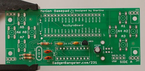

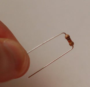

There are 4 resistors in the project, they're all identical (10k ohm - Brown - Black - Orange) and they go on the board at R1, R2, R3, and R4.
Bend the leads at a 90 degree angle, and insert them in the board. Flip over the board, solder them down, and trim off the excess leads.

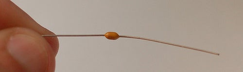

Let's add the capacitors.
The Orange disc shaped caps should have an '18' marked on them. Those caps go at C1 and C2. These caps are not polarity sensitive, so it doesn't matter which way you insert them.
There's a .1uF axial ceramic capacitor, it goes at C4. Axial means the wires come out the ends - like a resistor. You might be able to see the marking on the body of this one - it's '104'. It is also not polarity sensitive.
C3 is the last ceramic capacitor. it's .47uF, you can verify you've got the right one by checking the marking on the body, it should have the number '474'. It's also not polarity sensitive.
Now for the final capacitor, it's an electrolytic capacitor and it goes in C5. The value is 10uF, and it is polarized. The stripe on the body of the component should go closer to the word 'stripe' on the circuit board.

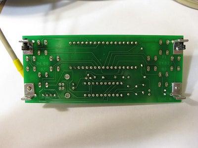

The most common way of adding the buttons is directly on the board. To do this, just flip the pcb over and snap them in. Flip the board back and solder them down.
If you want to install the buttons somewhere else (like on the top of a steering wheel), use a bit of hookup wire to connect the button to the hole it would normally go in.

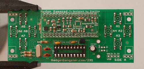

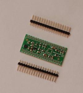

The accelerometer is on a separate breakout board (the Acc_Gyro Board, Accelerometer Only) because accelerometers only come in surface mount packages and are pretty difficult to solder by hand, so this part comes pre-assembled. All you have to do is add pin headers.
To Socket or Not To Socket
The kit also comes with pin sockets - you can add pin sockets to the Motion Gamepad PCB at the area labeled 'AccGyro' and slide the Acc_Gyro Board into the socket. The advantage of using sockets is that you'll be able to remove the Acc_Gyro Board and use it for other projects.
Personally, I found it easier to forgo using sockets. I just soldered the pin headers straight to the board and cut off the extra length of pin headers on the other side. I won't be able to re-use the accelerometer on other projects, though.

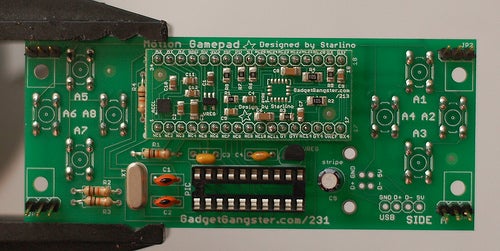

Step 8: Make: Step V
Add 3 pin headers at each corner of the board (JP1, JP2, JP3, and JP4). When you solder them down, it's best to 'splay' them apart (see 2nd photo). These headers will hold the PCB to the Wii wheel. You can also use pliers (or dikes) to bend them out further.

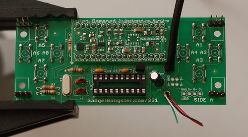

Almost finished! Let's add the USB Cable;
Trim off the outer rubber jacket and excess shielding from the USB Cable. You'll see 4 wires inside the cable. You'll want to expose about 6" of those wires - strip the conductor and tin the leads of each.
Run them in the top hole and back through the bottom hole, as shown in the image. Once they're through, you'll connect each wire to the board;
Black: GND
Green: D+
White: D-
Red: 5V
Lastly, put the PIC in the socket - note the notch points to the left.

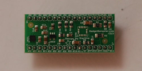

Step 11: The Acc_Gyro Board
The Acc_Gyro Board is a core part of the Motion Gamepad and contains the Accelerometer that reads movement. It's socketed, so if you're into programming microcontrollers like Arduino or Propeller, you can use it in your own projects.
An enhanced version of the Acc_Gyro is available separately - it adds a Gyroscope to give a 5DOF Inertial Measurement Unit (IMU) with 5V and 3V capability. There's a ton more info on using the Acc_Gyro here. Full pinout information is available in PDF format, but to summarize:

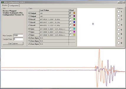

Using the Accelerometer
The accelerometer measures acceleration around several axis. If you set the Acc_Gyro board on the table as shown in the photo above, the Z axis will experience 1G and AZ will output 1.17V. The X and Y axis' don't have gravity pulling on them, they're at 0G, and will output 1.65V.
If you put it on the table upside down, the X and Y axis' would still have 0G of acceleration, so you'd get AX = 1.65V, AY = 1.65V, and AZ = 2.13V. The Acc_Gyro board is capable of measuring accelerations of +/-2G (+/-19.6m/s^2) along any axis. 2G is the same as going from 0 to 44mph in 1 second. When an axis experiences +2G, it will increase voltage to 2.6V. When it experiences -2G, it will decrease voltage to .7V.
Please note that gravitation force (directed from sky to ground) has same effect on the device as if you would accelerate the device in an opposite direction, in a place with no gravitation field. So keep this in mind if you're planing to use the device for something like measuring the acceleration of your car or bike.

Design
Here's the board layout and schematic (eagle format)
